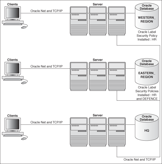

Figure 11-1 illustrates a distributed database that includes clients and servers with and without Oracle Label Security. As described in this chapter, if you establish database links from the WESTERN_REGION database to the EASTERN_REGION database, then you can access data if your user ID on EASTERN_REGION is authorized to see it, even if locally (on WESTERN_REGION) you do not have this access.
Figure 11-1 Using Oracle Label Security with a Distributed Database
Distributed databases act in the standard way with Oracle Label Security: the local user ends up connected as a particular remote user.
Oracle Label Security protects the labeled data, whether you connect locally or remotely. If the remote user has the proper labels, then you can access the data. If not, then you cannot access the data.

Oracle Label Security supports all standard Oracle Database distributed configurations.
Whether or not you can access protected data depends on the policies installed in each distributed database.
Be sure to take into account the relationships between databases in a distributed environment:
If the same application runs on two databases and you want them to have the same protection, then you must apply the same Oracle Label Security policy to both the local and the remote databases.
If the local and remote databases have a policy in common, then your local session label and row label will override the default labels for the remote user.
If the remote database has a different policy than the local database, then the remote policy can restrict access to the data independent of your local policies. On the other hand, when you make a connection as a remote user who has authorization on the remote policy, you can access any data to which the remote user has access to, regardless of your local authorizations.
If the remote database has no policy applied to it, you can access its data just as you would with a standard distributed database.
Consider a situation in which three databases exist, with different Oracle Label Security policies in force:
Users authorized for Policy A can obtain protected data from Database 1 and Database 2. If the remote user is authorized for Policy C, then this user can obtain data from Database 3 as well.
