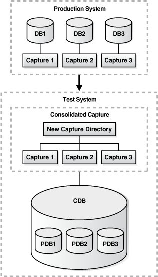

For Consolidated Database Replay, all participating workload captures must be placed under a new capture directory on the test system. You can copy all the workload captures into the new capture directory, or create symbolic links pointing to the original workload captures. Before consolidating the workload captures, ensure that the new capture directory has enough disk space to store all participating captures.
Figure 15-1 illustrates how to set up the test system and new capture directory to consolidate three workload captures.
Figure 15-1 Setting Up the Test System for Consolidated Database Replay
