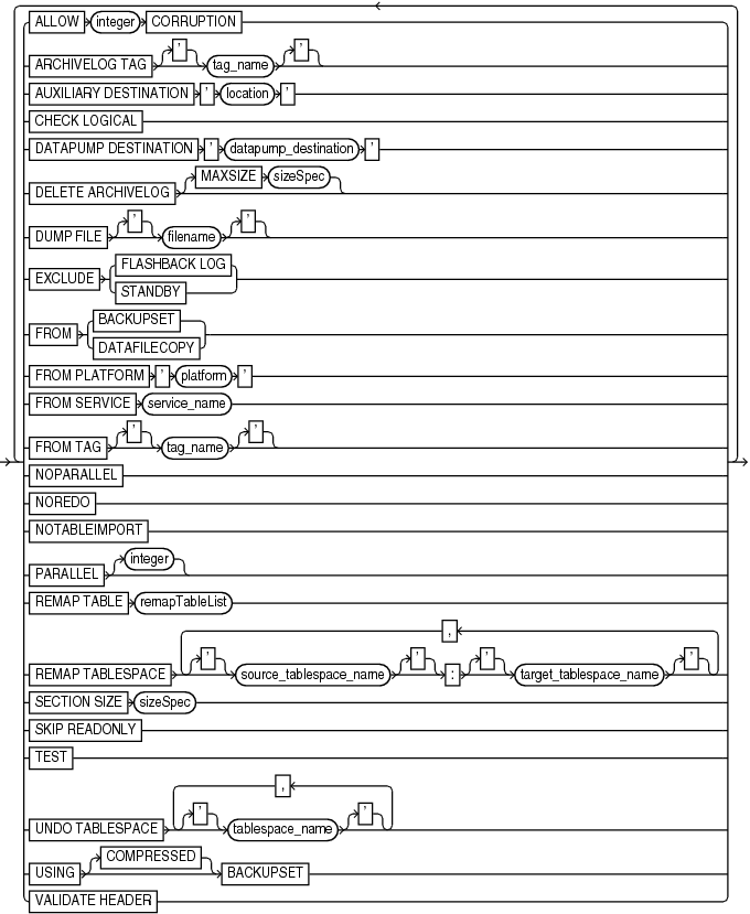

recoverOptionList
This subclause specifies various recovery options. Refer to recoverOptionList::= for the syntax diagram.
