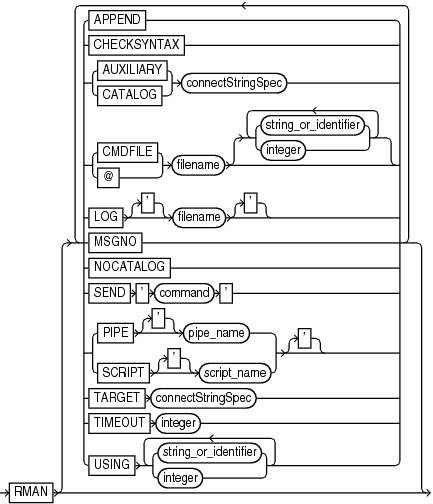

Syntax
Semantics
cmdLine
| Syntax Element | Description |
Causes new output to be appended to the end of the message log file. If you do not specify this parameter, and if a file with the same name as the message log file exists, then RMAN overwrites it. |
Causes RMAN to start in a mode in which commands entered are checked for syntax errors, but no other processing is performed (see Example 3-45). If used with a RMAN reports an |
Specifies a connect string to an auxiliary database, for example, See Also: |
Specifies a connect string to the database containing the recovery catalog, for example, See Also: |
Parses and compiles all RMAN commands in a file and then sequentially executes each command in the file. RMAN exits if it encounters a syntax error during the parse phase or if it encounters a runtime error during the execution phase. If no errors are found, then RMAN exits after the job completes. If the first character of the file name is alphabetic, then you can omit the quotes around the file name. The contents of the command file are identical to commands entered at the RMAN prompt. Note: If you run a command file at the RMAN prompt rather than as an option on the operating system command line, then RMAN does not run the file as a single job. RMAN reads each line sequentially and executes it, only exiting when it reaches the last line of the script. |
Equivalent to |
{string_or_identifier | integer} |
Equivalent to options specified after |
Specifies the file where RMAN records its output, that is, the commands that were processed and their results. RMAN displays command input at the prompt but does not display command output, which is written to the log file. By default RMAN writes its message log file to standard output. RMAN output is also stored in the The Note: The easiest way to send RMAN output both to a log file and to standard output is to use the Linux % rman | tee rman.log |
Causes RMAN to print message numbers, that is, |
Indicates that you are using RMAN without a recovery catalog. |
Sends a vendor-specific command string to all allocated channels. See Also: Your media management documentation to determine whether this feature is supported, and |
Invokes the RMAN pipe interface. RMAN uses two public pipes: one for receiving commands and the other for sending output. The names of the pipes are derived from the value of the RMAN opens the following pipes in the target database:
All messages on both the input and output pipes are of type See Also: Oracle Database Backup and Recovery User's Guide to learn how to pass commands to RMAN through a pipe |
Specifies the name of a stored script. After connecting to a target database and recovery catalog (which must be specified with the The single quotes around the stored script name are required when the script name either begins with a number or is an RMAN reserved word (see "RMAN Reserved Words"). Avoid using such names. See Also: |
Specifies a connect string to the target database, for example, See Also: |
Causes RMAN to exit automatically if it does not receive input from an input pipe within See Also: Oracle Database Backup and Recovery User's Guide to learn how to pass commands to RMAN through a pipe |
Specifies one or more values for use in substitution variables in a command file. As in SQL*Plus, The substitution variable syntax is See Also: |
