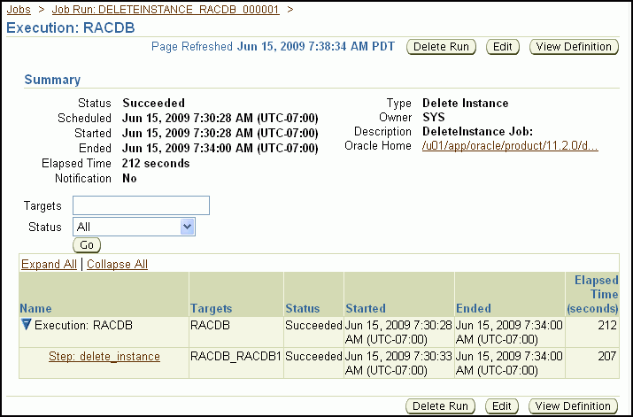

You can delete an instance from the cluster using either the Instance Management option of Database Configuration Assistant (DBCA) or using Enterprise Manager.
Sometimes, it might be necessary to remove a database instance from your cluster database. For example, to retire or repurpose a server, you first remove the database instance running on that server.
The steps described in this section require a license for the Enterprise Manager Provisioning Management pack. Refer to the Oracle Database Licensing Information for information about the availability of these features on your system.
If you choose to use DBCA to delete an instance, then start the DBCA utility from a node that will remain part of the cluster.
When you delete an instance from a clustered database, there are two methods:
See Also:
Oracle Real Application Clusters Administration and Deployment Guide for more information about removing Oracle RAC from a cluster node
To delete an instance from a policy-managed databases, you simply decrease the cardinality of the server pool for the database.
The database instance and Oracle ASM instance on the deallocated node are removed from the cluster and the node is either reassigned to another server pool or placed in the Free pool.
To delete a policy-managed database instance using Enterprise Manager:
