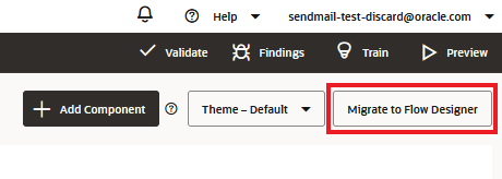

Zu visuellem Dialogmodus migrieren
Hier finden Sie Informationen zum Migrieren eines Skills von einem von OBotML verfassten Dialogablauf zu einem Visual Flow Designer-Skill.

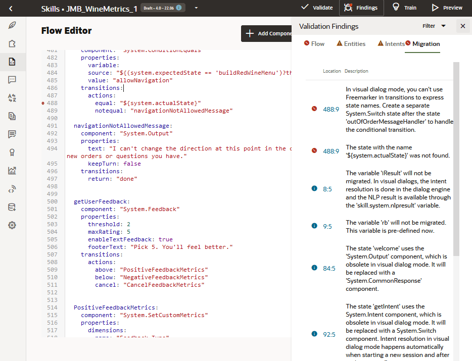

Die neue Version des Skills wird von einem Migrationslog begleitet, das die Konvertierung veralteter Eigenschaften und Komponenten dokumentiert.
8:5 The variable 'iResult' will not be migrated. In visual dialogs, the intent resolution is done in the dialog engine and the NLP result is available through the 'skill.system.nlpresult' variable.
9:5 The variable 'rb' will not be migrated. This variable is pre-defined now.
84:5 The state 'welcome' uses the 'System.Output' component, which is obsolete in visual dialog mode. It will be replaced with a 'System.CommonResponse' component.
92:5 The state 'getIntent' uses the System.Intent component, which is obsolete in visual dialog mode. It will be replaced with a System.Switch component. Intent resolution in visual dialog mode happens automatically when starting a new session and after ending a root flow.
115:7 The property 'values' in the state 'startDetermineWineType' is obsolete in visual dialog mode and will be removed.
122:9 The 'NONE' transition action in the state 'startDetermineWineType' is obsolete in visual dialog mode and will be removed. The 'next' transition is used instead.
