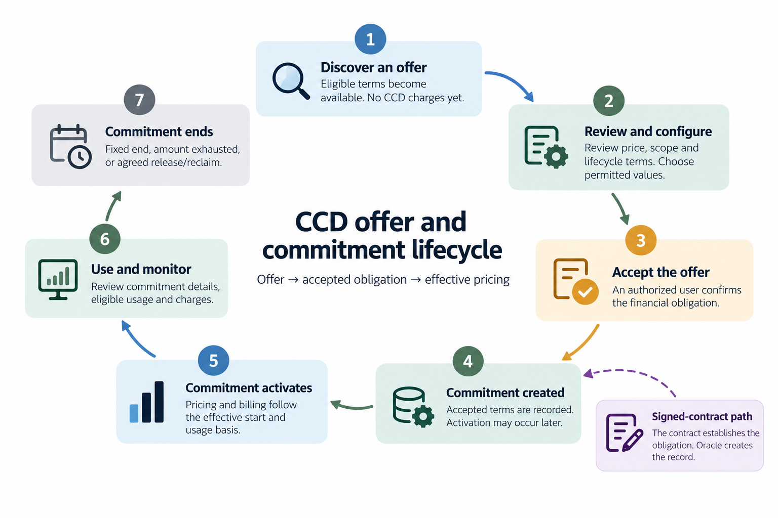

The CCD Offer and Commitment Lifecycle
Here's how you work with CCD offers and commitments:
Some Flex pricing continues beyond the minimum period while capacity is retained. In the previous image, the circular layout doesn't imply automatic renewal.
| CCD Lifecycle Step | Description | More Information |
| 1. Discover an offer | From the Continuous Consumption Discounts page, select Create commitment to review eligible CCD offers. | |
2. Review and configure 3. Accept the offer 4. Commitment created |
Review the offer's price, scope, and lifecycle terms, and select permitted values, such as SKU quantity, if allowed. You then confirm the financial obligation by creating the commitment. (Note that activation may occur later.) |
| 5. Commitment activates | Pricing and billing follow the effective start and usage basis. | |
| 6. Use and monitor | Review commitment details, eligible usage, and charges. | Reviewing and Reconciling CCD Charges |
| 7. Commitment ends | Fixed end, amount exhausted, or agreed release/reclaim. | When a Commitment Ends |
