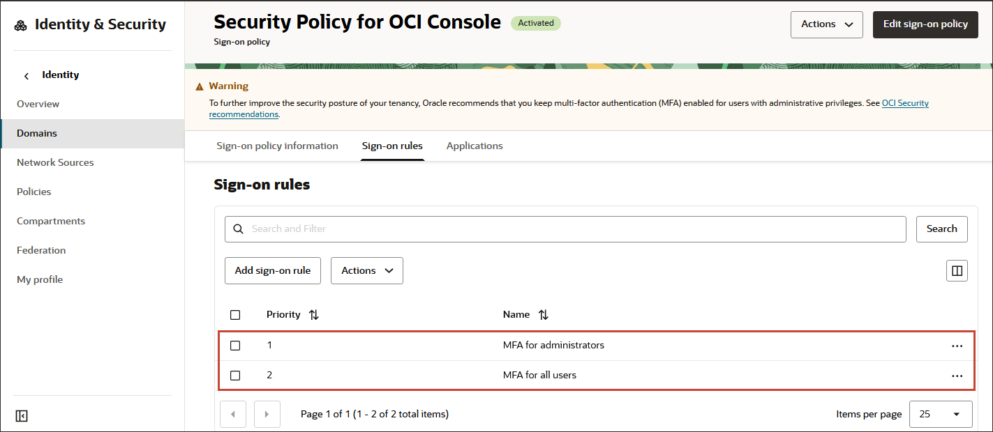

The "Security Policy for OCI Console" Sign-On Policy
The Security Policy for OCI Console sign-on policy is activated by default and preconfigured with Oracle security best practices.
- The following factors needed for this sign-on policy are already enabled: Mobile app passcode, Mobile app notification, Bypass code, and Fast ID Online (FIDO) authenticator.
- The OCI Console application has been added to the policy.
- The sign-on policy comes with two active sign-on rules:
- MFA for administrators: The rule is first in priority order. This preconfigured rule requires that all users in the Administrators group and all users with an administrator role must enroll in MFA and must supply an additional factor every time they sign in. Note
You can remove this rule and use the MFA for all users rule to require all users (including administrators) to enroll in MFA. Or you can leave this rule in place and all users (including administrators) will still be required to enroll in MFA when the MFA for all users rule is evaluated. - MFA for all users: The rule is second in priority order. This preconfigured rule requires that all users must enroll in MFA and must supply an additional factor every time they sign in.Note
If you don't want to require MFA for all users at this time, you can make this rule optional and users will have the option to enroll into MFA. Or you can remove this rule and keep the MFA for administrators so that only administrators must enroll in MFA.
Whichever rule you decide to keep, exclude at least one administrator from the rule. If you keep both rules, make the change to both rules. See Creating a Sign-On Policy to learn how to exclude users from a sign-on rule.
To set up MFA using the Security Policy for OCI Console sign-on policy see the best practices at Identity Domains With the "Security Policy for OCI Console" Sign-On Policy.
