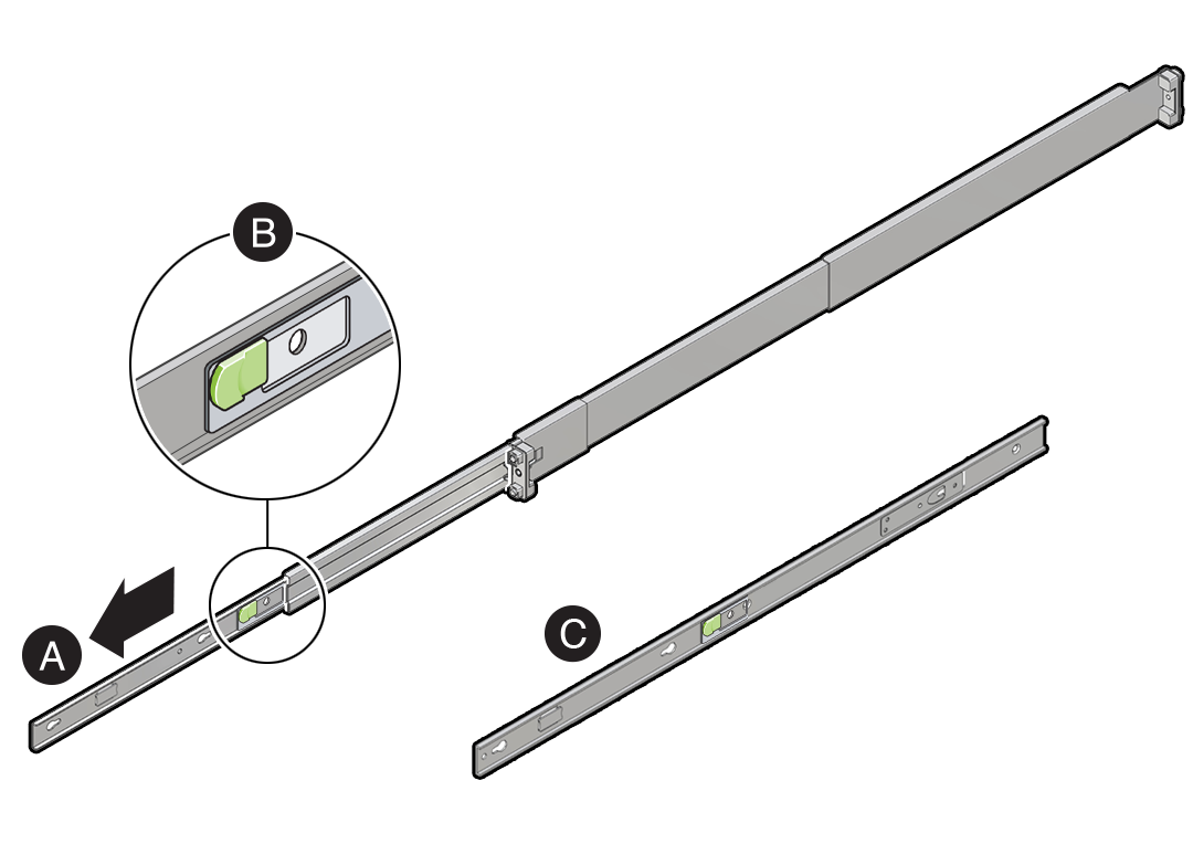

  1. Separate the device mounting brackets from the slide-rails.
    An illustration showing how to separate the mounting brackets from the slide-rails.
    1. Pull the mounting brackets out of the slide-rail brackets.
    2. Press the release lever to release the locking mechanism.
    3. Remove the mounting brackets from side-rails.

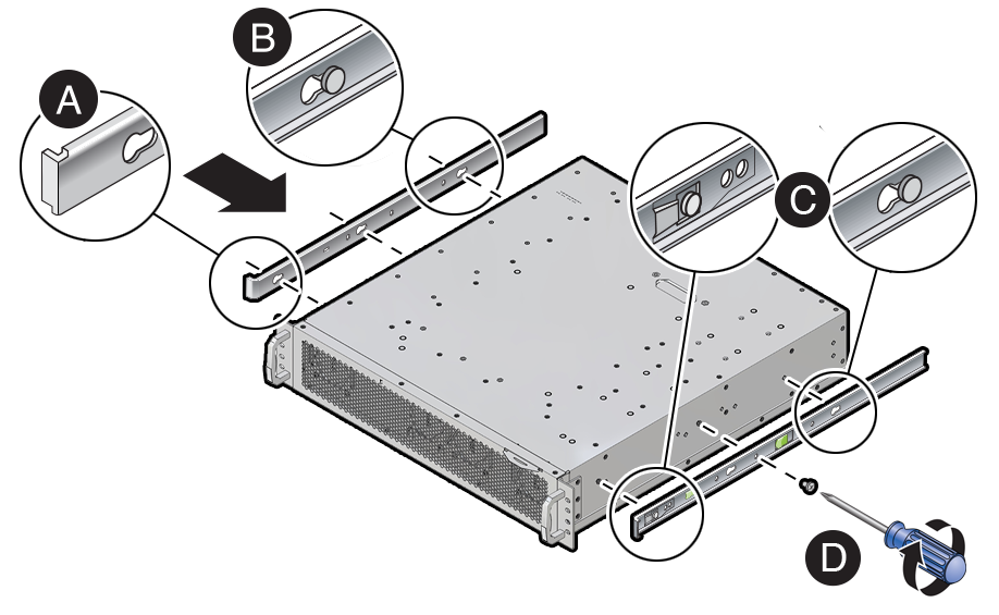

  2. Attach the mounting brackets to the device.
    An illustration showing how the slide-rails are attached to the device.
    1. Position the mounting brackets against the device so that the slide-rail stop is at the front of the device.
    2. Line up the keyhole openings on the mounting bracket with the locating pins on the side of the device.
    3. Push the mounting brackets forward until they lock in place with an audible click.
    4. Secure the mounting brackets by installing one M4 screw to each side of the device.

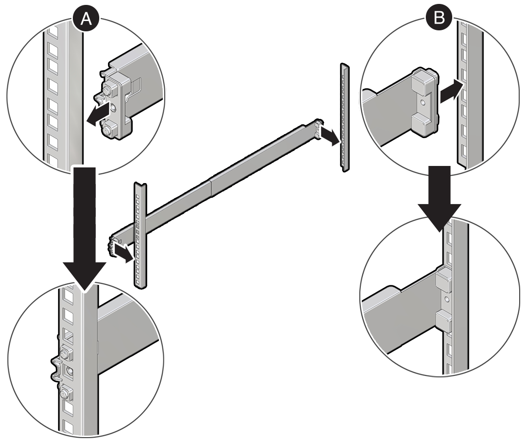

  5. Attach the two slide-rails to the rack.
    An illustration showing how to mount the mounting brackets to a rack.
    1. Snap the front slide-rails into the front rack posts.
    2. Adjust the rear slide-rails to reach the rear rack posts, then snap the slide-rails into the rear rack posts.

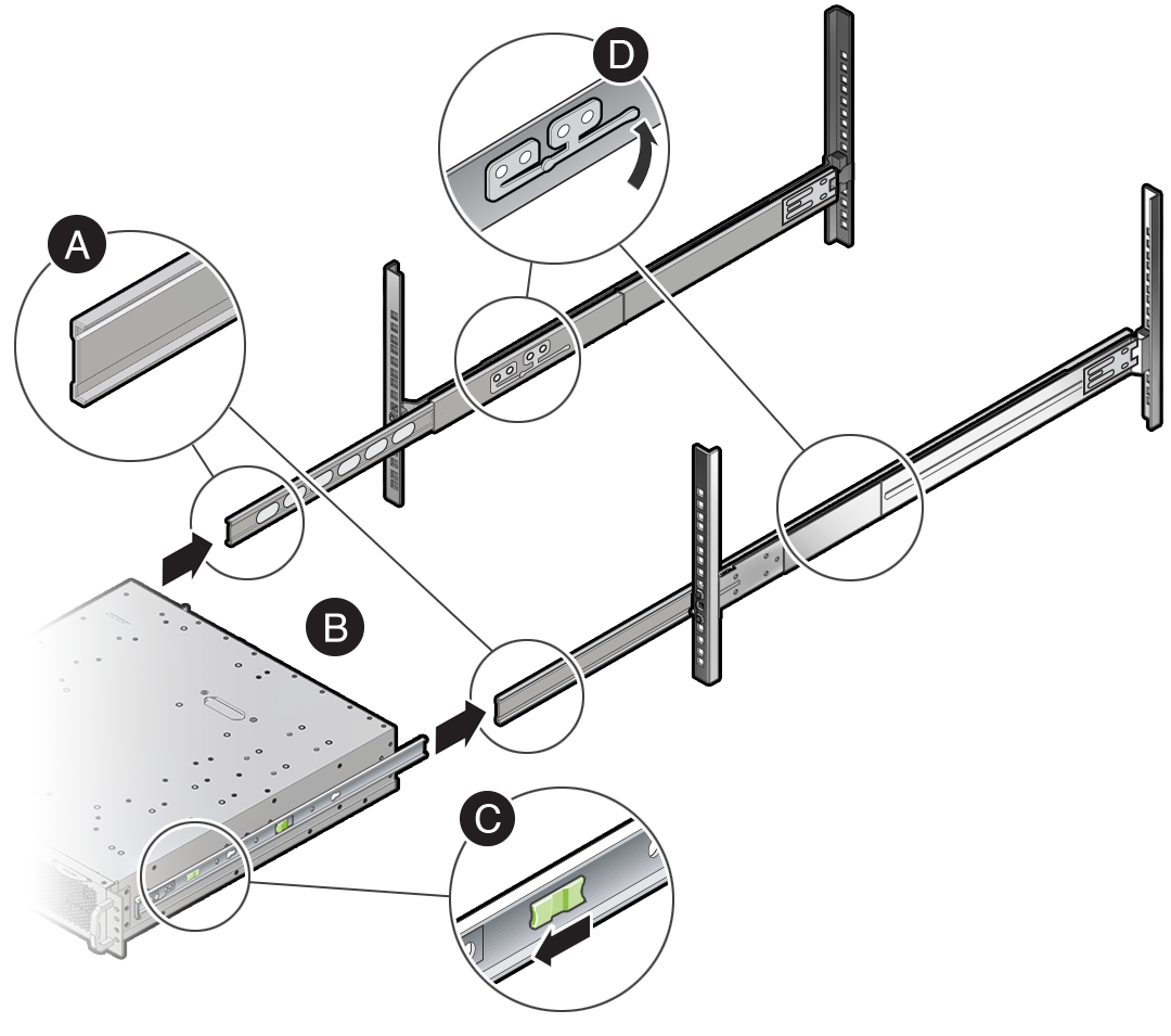

  6. Install the device into the slide-rails.
    An illustration showing how to install the device in the slide-rails.
    1. Extend the inner-front slide-rails.
    2. Slide the mounting brackets into the extended slide-rails until the device is securely supported by the slide-rails, but is extended from the rack.
    3. Pull the green lever forward to enable the mounting brackets to slide fully into the slide-rails.
    4. Lift the slide-rail stop lever and push the device completely into the rack.

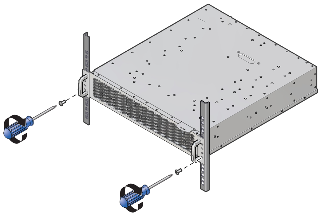

  7. Install two M4 screws to the front of the device.
    An illustration showing where the front screws are installed.
