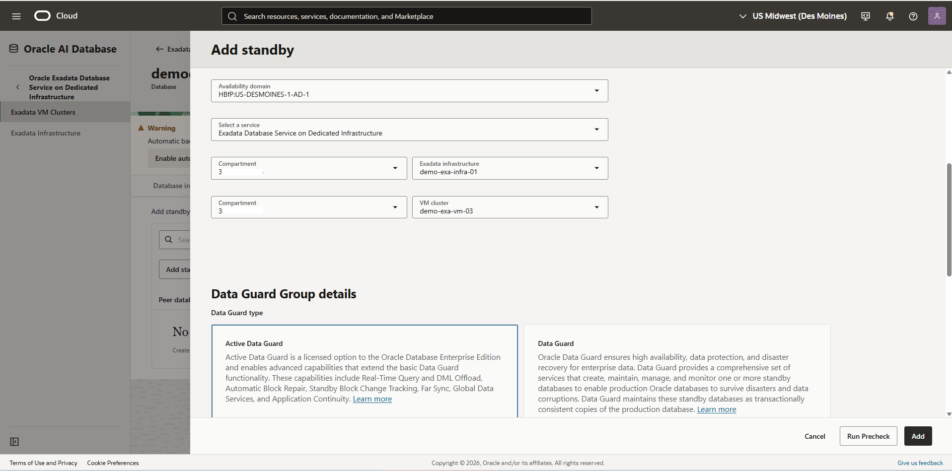

    2. Select the Peer region where the standby database will be running.
    3. Select the Availability domain where the standby Oracle Exadata Database Service on Dedicated Infrastructure is deployed.
      Note
      • For cross-region Data Guard, make sure to select a different region than the source.
      • For cross-zone Data Guard, make sure to select the same region and a different Availability Domain than the source.
    4. From the Select a service dropdown list, select Exadata Database Service on Dedicated Infrastructure.
    5. Select Compartment and Exadata Infrastructure from the dropdown list. Select the Exadata Infrastructure where the standby will be running. If the standby database will be running on an infrastructure on a different compartment, select the corresponding compartment. By default, the same compartment as the primary database is selected.
    6. Select Compartment and VM Clusters from the dropdown list. Select the VM cluster where the standby database will be running. If the standby database will be running on a VM cluster on a different compartment, select the corresponding compartment. By default, the same compartment as the primary database is selected.
    7. Select Active Data Guard or Data Guard as Data Guard type. Active Data Guard provides additional features including: Real-Time Query and DML Offload, Automatic Block Repair, Standby Block Change Tracking, Far Sync, Global Data Services, and Application Continuity.

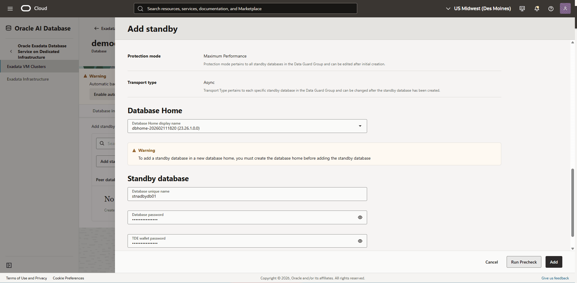

    8. The Protection mode field is set to Maximum Performance by default.
    9. The Transport type field is set to Async by default. This is the only supported option for cross-region Data Guard.
      Note
      For cross-region Data Guard, the Maximum Performance protection mode and Async Transport type are supported.
    10. From the Database Home display name dropdown list, select your existing Database Home. Ensure the database home runs the same Oracle Database software version and patches as the primary.
    11. Enter a name in the Database unique name field for the peer standby database.
      Note
      You cannot modify the db_unique_name and SID prefix after creating the database.

    12. Enter the database administrator password of the primary database. Use this same database administrator password for the standby database.
      Note
      The administrator password and the TDE wallet password must be identical. If the passwords are not identical, then follow the instructions in Changing the Database Passwords to ensure that they are.
    13. Enter the TDE wallet password.
