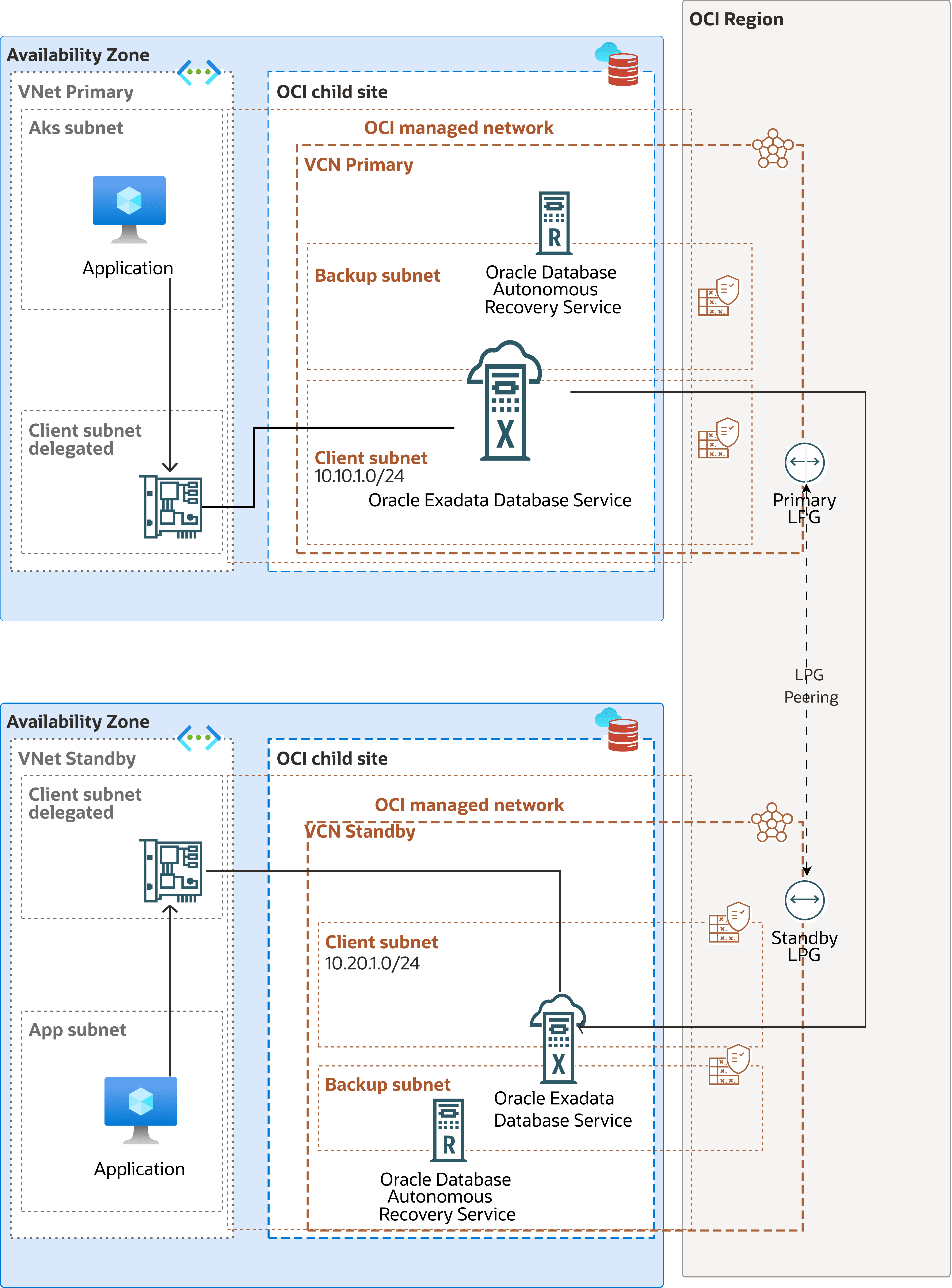

    The following diagram illustrates the architecture diagram for configuring cross-AZ by OCI network.
    This screenshot shows the architecture diagram.

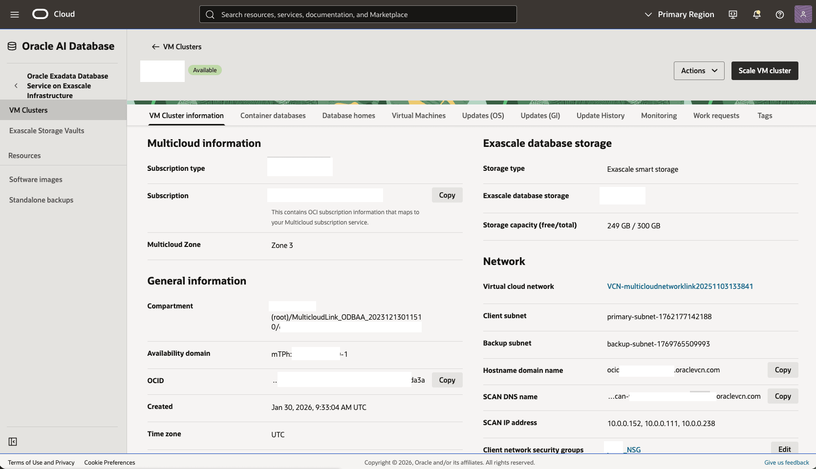

    Oracle AI Database@Azure runs in an Exadata Database, Exascale VM Cluster or Base Database in the primary availability zone. For data protection, Oracle Data Guard replicates the data to a different availability zone (local standby) in the same region. A local standby is ideal for failover scenarios, offering zero data loss for local failures while applications continue operating without the performance overhead of communicating with a remote region.
    You can route Data Guard traffic through the Azure network. In this architecture, it directs Active Data Guard network traffic through the OCI network to optimize network throughput and latency. The VCNs on the OCI site are created after the Exadata VM Cluster(s) on Oracle AI Database@Azure are created for the primary and standby databases.
    In this architecture:
    • The primary Exadata VM Cluster is deployed in the primary availability zone in VCN1 with CIDR 10.10.0.0/16 and client subnet CIDR 10.10.1.0/24.
    • VCN1 has a Local Peering Gateway LPG1.
    • The standby Exadata VM Cluster is deployed in the standby availability zone in VCN2 with CIDR 10.20.0.0/16 and client subnet CIDR 10.20.1.0/24.
    • VCN2 has a Local Peering Gateway LPG2.
    • VCN1 and VCN2 are peered with a Local Peering Connection via LPG1 and LPG2.

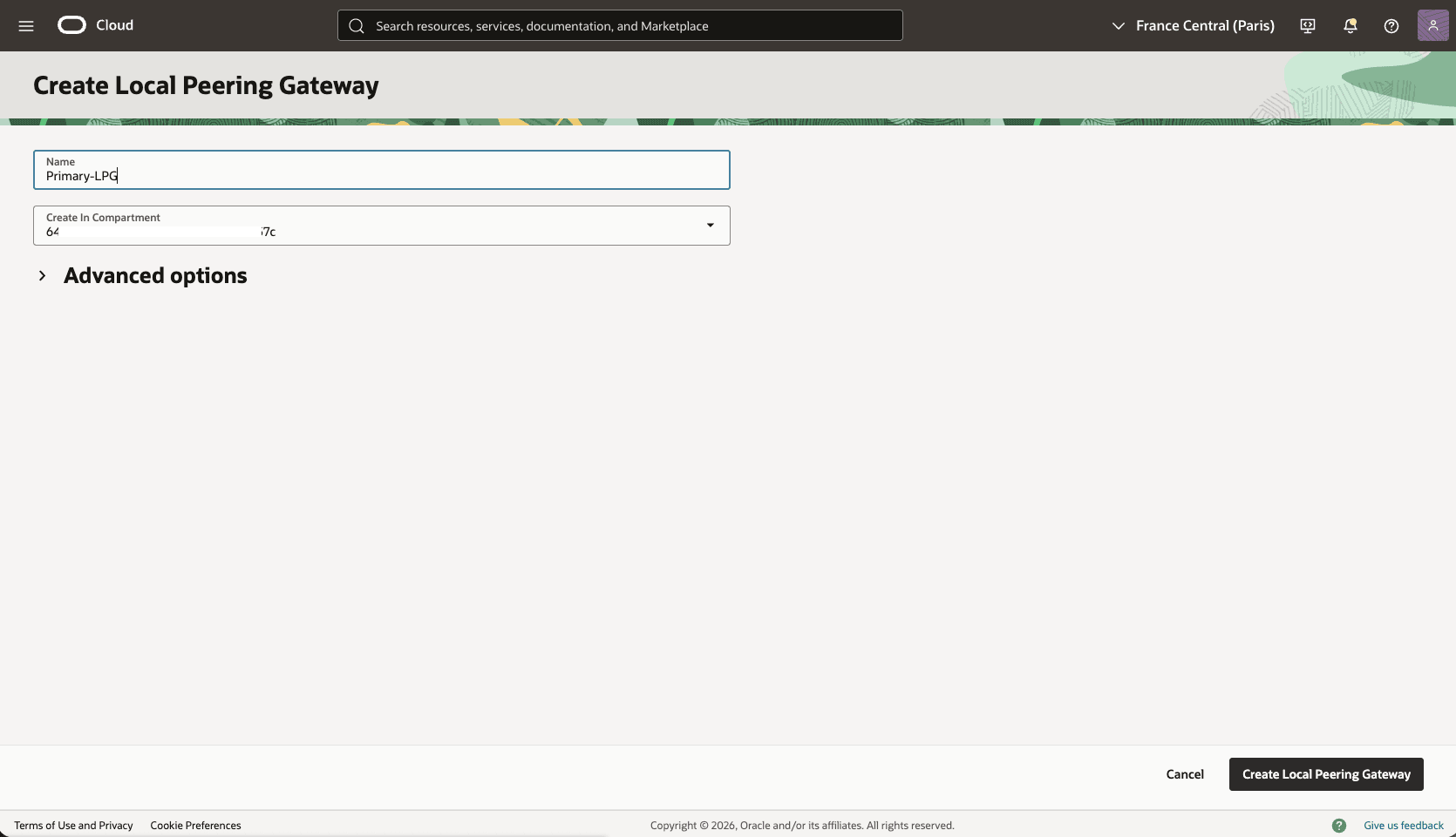

    Configure the Network in the Primary Zone
    Configure the network in the primary zone by using the following steps:

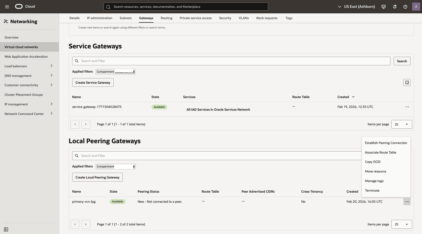

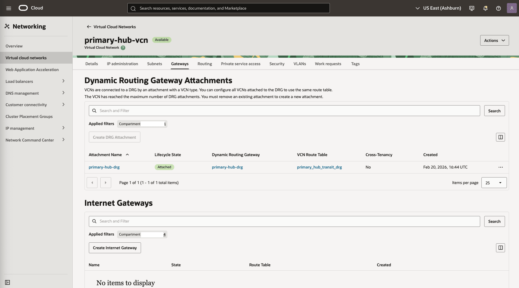

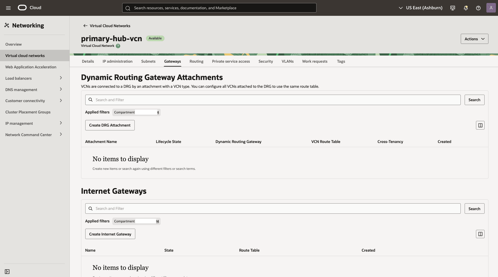

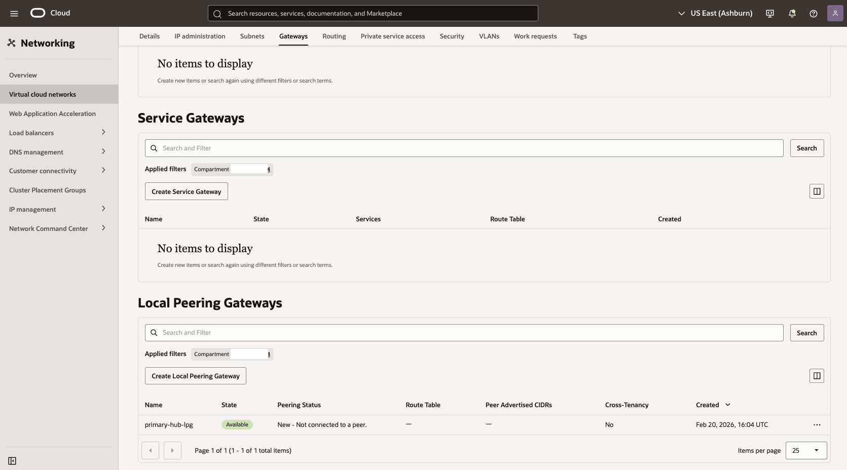

    1. From the OCI console, scroll down to the Network section, then select the Virtual Cloud Network. This screenshot shows how to configure the network in the primary zone.
    2. In the Virtual Cloud Networks detail page, select the Gateways tab.

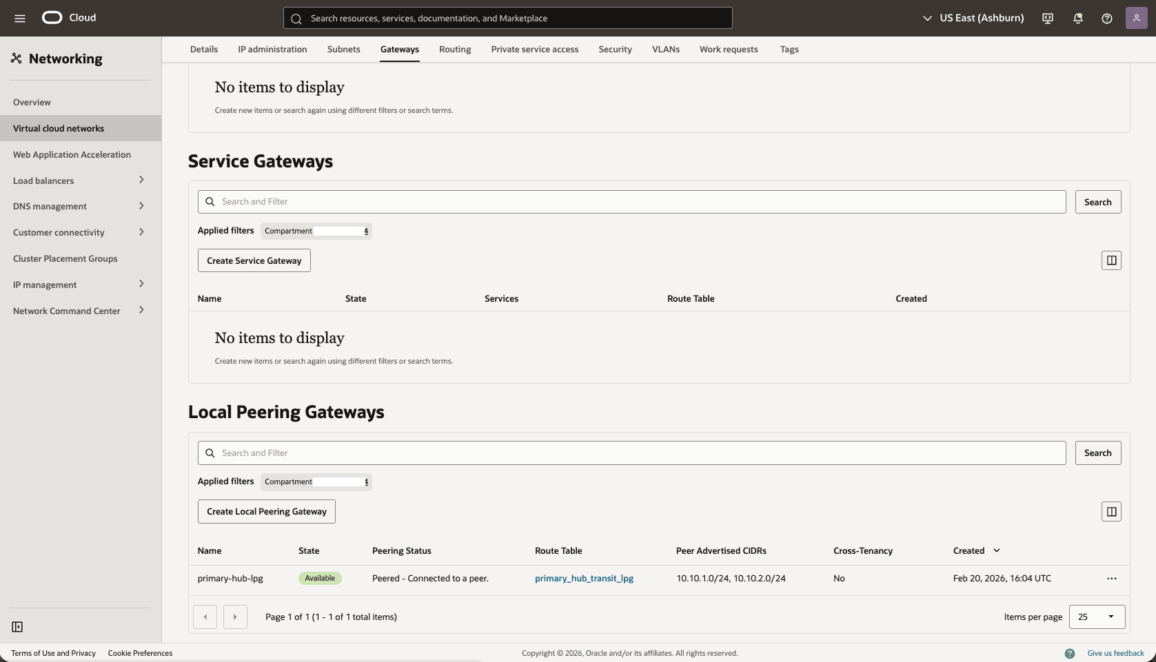

    3. Scroll down to the Local Peering Gateways section, and then select the Create Local Peering Gateway button. This screenshot shows how to configure the network in the primary zone.
      1. Select a name, for example, Primary-LPG, and then select the Create Local Peering Gateway button. Record the local peering gateway OCID.
      2. The Advanced options section is optional.
      3. Select the Create Local Peering Gateway button.

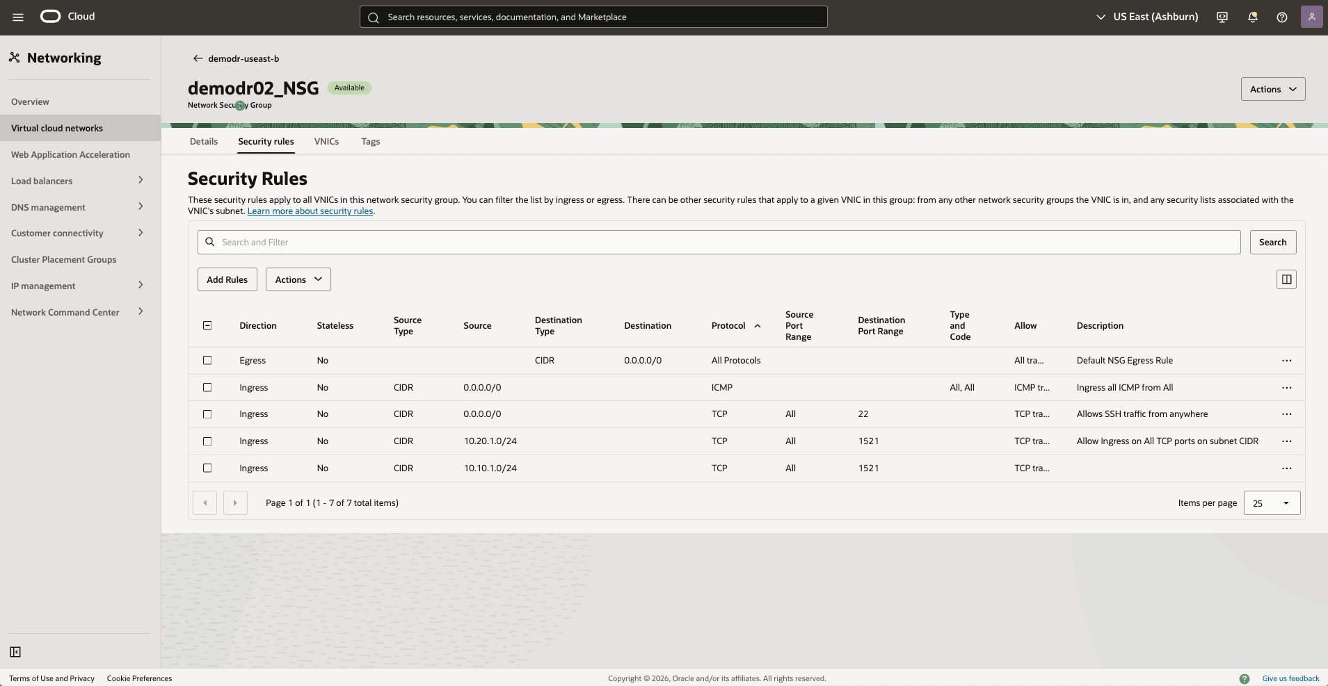

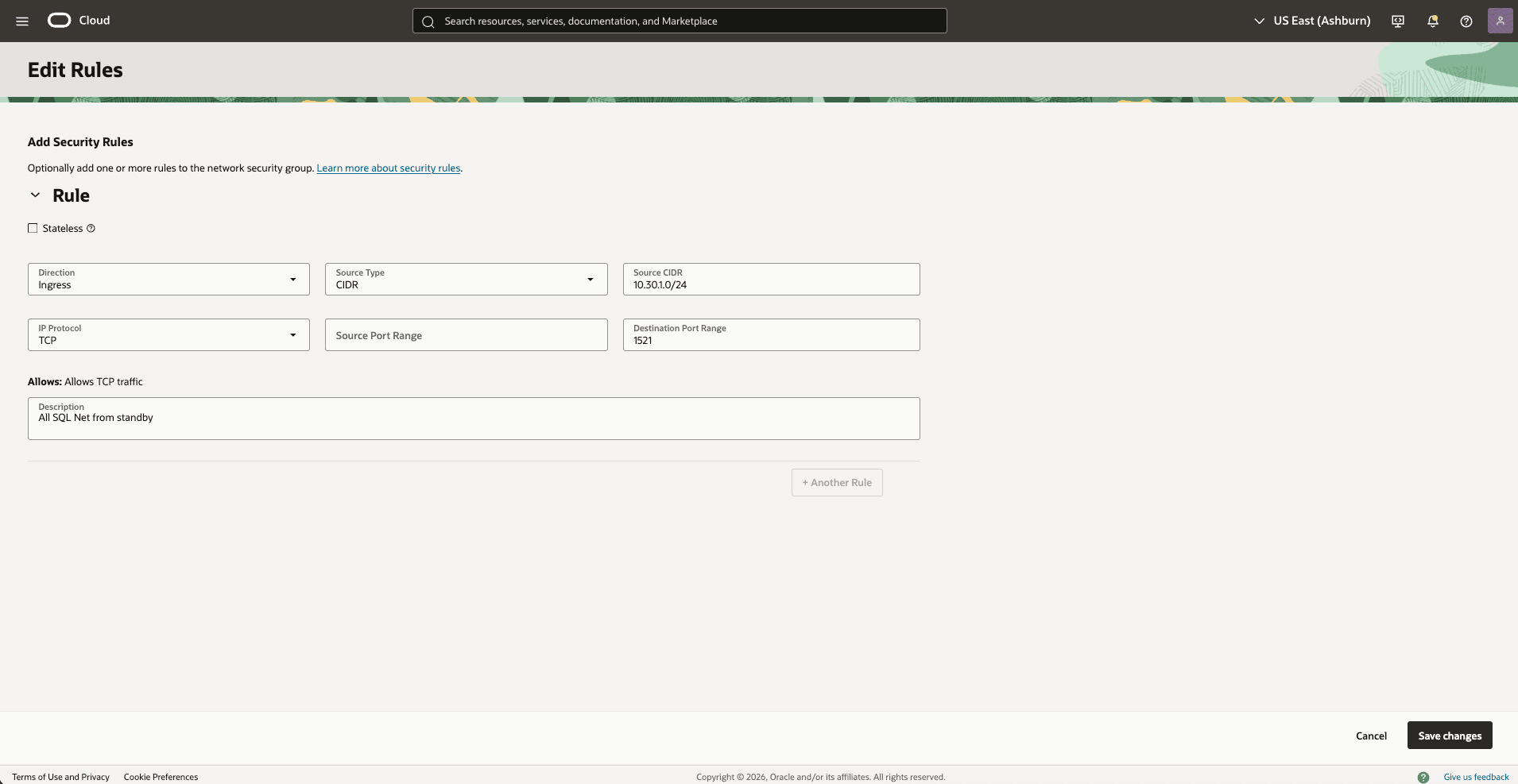

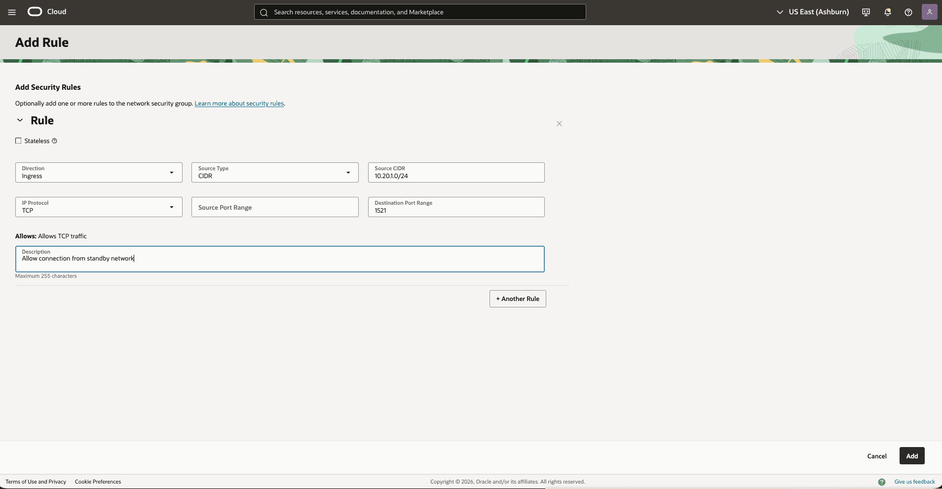

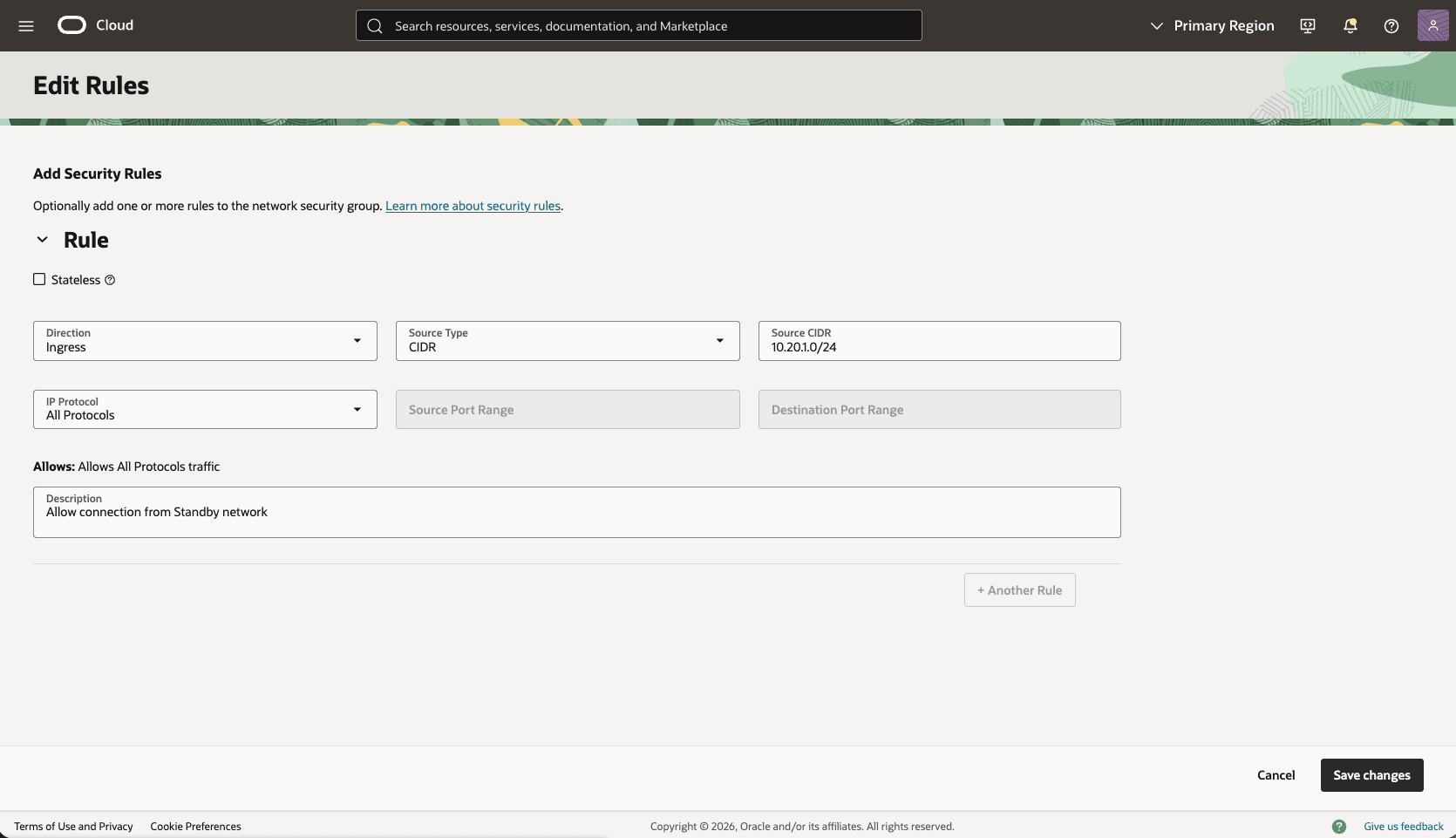

    4. Update the OCI network security group for your primary VM cluster to allow traffic from the standby network.
      1. In the Virtual Cloud Networks detail page, select the Security tab, scroll down to the Network Security Groups section, and then select the name of your VM Cluster Network Security Groups.
      2. Select the Security rules tab. Select Add Rules, and then create a rule with the following specifications.
        1. Direction: Ingress
        2. Source Type: CIDR
        3. Source CIDR: Enter your standby CIDR block. For example, 10.20.1.0/24
        4. IP Protocol: TCP
        5. Source Port Range: Empty (All)
        6. Destination Port Range: 1521
        7. Description: Enter a description for this rule,
        8. Select the Add button.

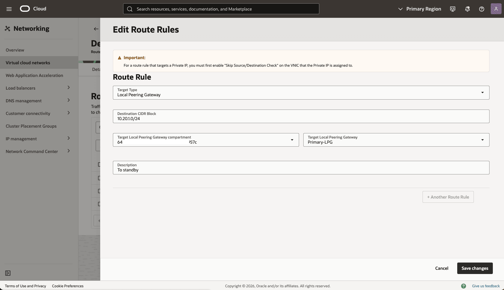

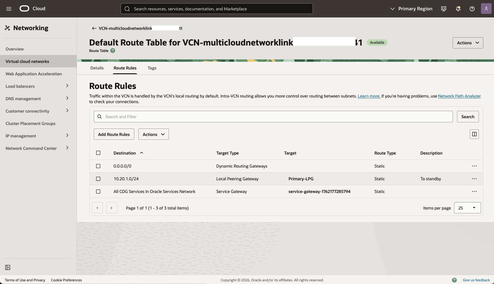

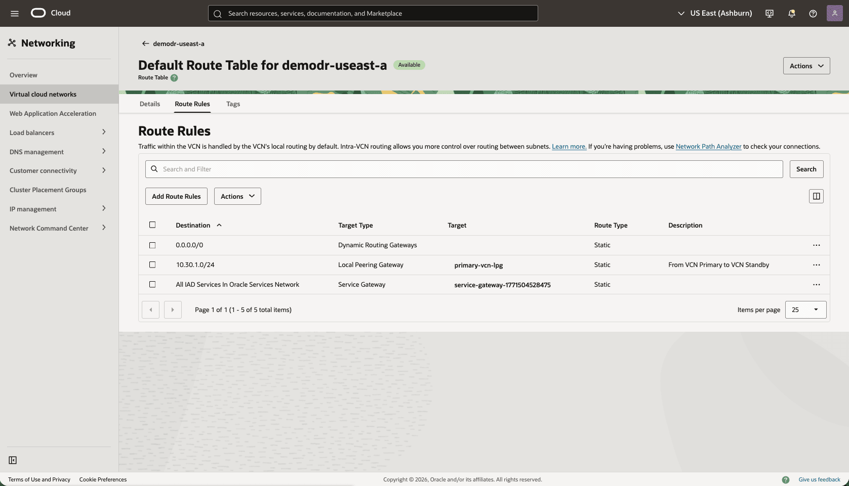

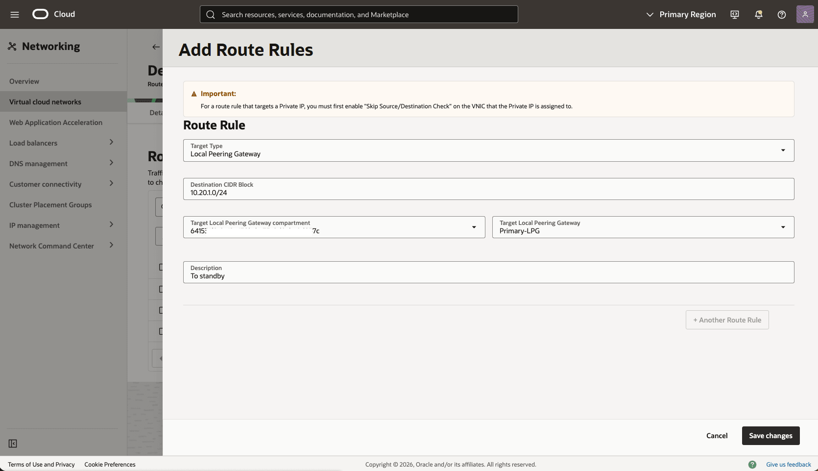

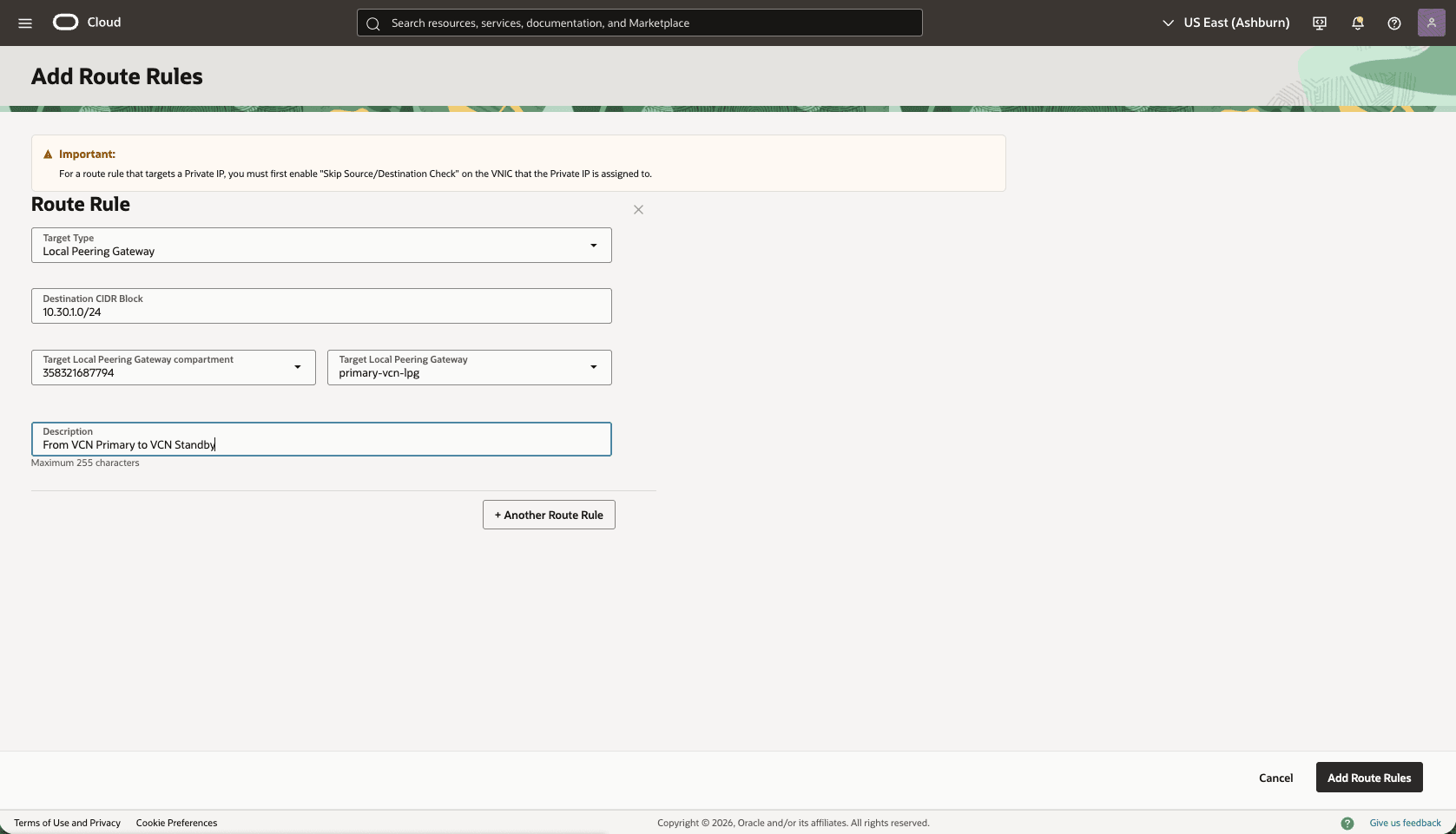

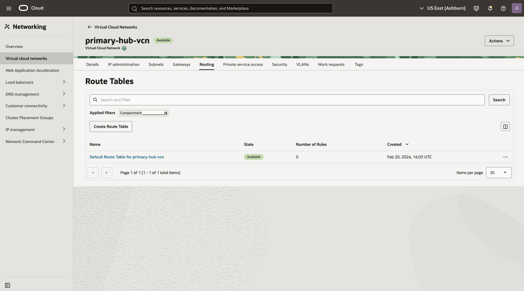

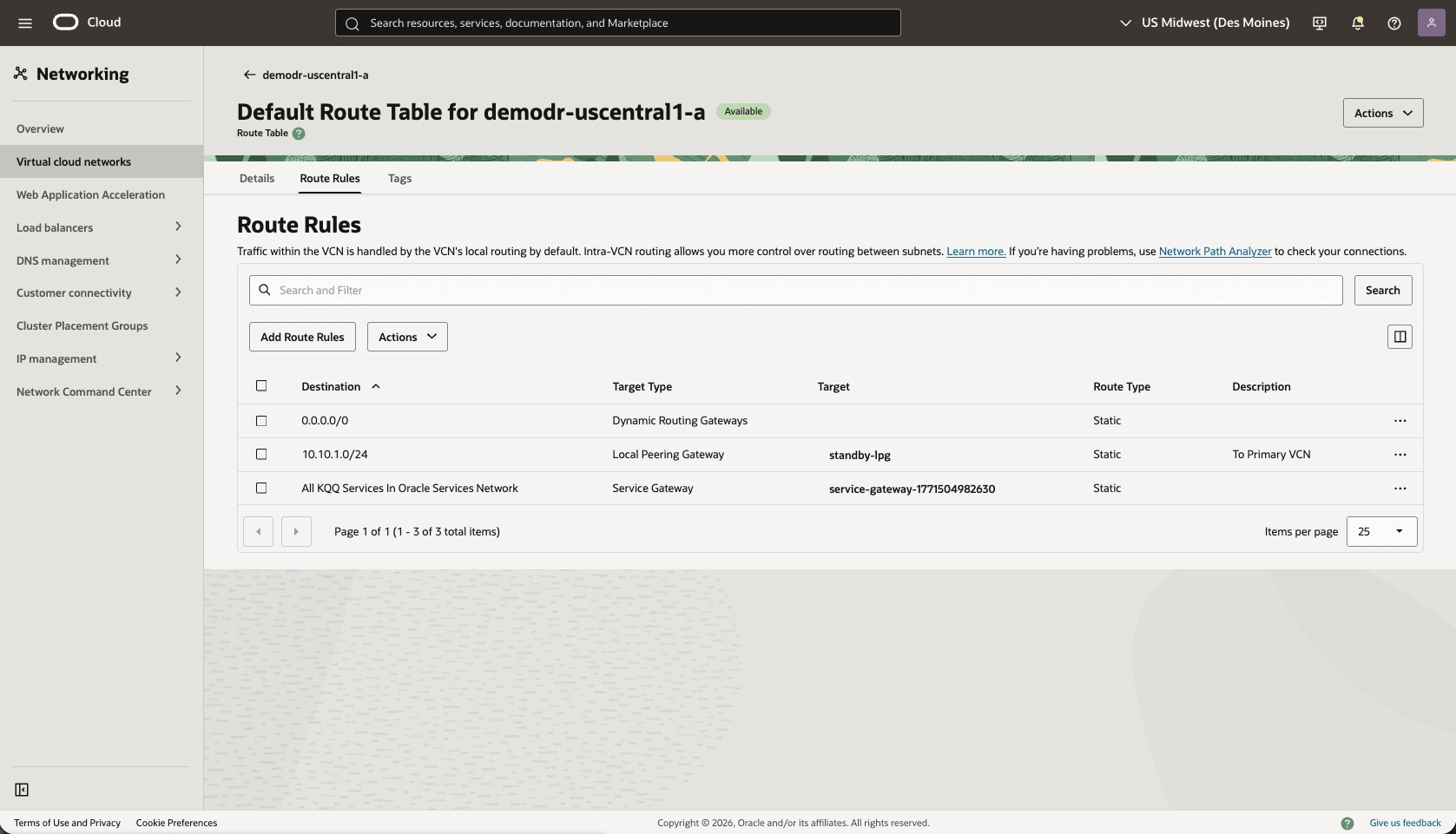

    5. Add a route rule to the default route table in the primary VCN to route standby traffic to Primary-LPG.
      1. In the primary Virtual Cloud Networks detail page, select the Routing tab, select the name of your default route table. This screenshot shows how to configure the network in the primary zone.
      2. Select the Route Rules tab, and then select the Add Route Rules button. This screenshot shows how to configure the network in the primary zone.
        1. Route Rule: Local Peering Gateway
        2. Destination CIDR Block: Enter your standby CIDR block. For example,10.20.1.0/24
        3. Target Local Peering Gateway Compartment: Select the compartment that you created the local peering gateway in the previous step.
        4. Target Local Peering Gateway: Select your Local Peering Gateway.
        5. Description: Enter a description for this Route rule.
        6. Select the Add Route Rules button.

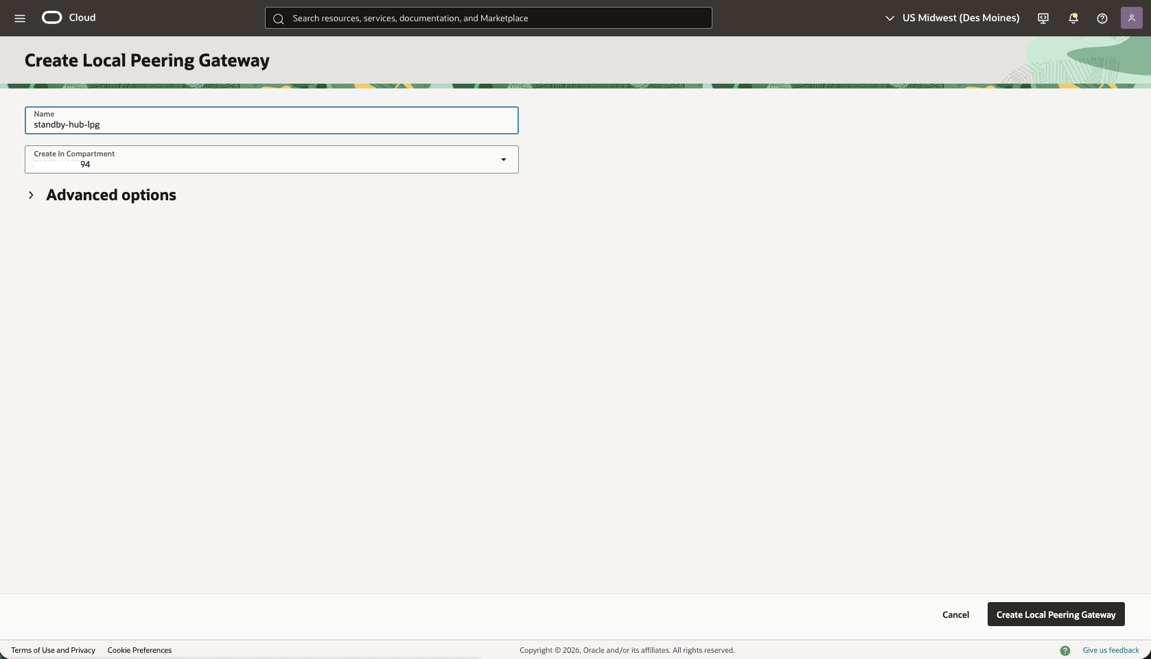

    Configure the Network in the Standby Zone
    Configure the network in the standby availability zone by using the following steps:

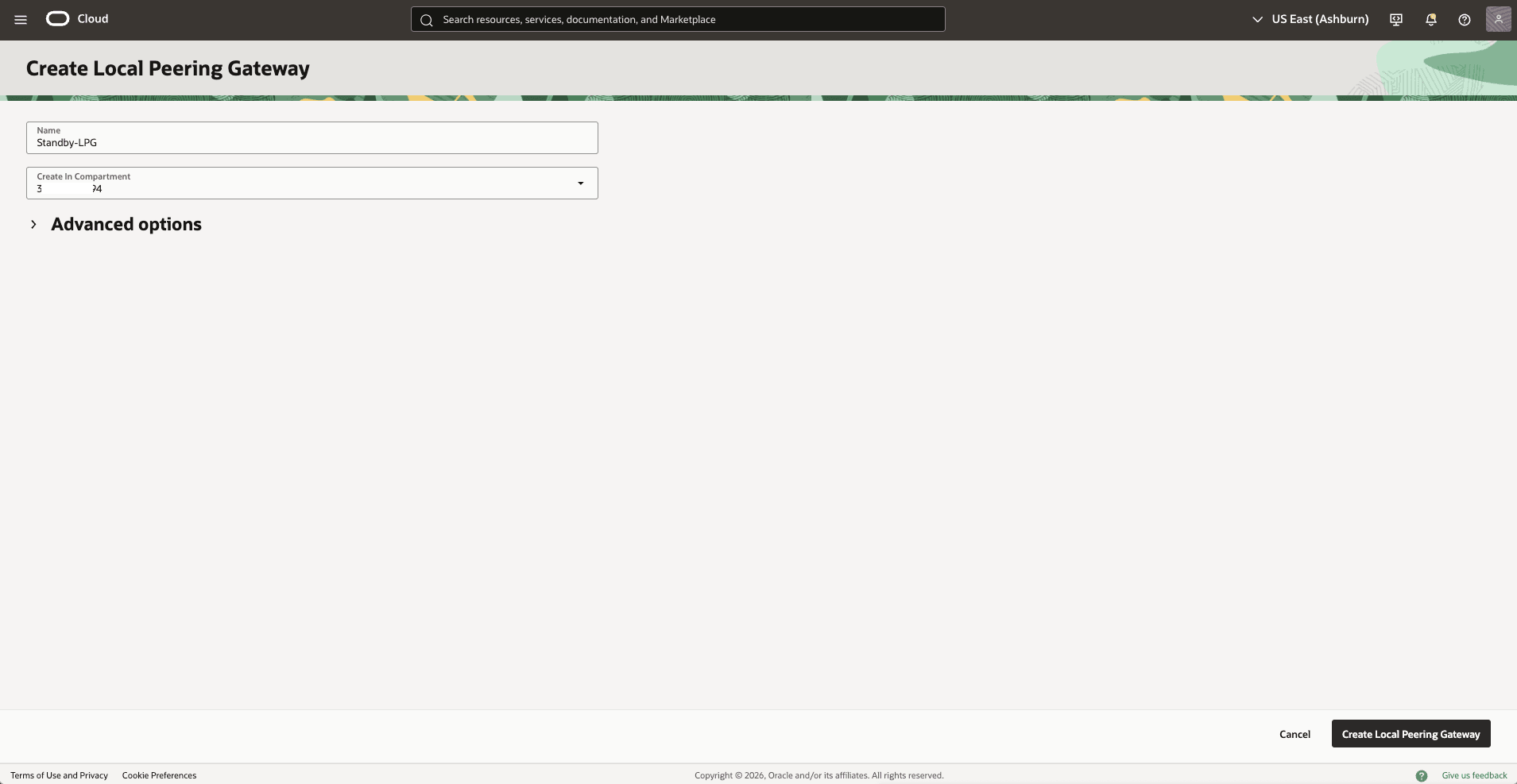

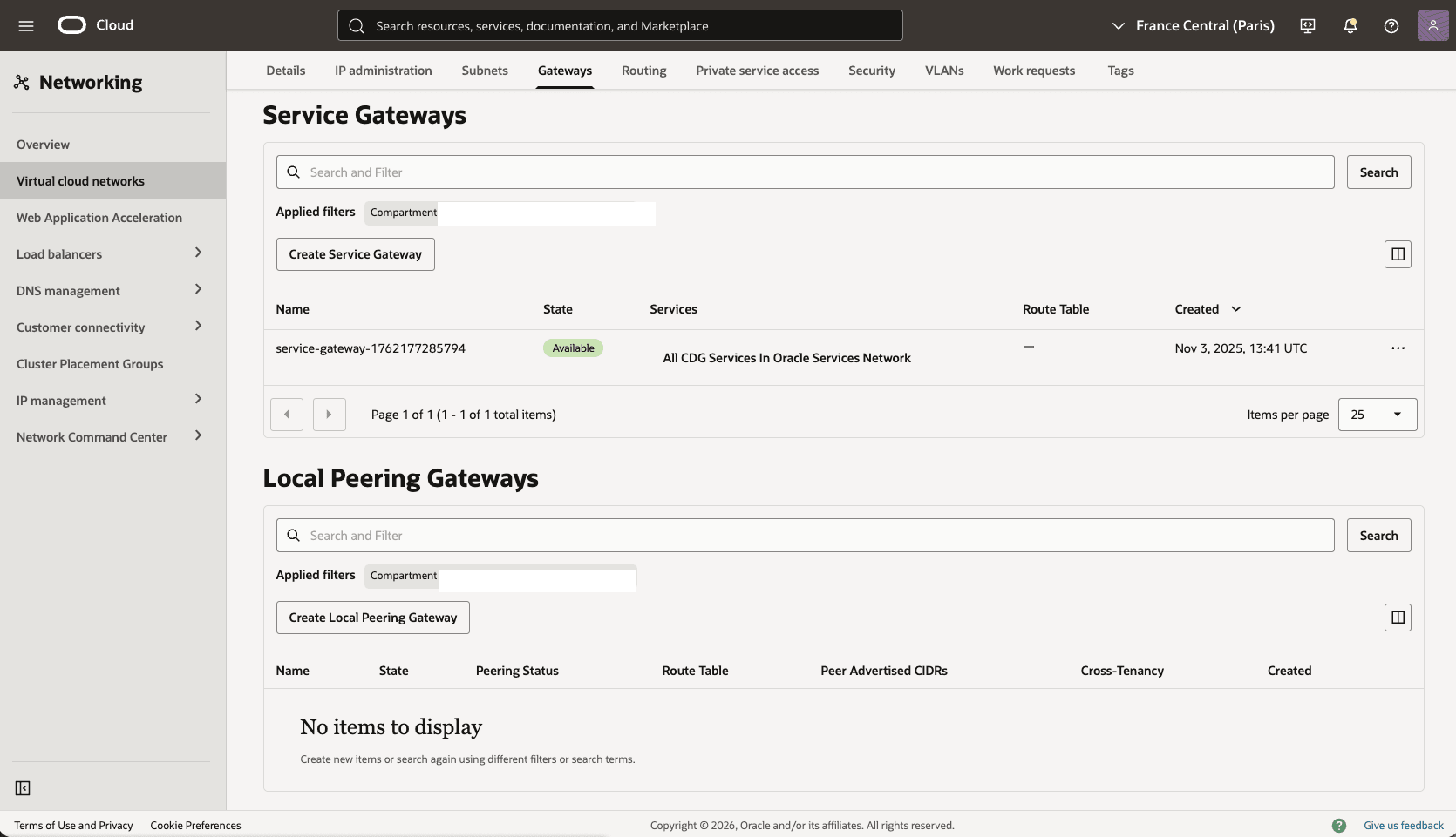

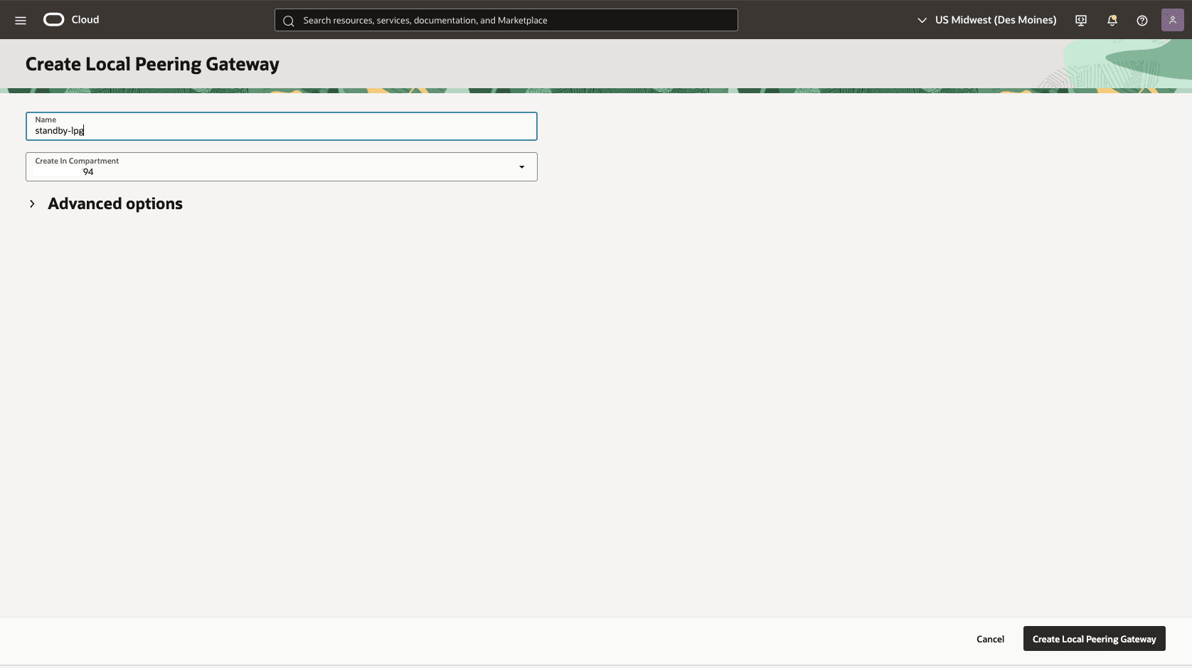

    1. From the OCI console select the name of your standby VM Cluster, Scroll down to the Network section, and then select the standby Virtual cloud network link. This screenshot shows how to configure the network in the primary zone.

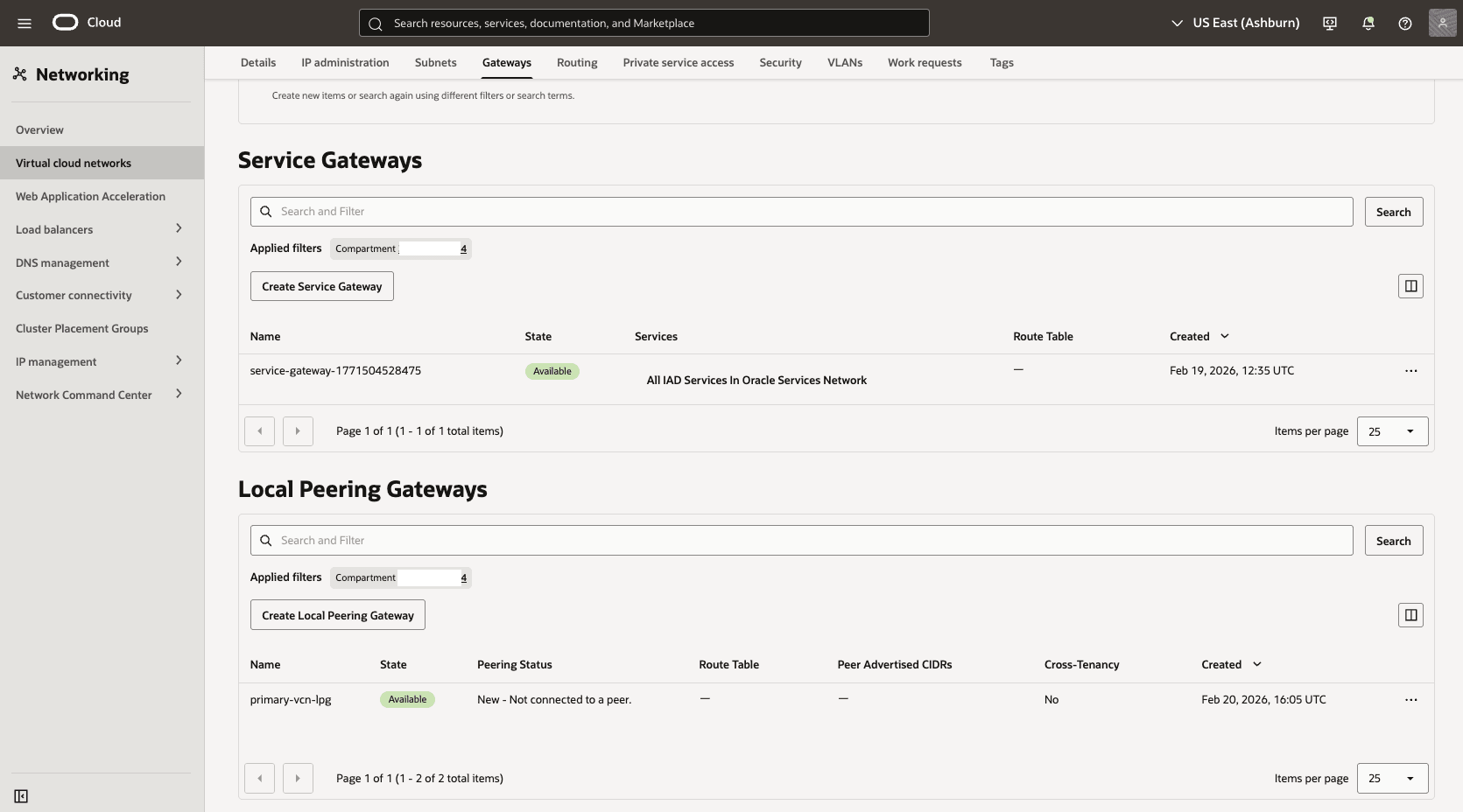

    2. Create Local Peering Gateway Standby-LPG in Virtual Cloud Network.
      1. In the Virtual Cloud Networks detail page, select the Gateways tab.
      2. Scroll down to the Local Peering Gateways section, and then select the Create Local Peering Gateway button. This screenshot shows how to configure the network in the primary zone.

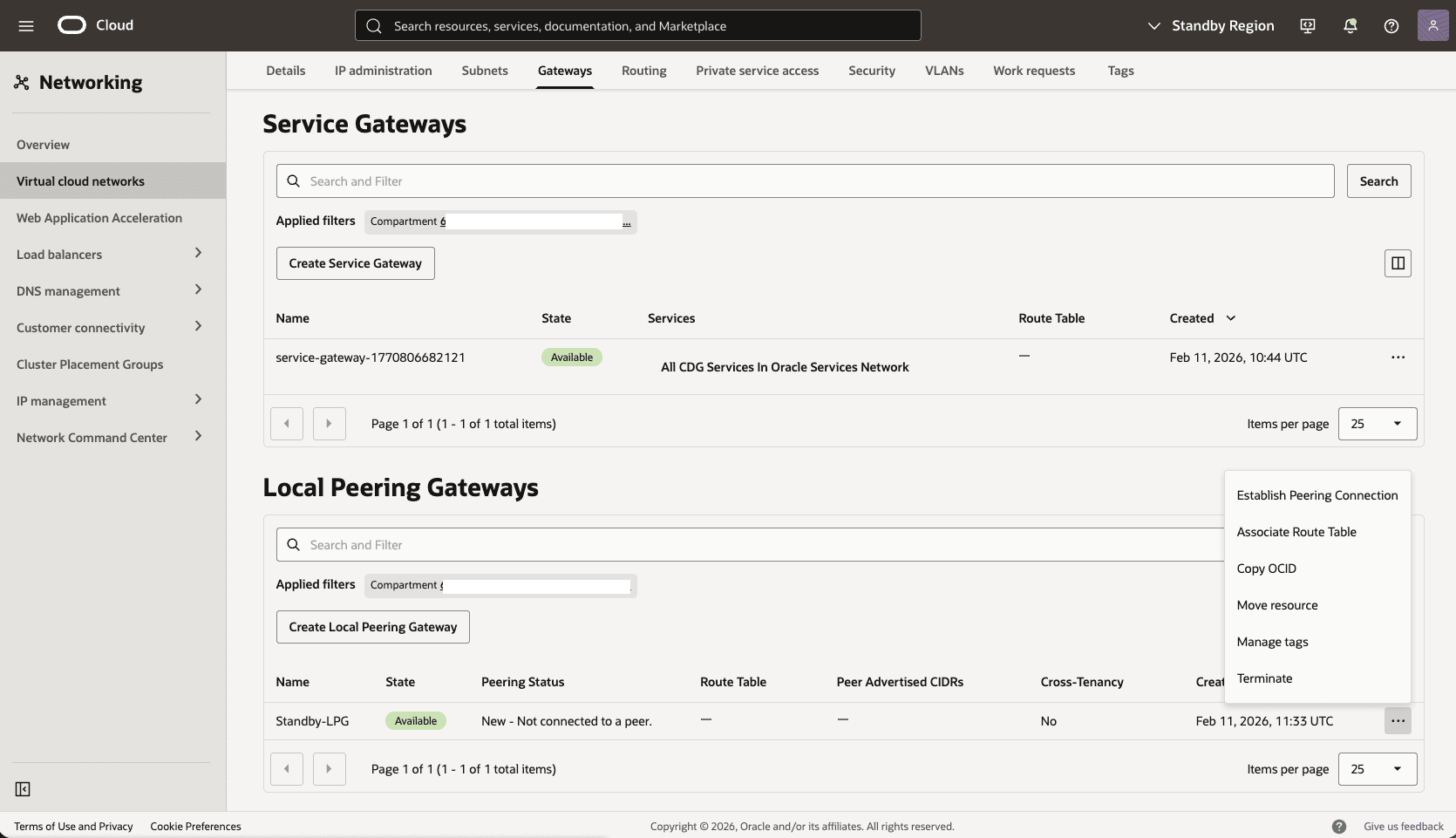

        1. Select a name, for example, Standby-LPG, and then select the Create Local Peering Gateway button.

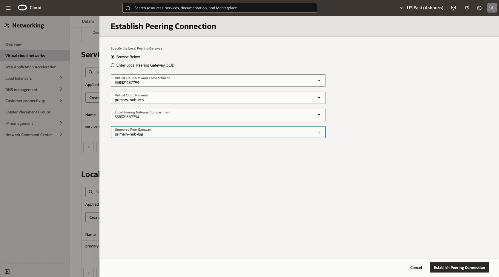

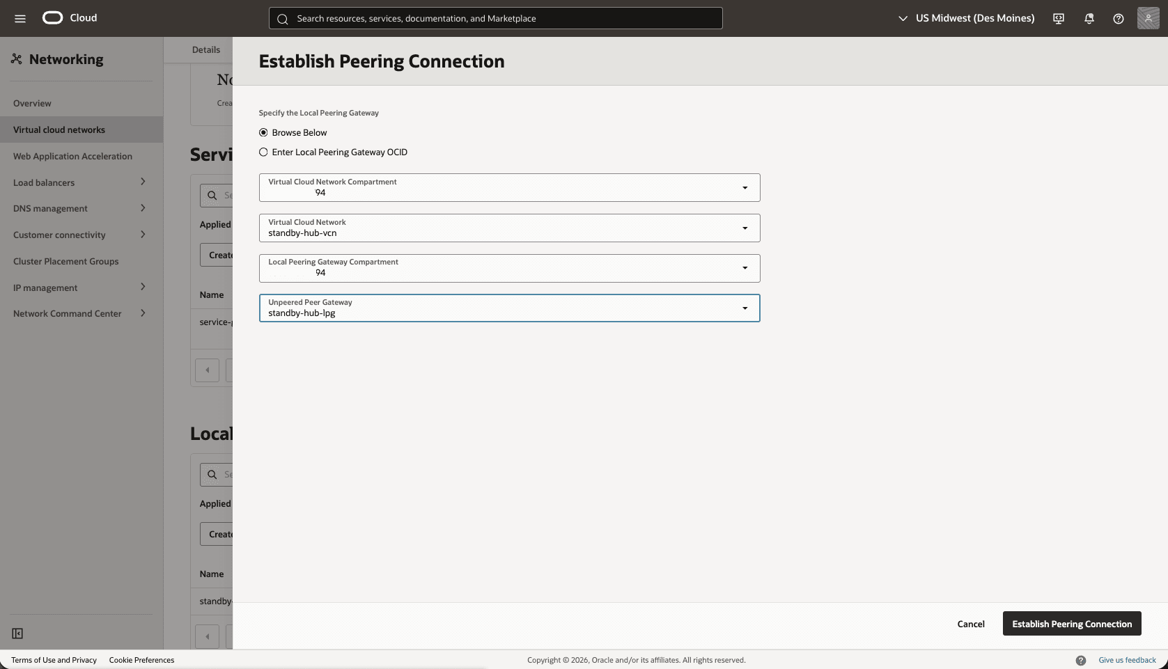

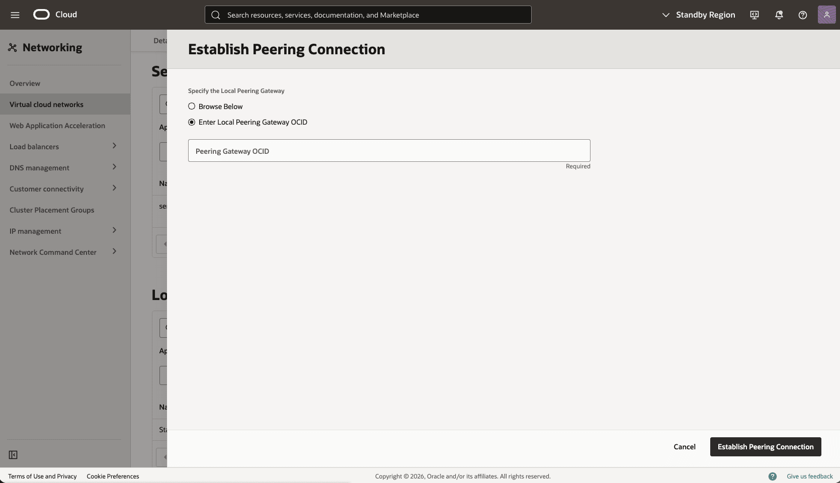

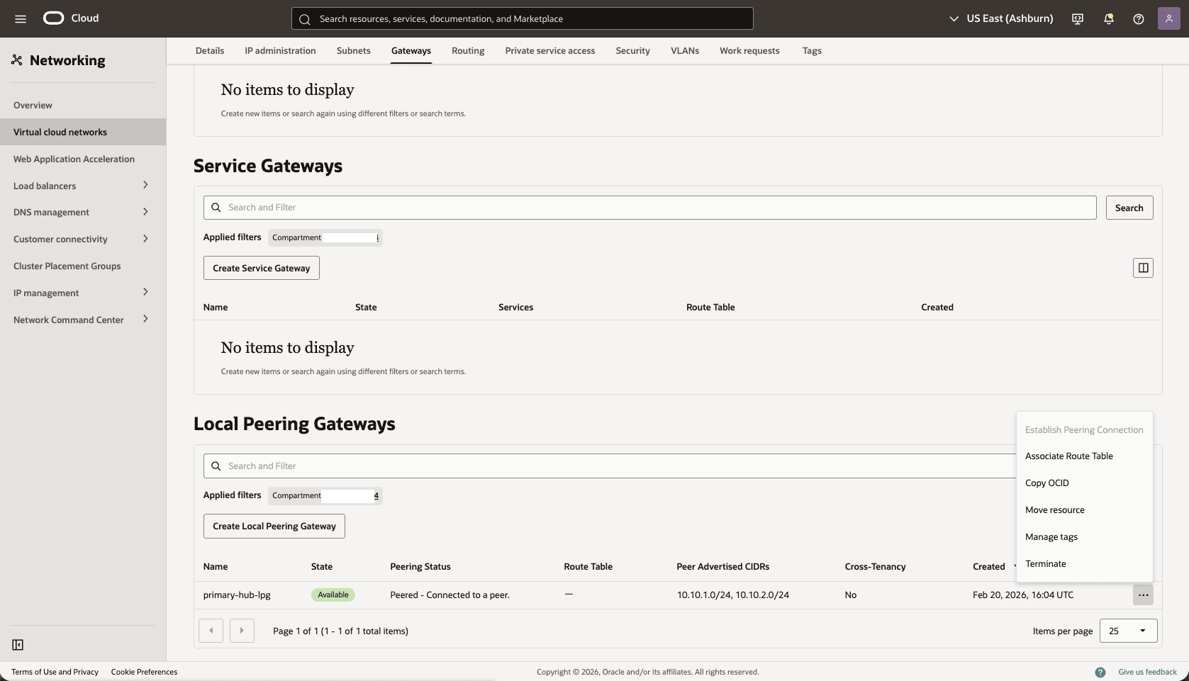

    3. Establish a peering connection between the Standby LPG and the primary LPG OCID.
      1. In the Local Peering Gateways section, identify the LPG created in the previous step, select the three dots, then select the Establish Peering Connection option. This screenshot shows how to configure the network in the primary zone.
      2. Select the Enter Local Peering Gateway OCID option, paste the Primary LPG OCID that you copied in the previous step, and then select the Establish Peering Connection button. This screenshot shows how to configure the network in the primary zone.

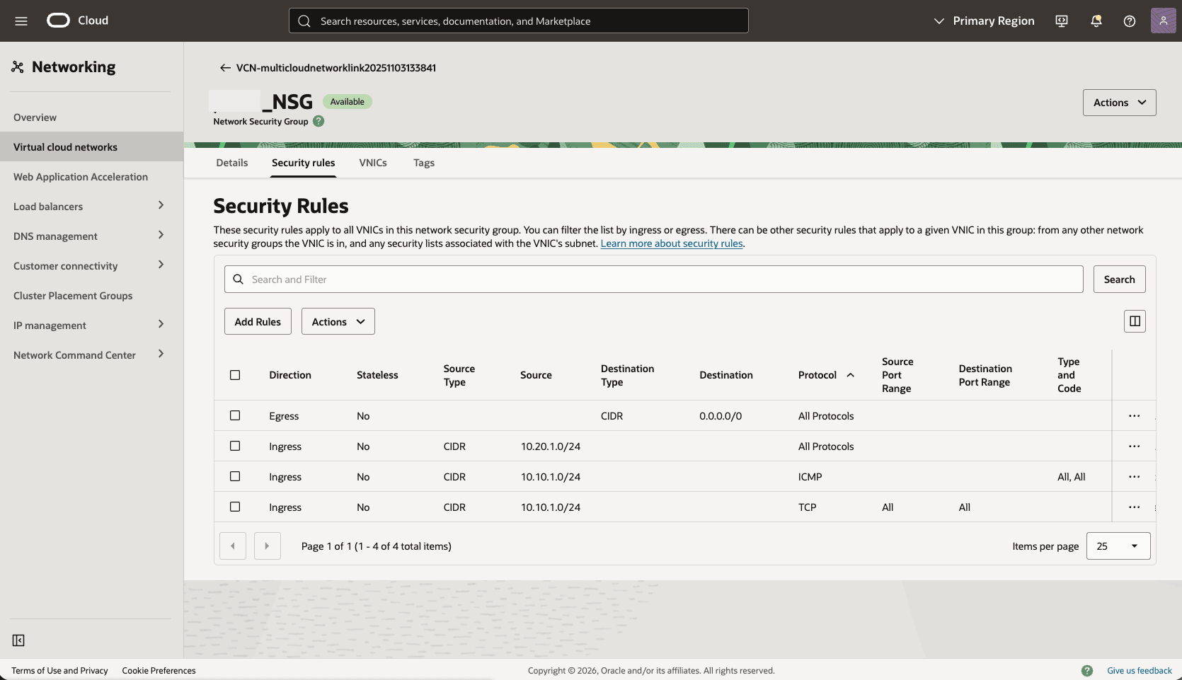

    4. Update the OCI network security group for your standby VM cluster to allow traffic from the primary network.
      1. In the standby Virtual Cloud Networks detail page, select the Security tab, scroll down to the Network Security Groups section, and then select the name of your VM Cluster Network Security Groups.
      2. Select the Security rules tab, select the Add Rules button, and then create a rule with the following specifications.
        3. Source CIDR: Enter your standby CIDR block. For example: 10.10.1.0/24.
        4. IP Protocol: TCP
        7. Description: Enter a description for this rule.
        This screenshot shows how to configure the network in the primary zone. This screenshot shows how to configure the network in the primary zone.

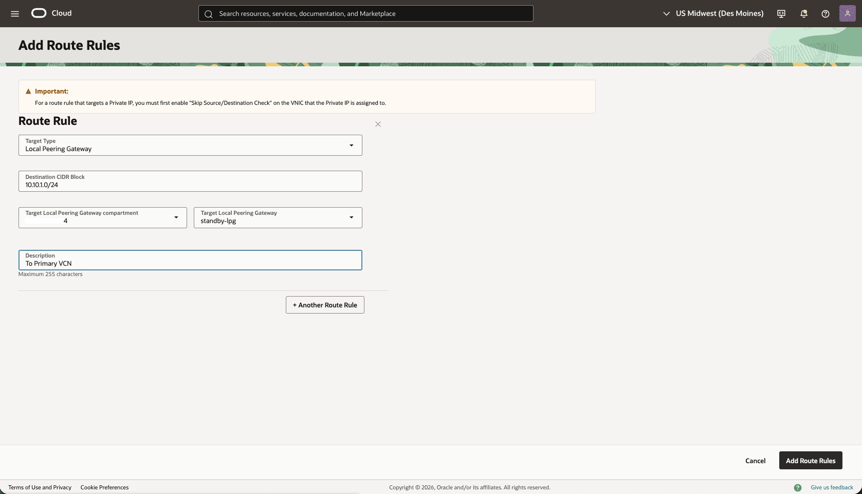

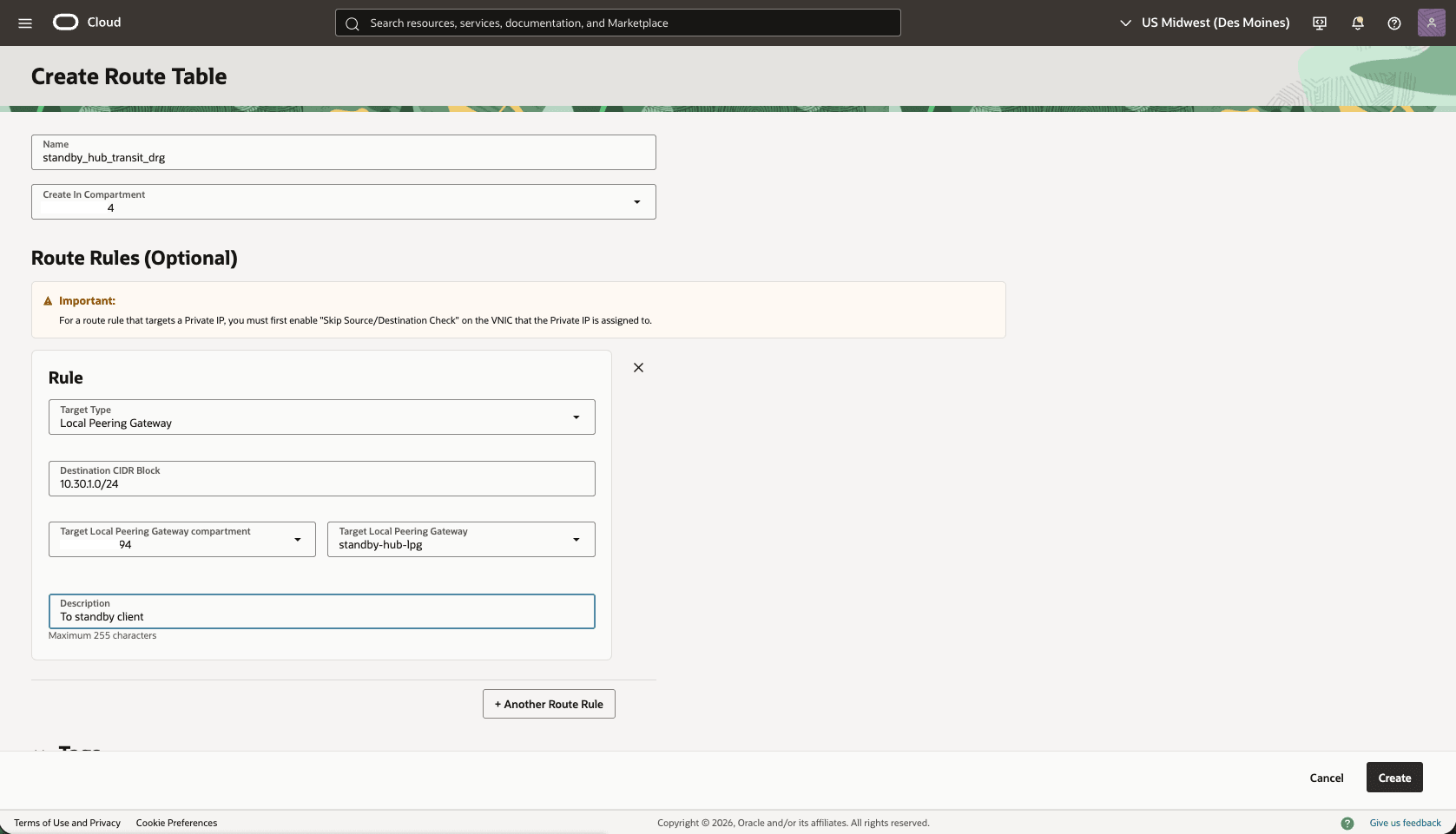

    5. Add a route rule to the default route table in the standby VCN to route primary traffic to Stanby-LPG.
      1. In the Standby Virtual Cloud Networks detail page, select the Routing tab, and then select the name of your default route table.
        2. Destination CIDR Block: Enter your standby CIDR block. For example: 10.10.1.0/24.
        3. Target Local Peering Gateway Compartment: Select the compartment where you created the local peering gateway in the previous step

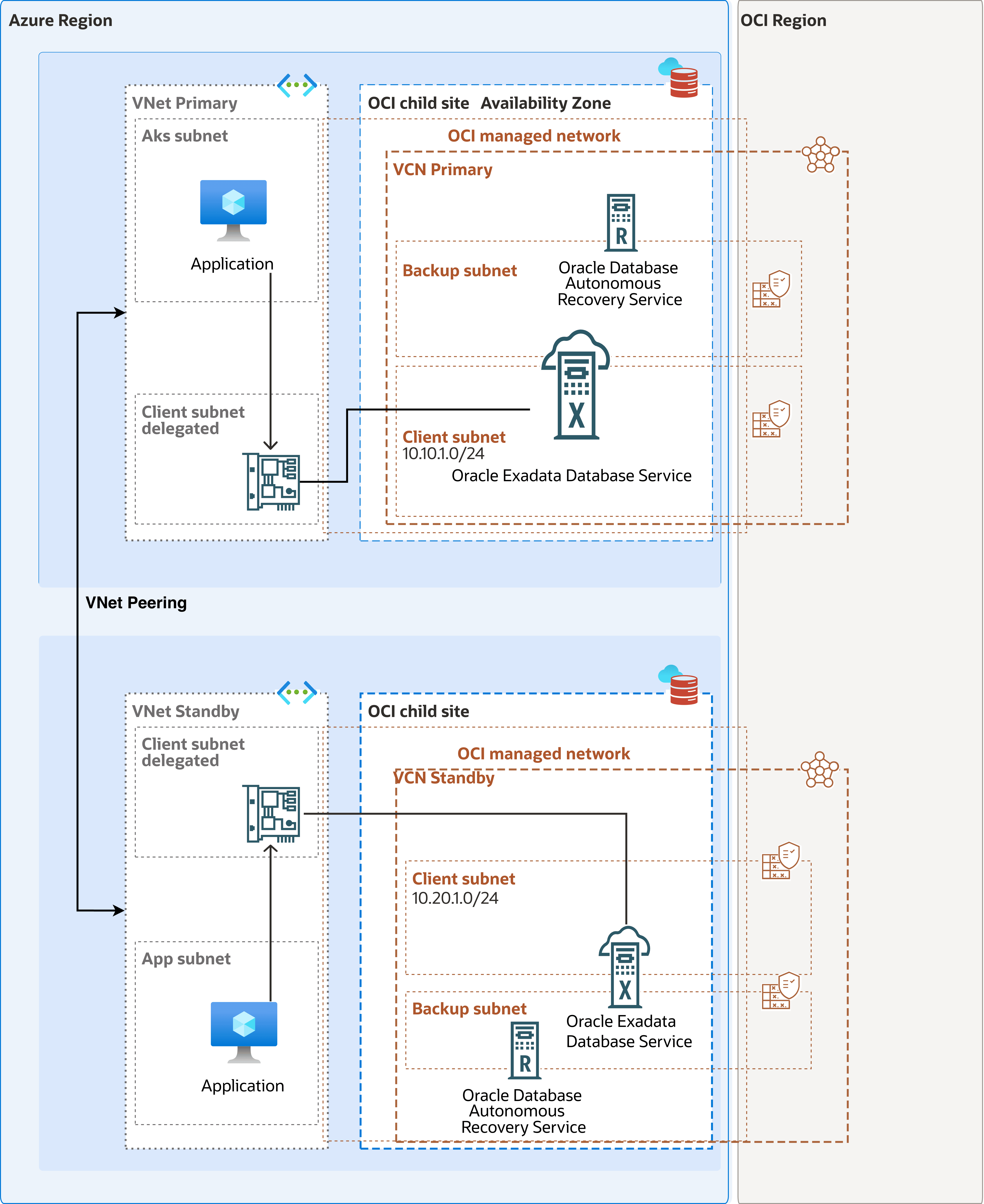

    The following diagram illustrates the architecture diagram for configuring cross-AZ by Azure network.

      3. OCI Network Security Rules
        From the Oracle AI Database@Azure resources, navigate to the Go to OCI link to open the primary and standby database in the OCI Console. Identify the VCN, database client subnet, and network security group (NSG) that each database network uses. Add the required rules to the NSG attached to each database network.
        Use stateful rules unless your environment requires stateless rules. If you use stateless rules, add the corresponding return-path rules for the ephemeral response ports that your security design requires.
        1. OCI Primary Database Network NSG
          1. Create an ingress rule by using the following values:
            Field Value
            Direction Ingress
            Source type CIDR
            Source CIDR 10.20.1.0/24
            IP protocol TCP
            Source port range All
            Destination port range 1521
            Stateless No
            Description allow-dg-from-standby
          2. Create an egress rule by using the following values:
            Field Value
            Direction Egress
            Destination type CIDR
            Destination CIDR 10.20.1.0/24
            IP protocol TCP
            Stateless No
            Description allow-dg-to-standby
        2. OCI Standby Database Network NSG
            Field Value
            Direction Ingress
            Source type CIDR
            Source CIDR 10.10.1.0/24
            IP protocol TCP
            Stateless No
            Description allow-dg-from-primary
            Field Value
            Direction
            Egress
            Destination type
            CIDR
            Destination CIDR
            10.10.1.0/24
            IP protocol
            TCP
            Source port range
            All
            1521
            Stateless
            No
            Description
            allow-dg-to-primary
      If the database uses TCPS or custom listener ports, add separate rules for those ports. Common TCPS deployments use TCP port 2484.
      This screenshot shows how to create security rules. This screenshot shows how to create security rules.

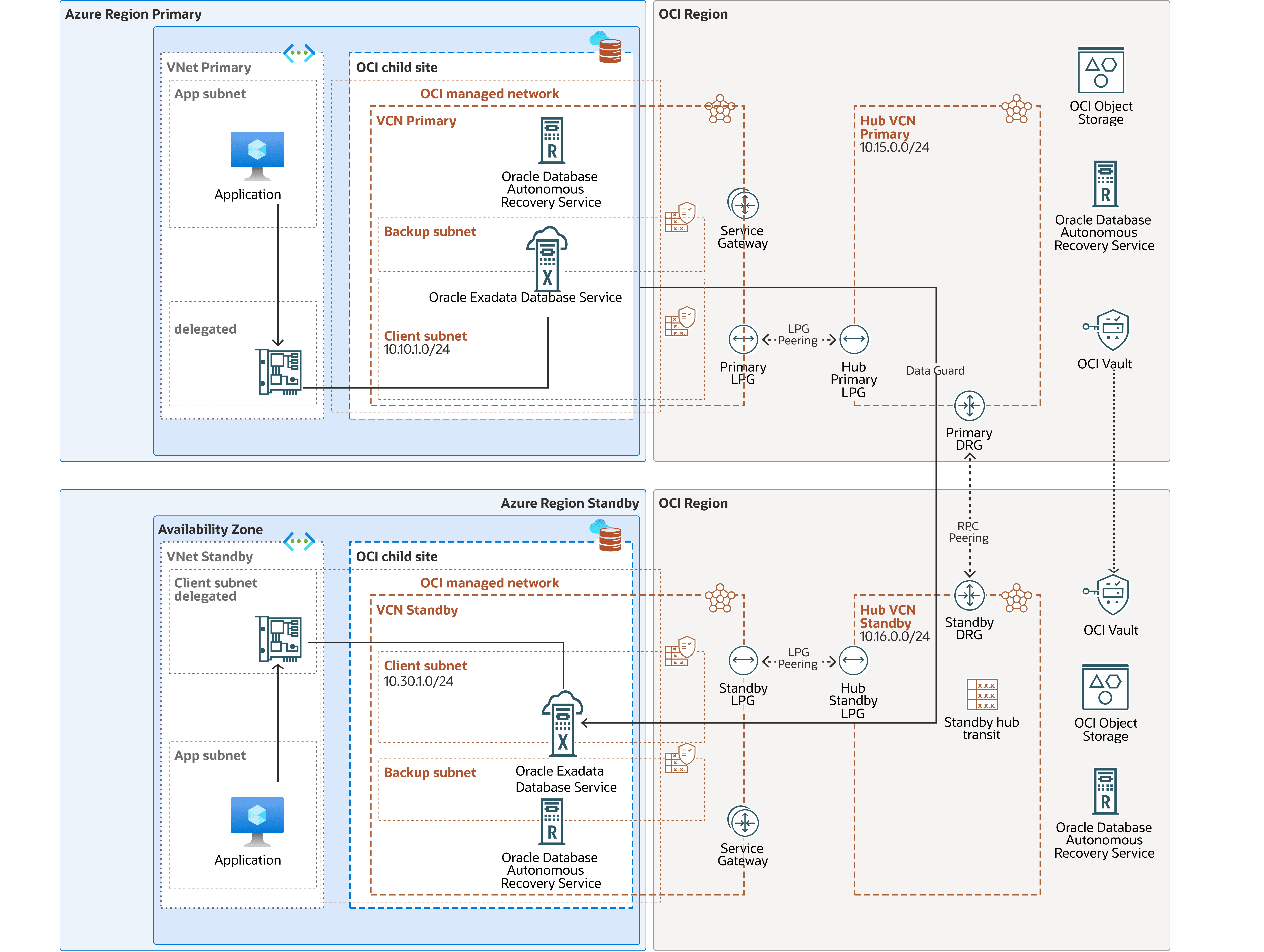

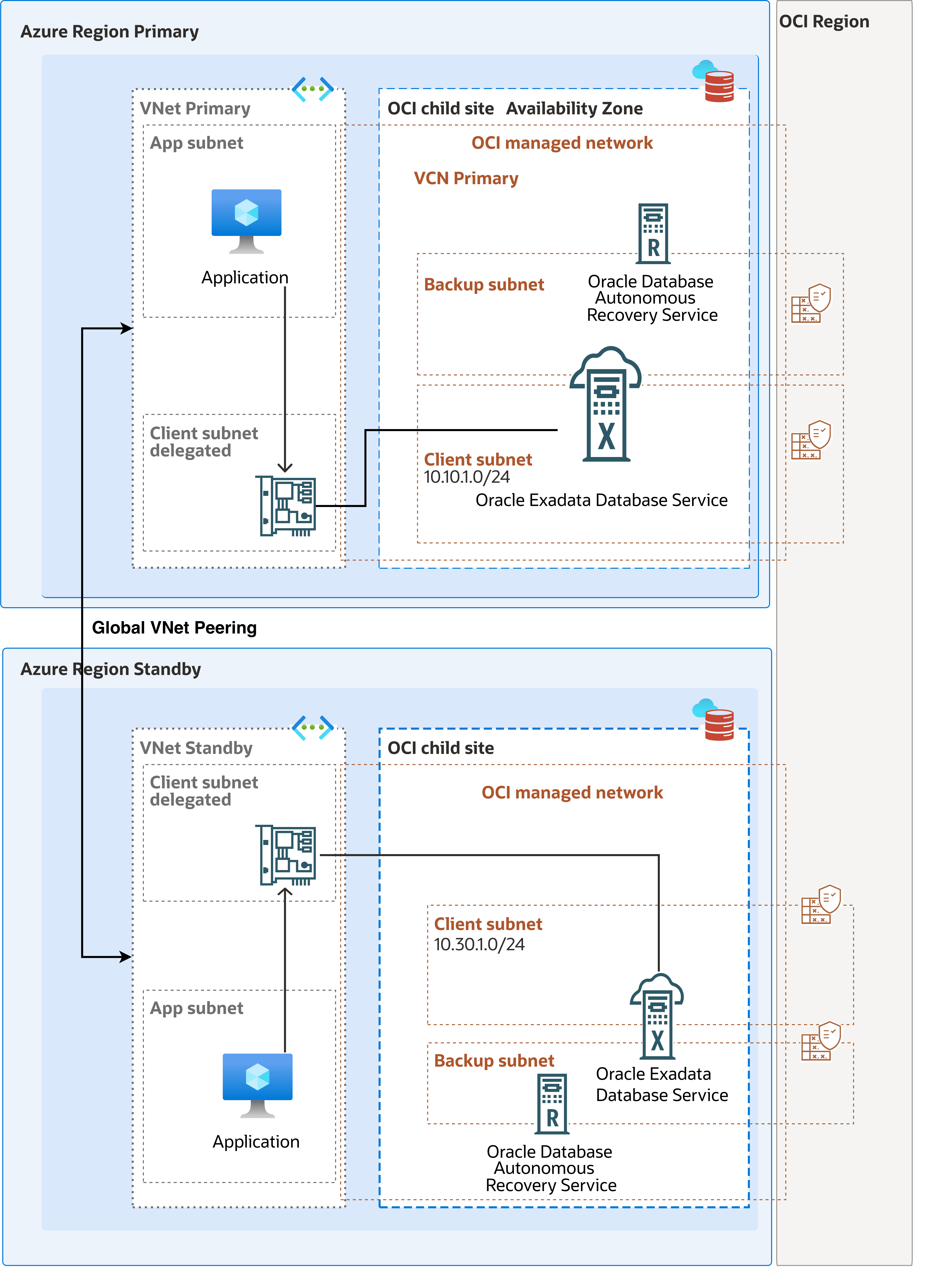

  • Connectivity by OCI Network
    The following diagram illustrates this architecture for configuring cross-region by OCI network.
    This architecture directs primary-to-standby network traffic through the OCI network to improve network throughput. OCI creates the VCNs automatically after Oracle AI Database@Azure creates the deployments for the primary and standby databases.
    • The primary Exadata VM Cluster is deployed in the primary region in Primary VCN and the client subnet CIDR 10.10.1.0/24.
    • Primary Hub VCN 10.15.0.0/24.
    • The standby Exadata VM Cluster is deployed in the standby region in Standby VCN and the client subnet CIDR 10.30.1.0/24.
    • Standby Hub VCN 10.16.0.0/24.
          <div class="infoboxnote" markdown="1">
          **Note:**
          - Download the diagram and update the diagram with your CIDR values.
          - Review the Remote Peering Connection Count service limit, and request a service limit increase if needed.
          - Plan the hub VCN CIDR to avoid overlapping IP addresses. The hub VCN CIDR can be small, for example,`/28`.
          - If you plan to deploy resources in the subnet, define the CIDR accordingly, for example, compute for Data Guard Far Sync.
          </div>

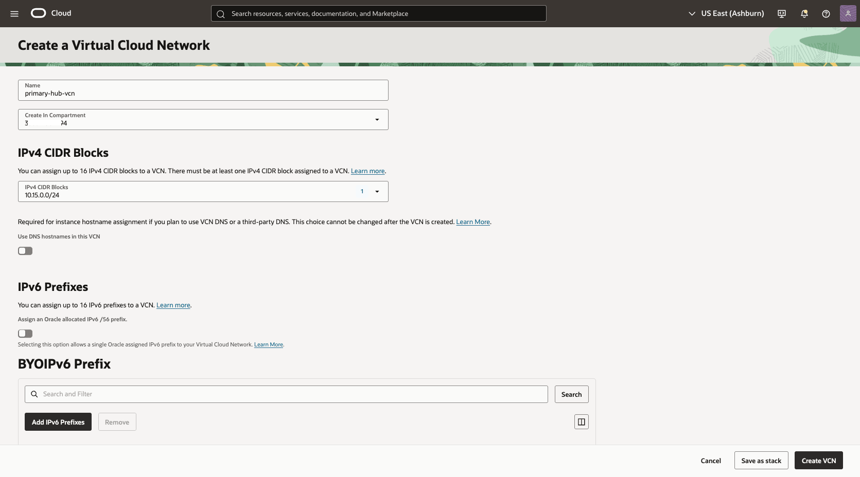

    1. From the OCI console, navigate to Networking, and create a Virtual Cloud Network (VCN) of the primary region (HUB VCN Primary).
      1. From the OCI console, select Networking, and then select Virtual cloud networks.
      2. Select Create VCN button, and enter the following information.
        1. Name: Enter a descriptive name. For example, primary-hub-vcn.
        2. Create in compartment: Select the compartment where you want to create the VCN.
        3. IPv4 CIDR Blocks: Enter the CIDR block for your Hub VCN. Ensure that this block does not overlap with your existing network address space.
        4. Select the Create VCN button.
        This screenshot shows how to configure the network in the primary region.
    2. Deploy two local peering gateways (LPGs), Primary-Hub-LPG and Primary-LPG, in the primary hub VCN and the primary VCN, respectively.
      1. In the Primary-Hub VCN detail page, select the Gateways tab, scroll down to the Local Peering Gateways section, and then select the Create Local Peering Gateway button.
      2. Select a name. For example: primary-hub-lpg. This screenshot shows how to configure the network in the primary region.
      4. In the Primary-Hub VCN detail page, select the Gateways tab, scroll down to the Local Peering Gateways section, and then select the Create Local Peering Gateway button.
      5. Select a name. For example: primary-lpg.
      6. Select the Create Local Peering Gateway button.
    3. Establish an LPG peering connection between the LPGs in the primary hub VCN and the primary VCN.
      1. In your Primary VM Cluster VCN, select the Gateways tab and select Local Peering Gateways. Locate the LPG that you created in the previous step. Select the three dots, and then select Establish Peering Connection option. This screenshot shows how to configure the network in the primary region.
      2. From the Establish Peering Connection page, select the Browse Below option, select the HUB VCN Primary, select the Primary-Hub-LPG, and then select the Establish Peering Connection button. This screenshot shows how to configure the network in the primary region.

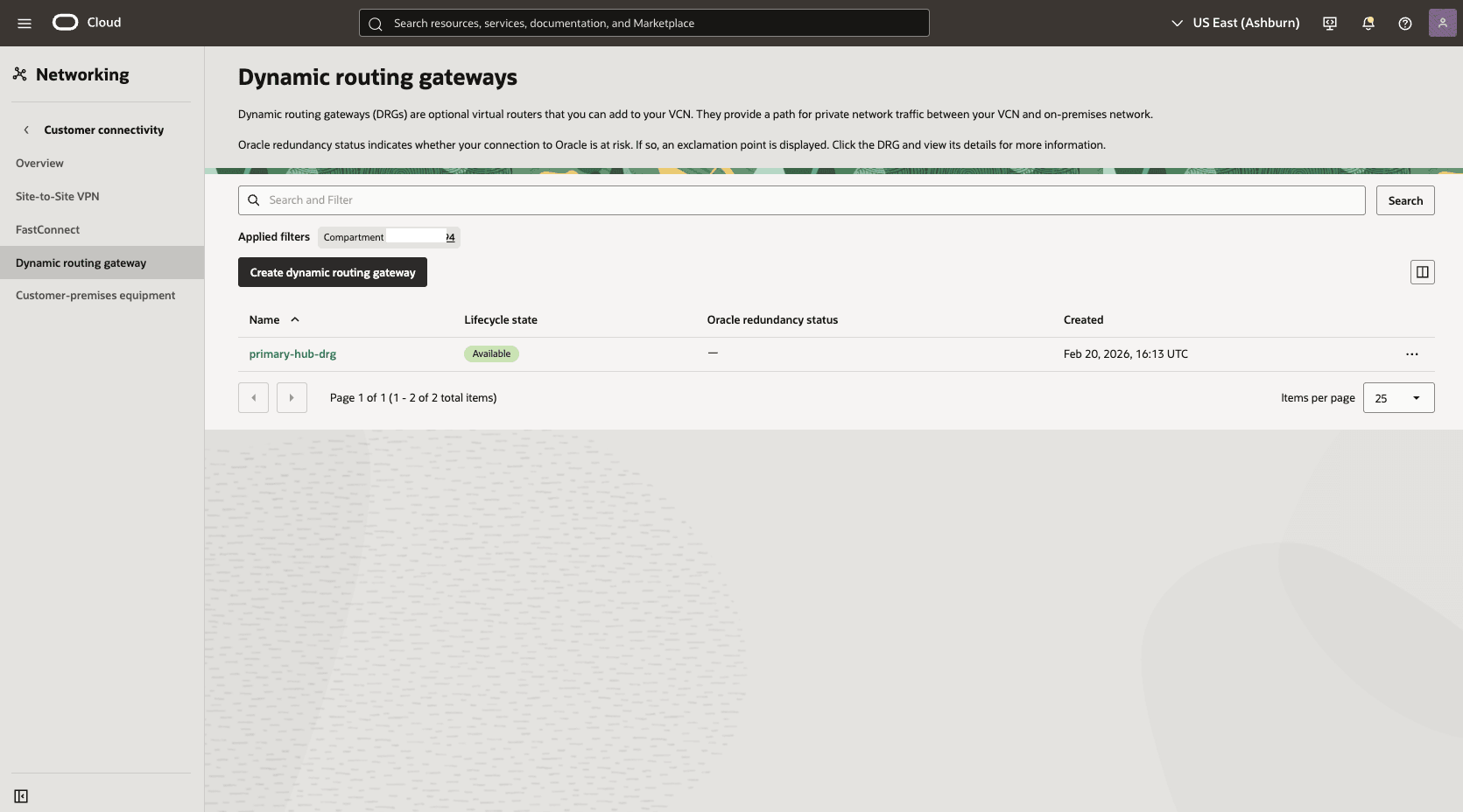

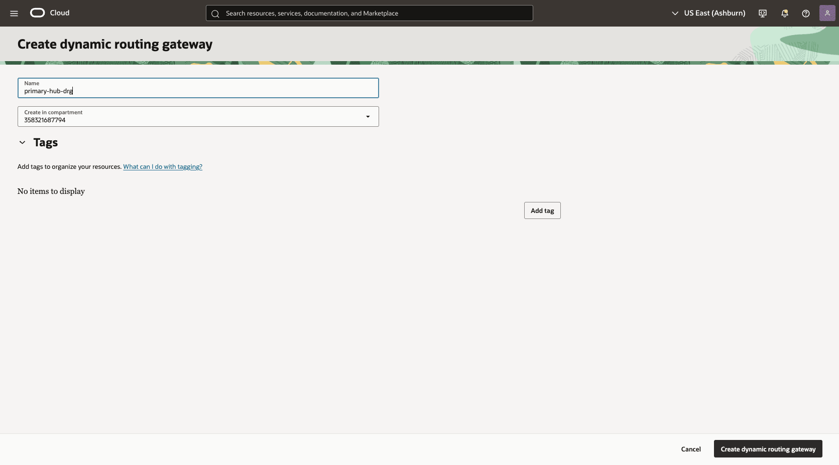

    4. Create a dynamic routing gateway (DRG) named Primary-hub-drg.
      1. From the OCI console, select Networking. Under the Customer connectivity section, select Dynamic routing gateway, and then select Create dynamic routing gateway button.
        1. Select a name. For example, Primary-hub-drg. This screenshot shows how to configure the network in the primary region.
        2. Select the Create dynamic routing gateway button. This screenshot shows how to configure the network in the primary region.

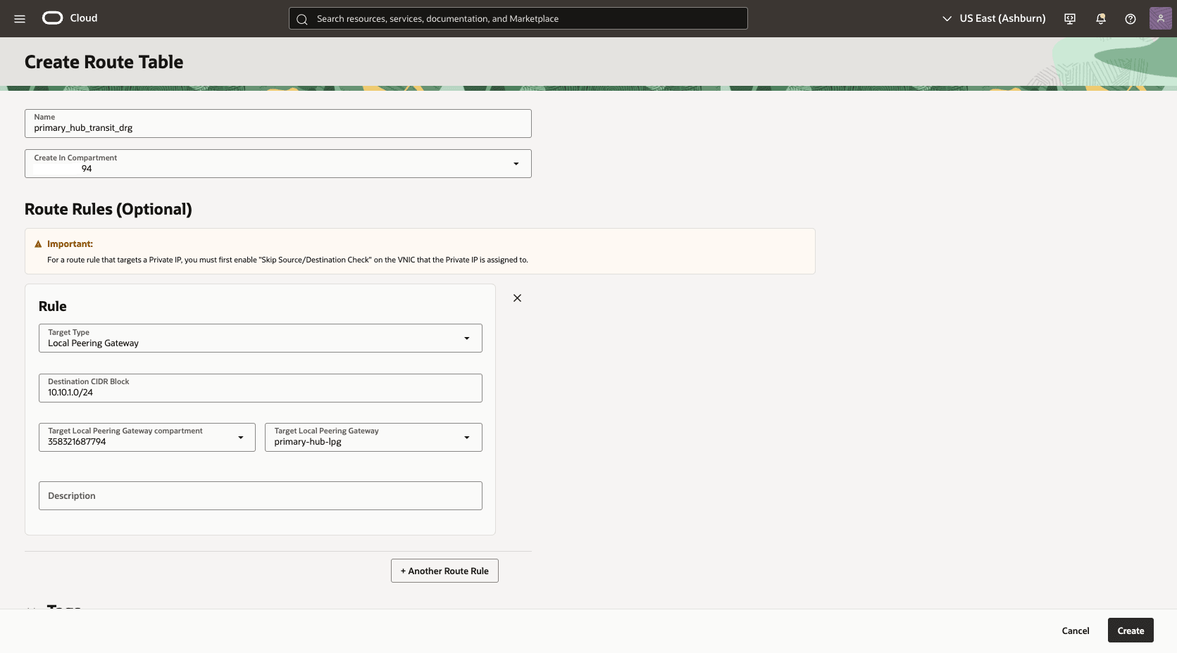

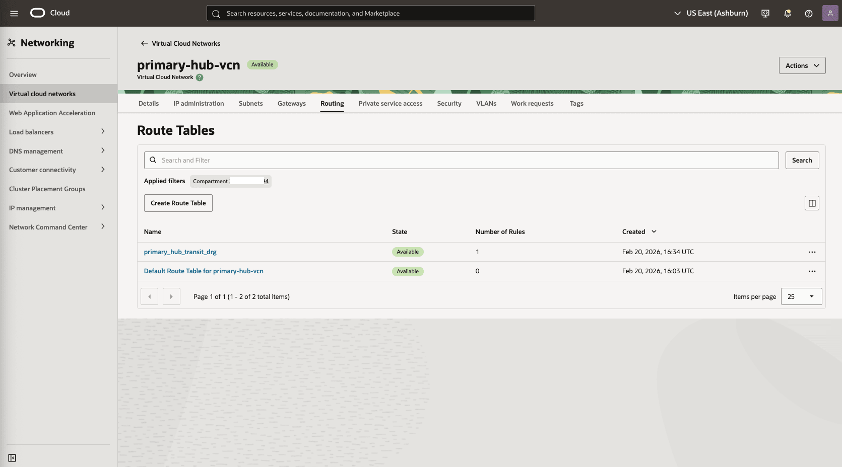

    5. Create a route table in the primary hub VCN to route network traffic between the primary hub VCN and the primary VCN.
      1. From the OCI console, select Networking, select Virtual cloud networks, and then select the HUB VCN Primary VCN. This screenshot shows how to configure the network in the primary region.
      2. Select the Routing tab, and then select the Create Route Table button.
        1. Name: Select a name. For example, primary_hub_transit_drg.
        2. Select the + Another Route Rule button.
        3. Target Type: Local Peering Gateway
        4. Destination CIDR Block: Enter 10.10.1.0/24 in the Primary VM Cluster Client Subnet CIDR field.
        5. Target Local Peering Gateway: Select the LPG of the created in the HUB VCN Primary. For example, primary-hub-lpg.
        6. Description: To primary client subnet.
        7. Select the Create button. This screenshot shows how to configure the network in the primary region.

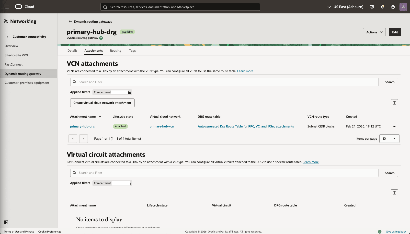

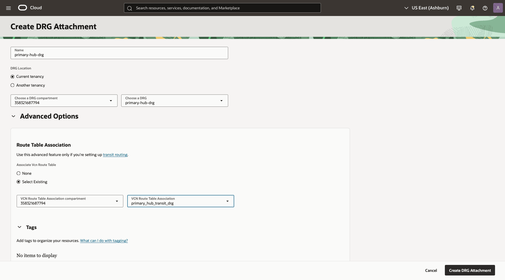

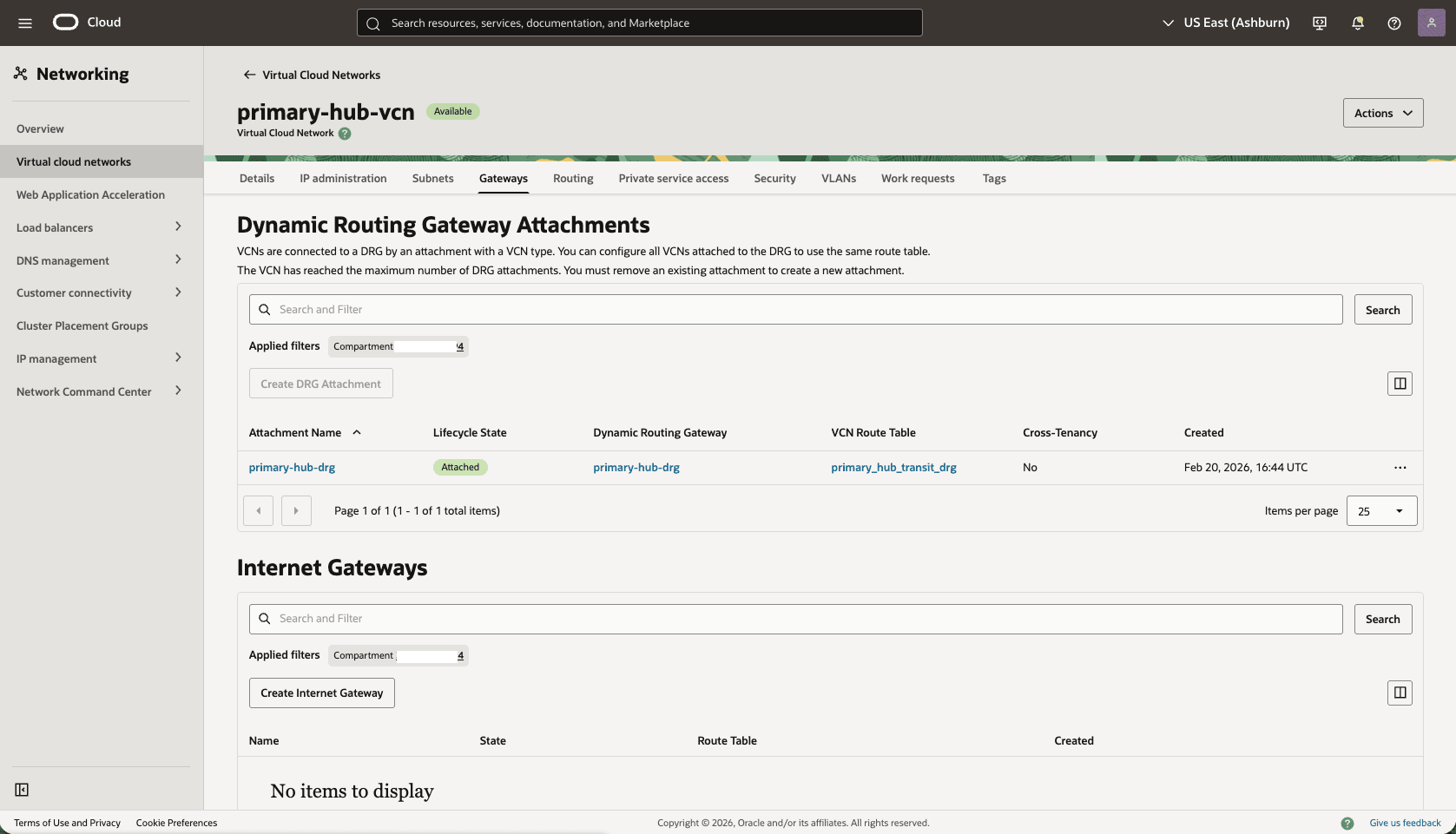

    6. Attach the DRG to the primary hub VCN.
      1. In the Hub VCN Primary VCN section, select the Gateways tab. Under the Dynamic Routing Gateway Attachments section, select the Create DRG Attachment button. This screenshot shows how to configure the network in the primary region.
      2. Name: Select a name. For example, primary-hub-drg.
      3. DRG Location: Select the current tenancy.
      4. Select a DRG: Select the DRG name that you created in the previous step.
      5. The Advanced Options section is optional.
      6. Select the Select Existing option, then select the Routing Table that you created in the previous step. For example, primary_hub_transit_drg. This screenshot shows how to configure the network in the primary region.
      7. Select the Create DRG Attachment button.

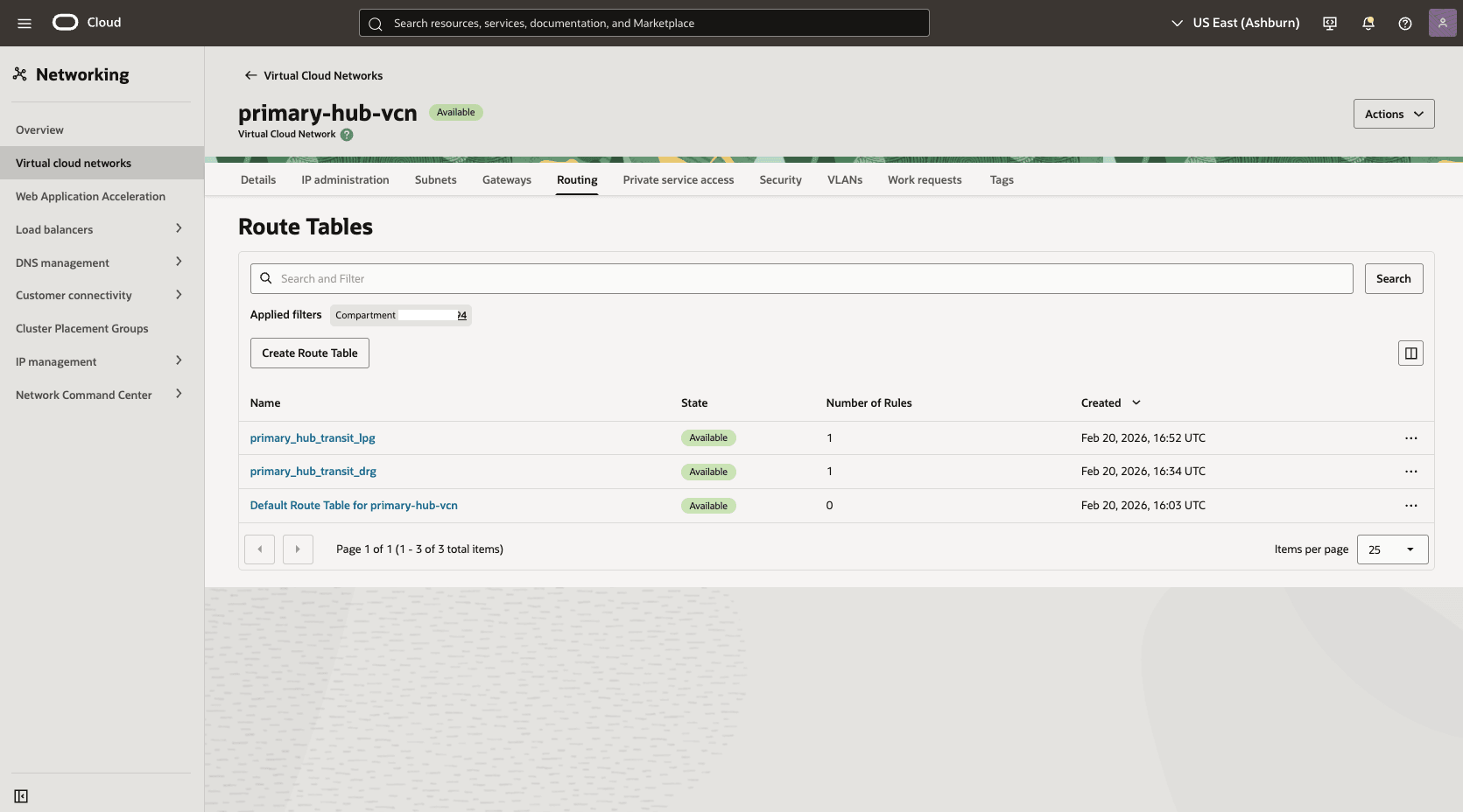

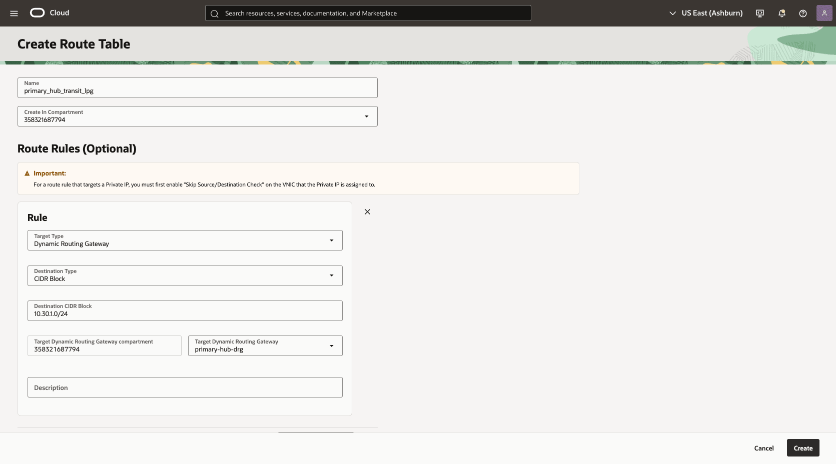

    7. In the primary hub VCN, create a second route table to direct network traffic to the standby network.
      1. From the HUB VCN Primary VCN, select the Routing tab, then select the Create Route Table button.
      2. Name: Select a name. For example, primary_hub_transit_lpg.
      3. Select the + Another Route Rule button.
      4. Target Type: Dynamic Routing Gateway
      5. Destination CIDR Block: Enter the VCN Standby client subnet CIDR. For example, 10.30.1.0/24.
      6. Target Dynamic Routing Gateway: Select the DRG associated with the HUB VCN Primary For example, primary-hub-drg.
      7. Description: To standby client subnet.
      8. Select the Create button. This screenshot shows how to configure the network in the primary region.

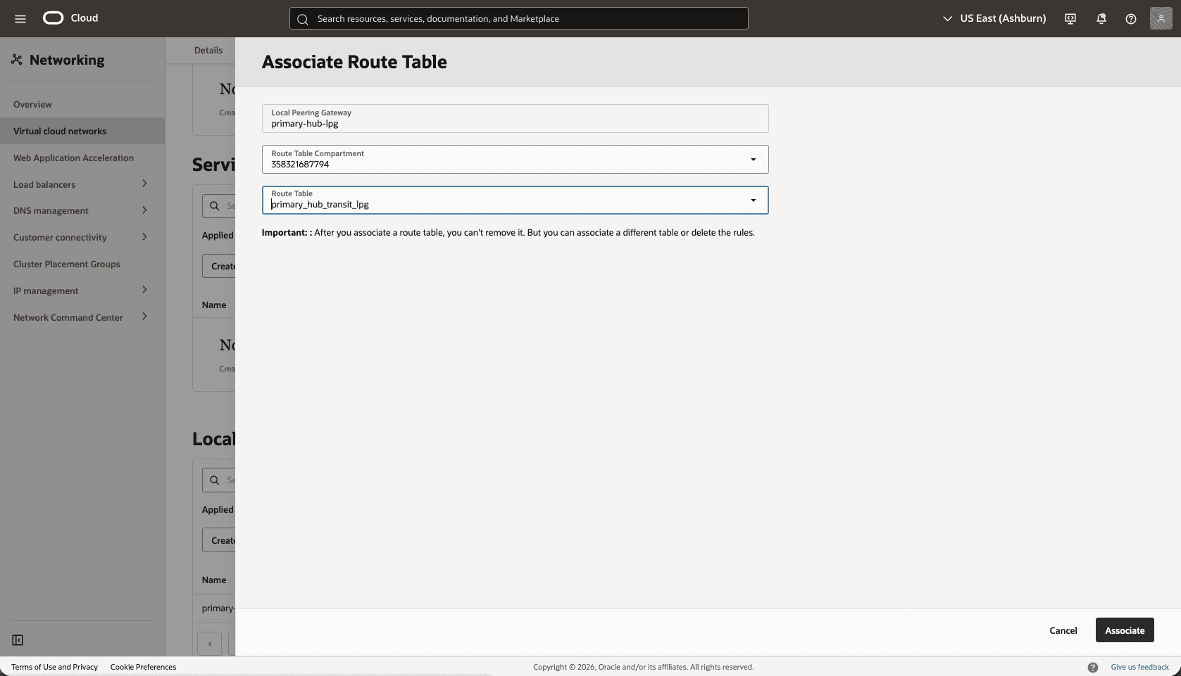

    8. Associate the primary_hub_transit_lpg route table to the Hub-Primary-LPG gateway.
      1. From the Hub VCN Primary VCN, select the Gateways tab, scroll down to the Local Peering Gateways section. This screenshot shows how to configure the network in the primary region.
      2. Select the three dots, then select the Associate Route Table option.
      3. Select the route table that you created for the Local Peering Gateway. For example, primary_hub_transit_lpg. This screenshot shows how to configure the network in the primary region.
      4. Select the Associate button. This screenshot shows how to configure the network in the primary region.

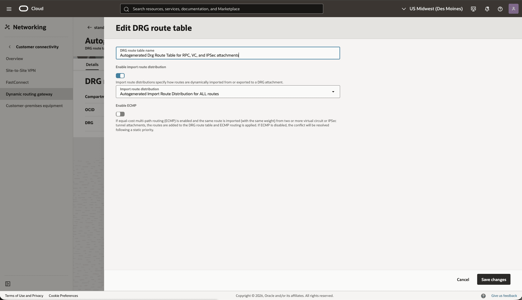

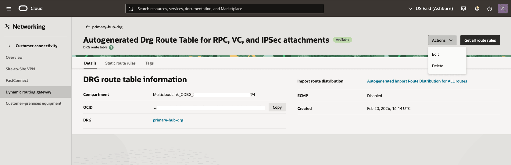

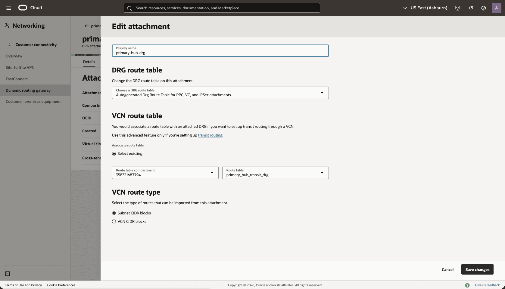

    9. Edit the Primary-Hub-DRG attachment from the Primary-Hub-VCN to update the DRG route table.
      1. From the Hub VCN Primary VCN, select the Gateways tab. Under the Dynamic Routing Gateway Attachments section, select the name of your DRG attachment. This screenshot shows how to configure the network in the primary region.
      2. Select the Edit button.
      3. In the DRG route table, select Autogenerated Drg Route Table for RPC, VC, and IPSec attachments. This screenshot shows how to configure the network in the primary region.
      4. Select the Save changes button.

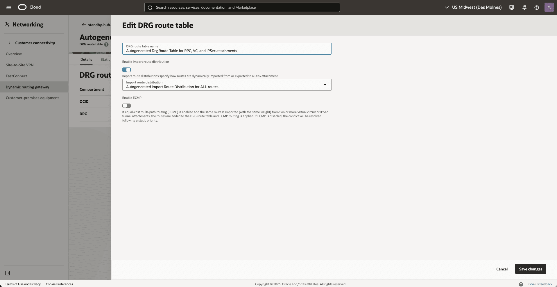

    10. Validate the DRG route table options.
      1. From the Dynamic Routing Gateway section, select the Attachments tab. In the VCN attachments section, under DRG route table column, select Autogenerated Drg Route Table for RPC, VC, and IPSec attachments. This screenshot shows how to configure the network in the primary region.
      2. Select the Actions button, then select the Edit option. This screenshot shows how to configure the network in the primary region.
      3. Make sure that the Enable import route distribution option is enabled and Import route distribution is set to Autogenerated Import Route Distribution for ALL routes. This screenshot shows how to configure the network in the primary region.
      4. Select the Save changes option.
      Note
      • For a more precise configuration, disable the import route distribution of the Autogenerated DRG Route Table for RPC, VC, and IPSec attachments route table.
      • For Autogenerated DRG Route Table for VCN attachments, create and assign a new import route distribution including only the required RPC attachment.

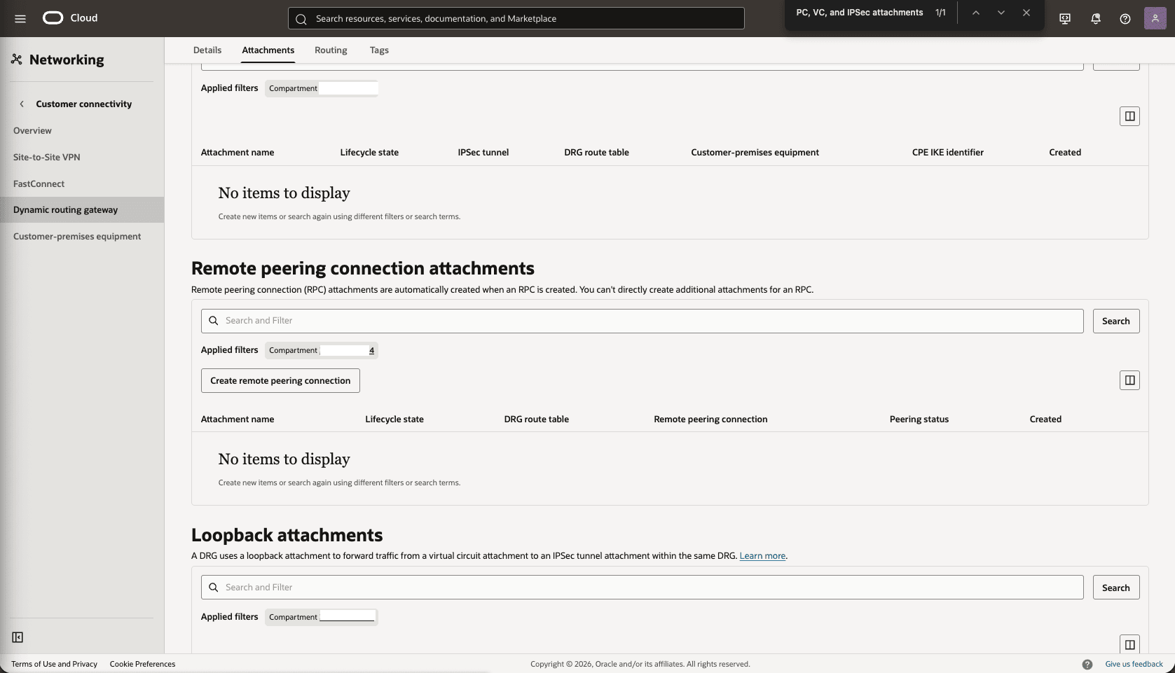

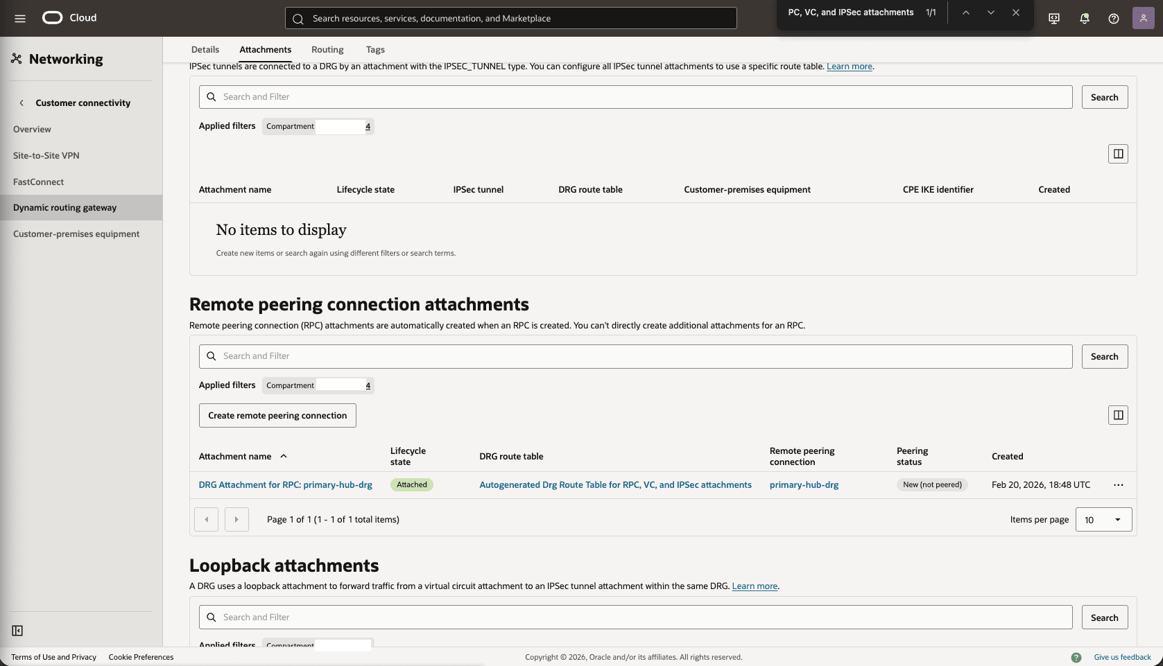

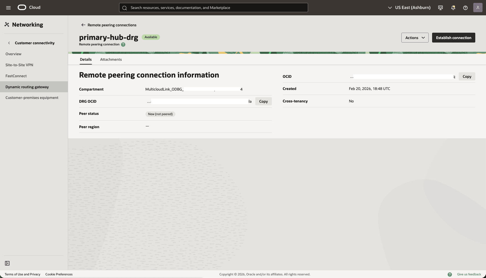

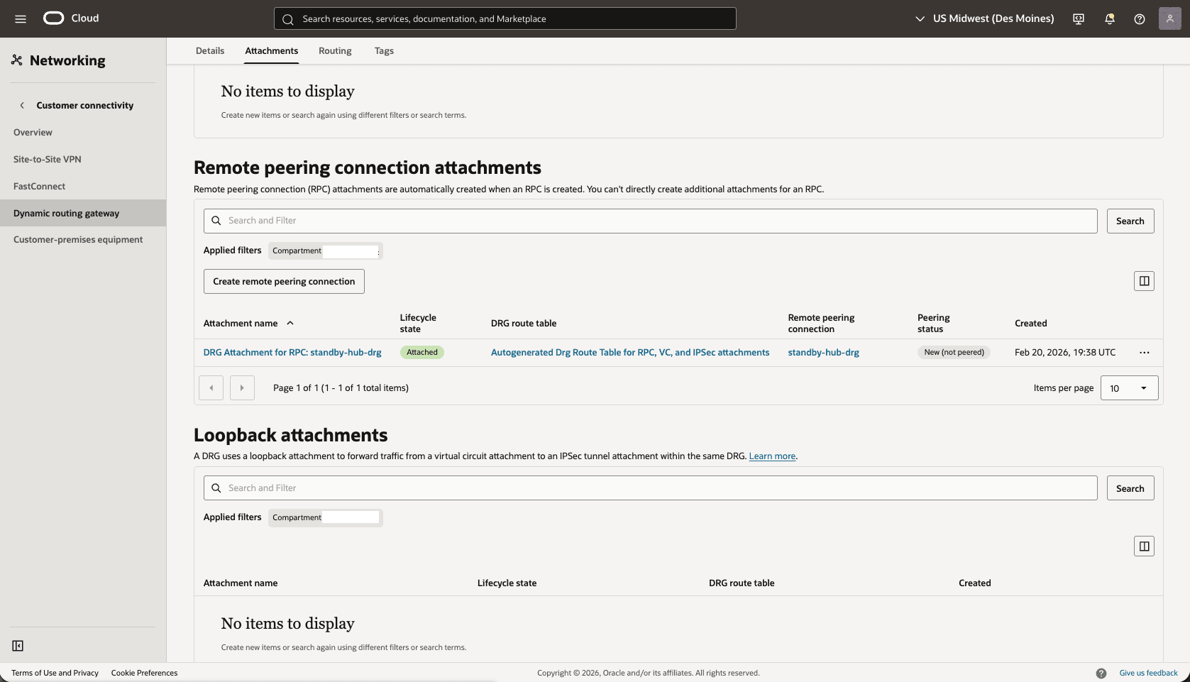

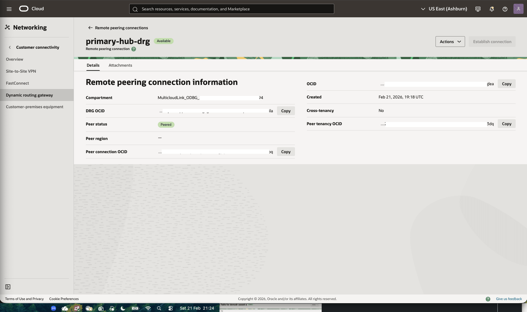

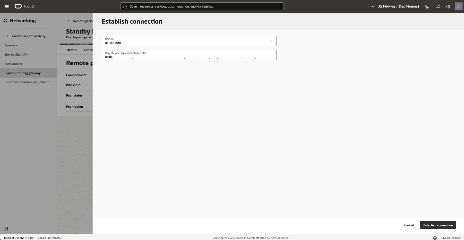

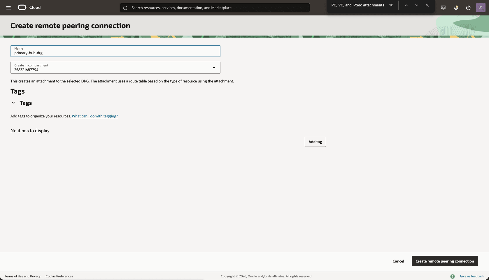

    11. From the Primary-Hub-DRG, create a remote peering connection attachments.
      1. From the Network section, in the Dynamic routing gateway page, select the Attachments tab, scroll down to the Remote peering connection attachments section, select the Create remote peering connection button. This screenshot shows how to configure the network in the primary region.
      2. Select a name. For example, primary-hub-drg. This screenshot shows how to configure the network in the primary region.
      3. Select the Create remote peering connection button. This screenshot shows how to configure the network in the primary region.
      4. Select the remote peering connection primary-hub-drg that you created in the previous step, and take note of the OCID. This screenshot shows how to configure the network in the primary region.

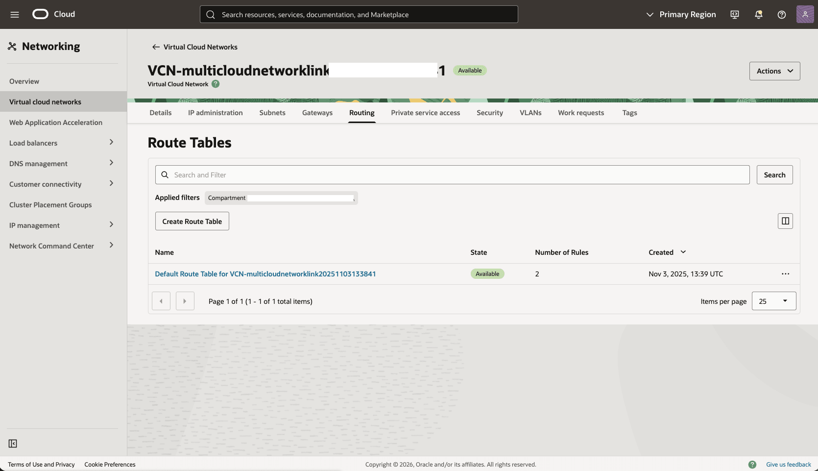

    12. Update the primary VCN Default Route Table. Add a route rule for the Standby VCN Client Subnet CIDR range.
      1. From your Primary VM cluster VCN, select the Routing tab, then select the name of the Default Route table.
      2. Select the Route Rules tab, then select Add Route Rules button.
      4. Destination CIDR Block: select the standby VCN client subnet CIDR. For example, 10.30.1.0/24.
      5. Target Local Peering Gateway: select your LPG. For example, primary-vcn-lpg.
      6. Description: Enter a description. This screenshot shows how to configure the network in the primary region.
      7. Select the Add Route Rules button. This screenshot shows how to configure the network in the primary region.

    14. Update the OCI network security group (NSG) of your primary VM cluster VCN to allow traffic from the standby network.
      1. In the Virtual Cloud Networks detail page of the primary VCN (10.10.10.0/24), select the Security tab, scroll down to the Network Security Groups section, then select the name of your VM Cluster Network Security Groups.
      2. Select the Security rules tab, select the Add Rules button, then create a rule with the following specifications.
        3. Source CIDR: Enter your standby CIDR block. For example, 10.30.1.0/24.
        4. IP Protocol: TCP
        9. Optionally, you can add SSH port 22 to SSH the standby VM Cluster.

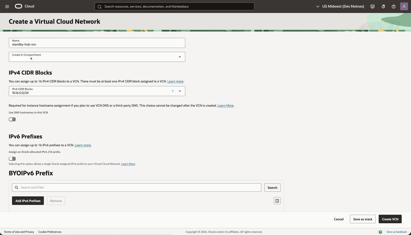

    1. From the OCI console, in the Networking menu, create a Virtual Cloud Network (VCN) of the standby region (HUB VCN Standby).
      1. From the OCI console, select Networking, then select Virtual cloud networks. Select Create VCN button and enter the following information.
        1. Name: Select a name. For example, standby-hub-vcn.
        2. Create In compartment: Select the compartment that you want to create the VCN.
        3. Enter the CIDR block for your Hub VCN. Ensure that this block does not overlap with your existing network address space.
        This screenshot shows how to configure the network in the standby region.
    2. Deploy two local peering gateways (LPGs), Standby-Hub-LPG and Standby-LPG, in the standby hub VCN and the standby VCN, respectively.
      1. In the Standby-Hub VCN detail page, select the Gateways tab, scroll down to the Local Peering Gateways section, and then select the Create Local Peering Gateway button.
      2. Select a name. For example, standby-hub-lpg. Then select the Create Local Peering Gateway button. This screenshot shows how to configure the network in the standby region.
      3. In the Standby VM cluster VCN detail page, select the Gateways tab, scroll down to the Local Peering Gateways section, then select the Create Local Peering Gateway button.
      4. Select a name. For example, standby-lpg. Then, select the Create Local Peering Gateway button. This screenshot shows how to configure the network in the standby region.
    3. Establish a peer LPG connection between LPGs for VCN Standby and HUB VCN Standby.
      1. In your Standby VM Cluster VCN, select the Gateways tab, and then select Local Peering Gateways. Locate the LPG that you created in the previous step. Select the three dots, and then select Establish Peering.
      2. Select the Browse Below option, select the Standby-Hub VCN, Standby-Hub-LPG, and then select the Establish Peering Connection button. This screenshot shows how to configure the network in the standby region.

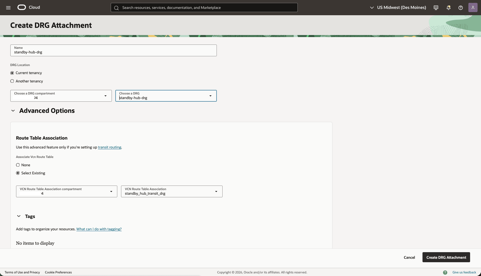

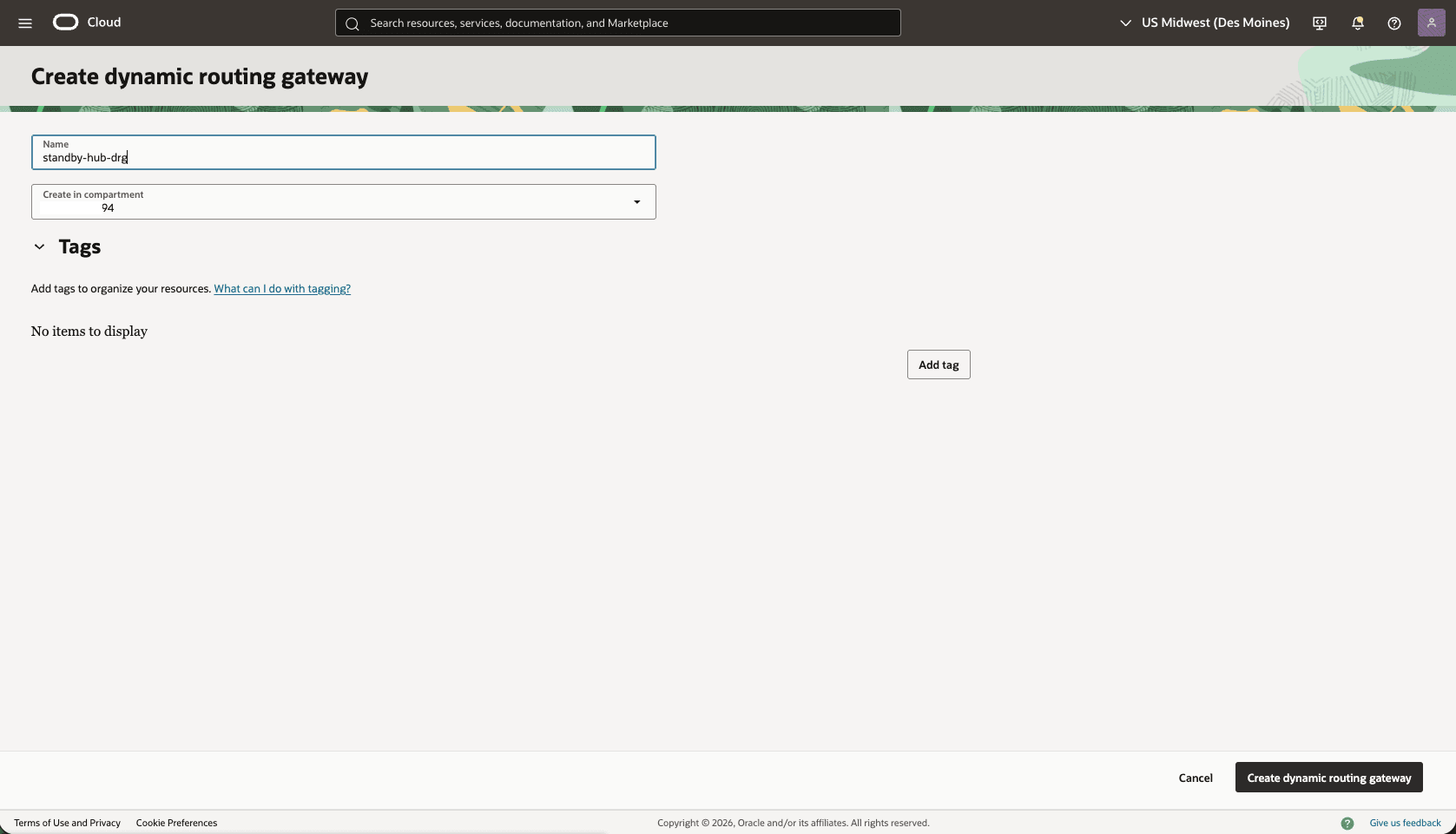

    4. Create a dynamic routing gateway (DRG) named Stanby-hub-drg.
        1. Select a name. For example, standby-hub-drg.

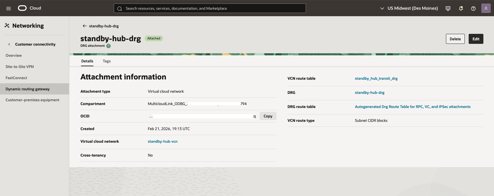

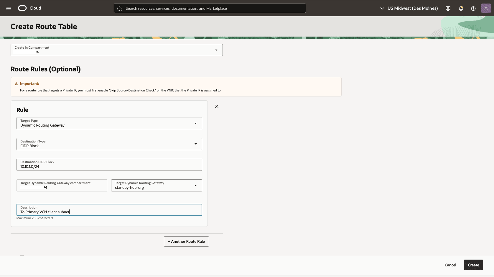

    5. Create a route table in the HUB VCN Standby VCN, to route the network traffic between the HUB VCN Standby and VCN Standby.
      1. From the OCI console, select Networking, select Virtual cloud networks, then select the HUB VCN Standby VCN.
      2. Select the Routing tab, then select the Create Route Table button.
        1. Name: Select a name. For example, standby_hub_transit_drg.
        4. Destination CIDR Block: Enter the Standby VM Cluster Client Subnet CIDR. For example, 10.30.1.0/24.
        5. Target Local Peering Gateway: Select the LPG of the created in the HUB VCN Primary. For example,standby-hub-lpg.

    6. Attach the DRG to the HUB VCN Standby VCN
      1. In the HUB VCN Standby VCN, select the Gateways tab, under Dynamic Routing Gateway Attachments section, select the Create DRG Attachment button.
      2. Name: Select a name. For example, standby-hub-drg.
      6. Select the Select Existing option, then select the Routing Table that you created in the previous step. For example,standby_hub_transit_drg.
    7. In the HUB VCN Standby VCN , create a second Route Table to direct network traffic to the Standby Network.
      1. From the HUB VCN Standby VCN, select the Routing tab, then select the Create Route Table button.
      2. Name: select a name. For example, standby_hub_transit_lpg.
      5. Destination CIDR Block: Enter the VCN Primary client subnet CIDR. For example, 10.10.1.0/24.
      6. Target Dynamic Routing Gateway: Select the DRG associated with the HUB VCN Standby VCN. For example, standby-hub-drg.
      7. Description: To primary VCN client subnet
    8. Associate the standby_hub_transit_lpg route table to the Hub-Standby-LPG gateway.
      2. Select the three dots, then select Associate Route Table option.
      3. Select the Route table that you created for the Local Peering Gateway. For example, standby_hub_transit_lpg.

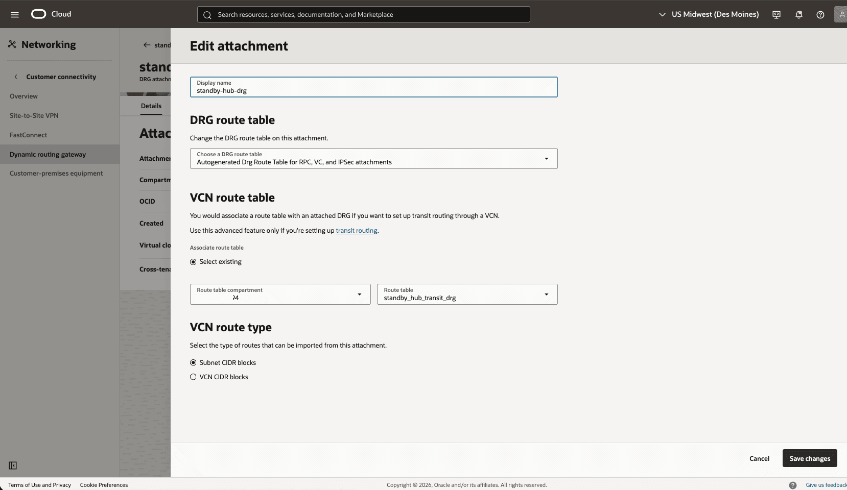

    9. Edit the Standby-Hub-DRG attachment from the Standby-Hub-VCN to add DRG route table.
      1. From the Standby-Hub-VCN , select the Gateways tab, under Dynamic Routing Gateway Attachments section, select the name of your DRG Attachment. This screenshot shows how to configure the network in the standby region.
      1. From Dynamic Routing Gateway, select the Attachments tab, in the VCN attachments section, under the DRG route table column, select Autogenerated Drg Route Table for RPC, VC, and IPSec attachments.
      2. select the Actions button, then select the Edit option.
      Note
    11. From the Standby-Hub-DRG, create a remote peering connection attachments.
      1. From the Dynamic routing gateway page, select the Attachments tab, scroll down to the Remote peering connection attachments section, and select the Create remote peering connection button.
      2. Select a name. For example, standby-hub-drg.
      3. Select the Create remote peering connection button. This screenshot shows how to configure the network in the standby region.
      4. From the Standby-Hub-DRG, scroll down to the Remote peering connection attachments section, under Remote peering connection column, select the remote peering connection. For example, standby-hub-drg. This screenshot shows how to configure the network in the standby region.
      5. Select the Establish Connection button and enter the following information.
        1. Region: Select your primary Region.
        2. Remote peering connection OCID: Provide the Primary-Hub-drg remote peering connection OCID captured before.
        3. Select the Establish connection button.
          Note
          Note: When the peering status becomes peered. Both regions are connected.
    12. Update the Standby VCN Default Route Table, add a route rule to the Primary VCN Client Subnet CIDR range
      1. From your Standby VM cluster VCN, select the Routing tab, then select the name of the Default Route table.
      3. Target Type: Local Peering Gateway.
      4. Destination CIDR Block: Select the standby VCN client subnet CIDR. For example, 10.10.1.0/24).
      5. Target Local Peering Gateway: select your LPG. For example, standby-lpg.
      7. Select the Add Route Rules button. This screenshot shows how to configure the network in the standby region.
      8. In the VCN Standby client subnet, update the NSG to create a security rule to allow ingress for TCP port 1521. Optionally, you can add SSH port 22 for direct SSH access to the database servers. This screenshot shows how to configure the network in the standby region.

  • Connectivity by Azure Network
    Configure the network for Oracle Data Guard between two Oracle AI Database@Azure deployments in different regions: one primary and one standby. This architecture uses Azure Global VNet peering between two Azure virtual networks (VNets). Each VNet is regional and contains one Oracle AI Database@Azure delegated subnet.
    This procedure covers the Azure Portal configuration for cross-region Data Guard network preparation:
    • The deployments must be in the two Azure regions.
    • The deployments must be in two Azure VNets, one per region.
    • One Oracle AI Database@Azure delegated subnet per VNet.
    • The VNet address spaces must not overlap.
    • Advanced networking must be enabled for the delegated subnets.
    Note
      **Note:**
      - Global VNet peering uses Azure backend system routes and avoids the additional routing complexity, availability dependency, and throughput constraints associated with an Azure Firewall or NVA. Route Oracle Data Guard traffic through a firewall or NVA only when inspection, compliance, or an established network security architecture requires it.
      - Before you deploy Oracle AI Database@Azure resources, verify that Azure Advanced Networking (`EnableRotterdamSdnApplianceForOracle` feature) is enabled in the subscription.
    The following diagram illustrates the architecture diagram for configuring cross-region by Azure network.
    Configuration Instructions
    The following table shows an example architecture. Replace the sample names and CIDR blocks with the values for your deployment.
    Component Primary Standby
    Azure region eastus westus3
    Resource group rg-odaa-primary-eastus rg-odaa-standby-westus3
    VNet vnet-odaa-primary-eastus vnet-odaa-standby-westus3
    VNet CIDR 10.10.0.0/16 10.30.0.0/16
    Oracle delegated subnet snet-odaa-primary snet-odaa-standby
    Delegated subnet CIDR 10.10.1.0/24 10.30.1.0/24
    Oracle database role Primary Standby
    Data Guard traffic between the primary and standby database client subnets uses Azure Global VNet peering. The traffic path is bidirectional:
    • Primary DB client subnet 10.10.1.0/24
      • Azure Global VNet peering
      • Standby DB client subnet 10.30.1.0/24
            Field Value
            Direction Ingress
            Source type CIDR
            Source CIDR 10.30.1.0/24
            IP protocol TCP
            Stateless No
            Description allow-dg-from-standby-region
            Field Value
            Direction Egress
            Destination CIDR 10.30.1.0/24
            IP protocol TCP
            Stateless No
            Description allow-dg-to-standby-region
            Field Value
            Direction Ingress
            Source type CIDR
            IP protocol TCP
            Stateless No
            Description allow-dg-from-primary-region
            Field Value
            Direction
            Egress
            Destination type
            CIDR
            Destination CIDR
            10.10.1.0/24
            IP protocol
            TCP
            Source port range
            All
            1521
            Stateless
            No
            Description
            allow-dg-to-primary-region
