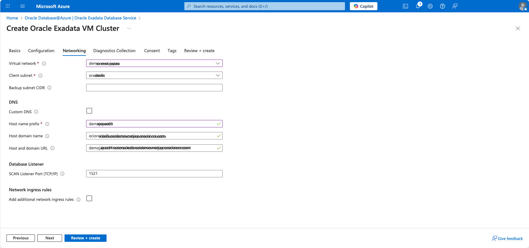

Oracle AI Database@Azure have the following DNS deployment options for Exadata Database:
  • Default DNS: This is default option where Oracle manages the DNS setup during the provisioning process, which created a record for the VM Cluster, and the scan uses the *.oraclevcn.com FQDN.
  • Custom DNS: This option allows customer to specify any FQDN of their choice during the provisioning process, which require private DNS resolver under private views.
Oracle AI Database@Azure has the following DNS deployment options for the Network Anchor service:
Default DNS (oraclevcn.com)
The default OCI domain oraclevcn.com is used for the Oracle AI Database@Azure deployment. You don't need to create this DNS zone as it's automatically generated and associated with your Azure subscription as a private DNS zone during provisioning. It's the most straightforward approach for environments where a custom domain isn't required.

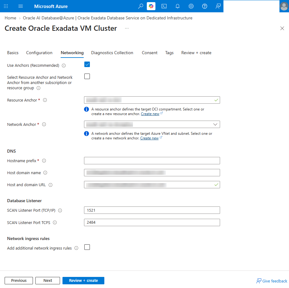

Configuration on the Azure Portal
  • Prepare Virtual Network (VNet): Create the VNet for Oracle AI Database@Azure with either Azure provided default DNS or custom DNS.
  • Provision Oracle AI Database@Azure:
    • Navigate to the Oracle AI Database@Azure blade to begin provisioning the infrastructure and Exadata VM Cluster.
    • During configuration, select Use Anchors (Recommended), and then select the network anchor previously created.
      custom dns
    • Provide a Hostname prefix (for example, oradb) which is used for the logical database name.
    • Accept the system-generated default names for other settings.
  • Automatic DNS Provisioning: During the deployment, the service automatically creates an Azure Private DNS Zone for oraclevcn.com and a virtual network link to the Oracle AI Database@Azure VNet.

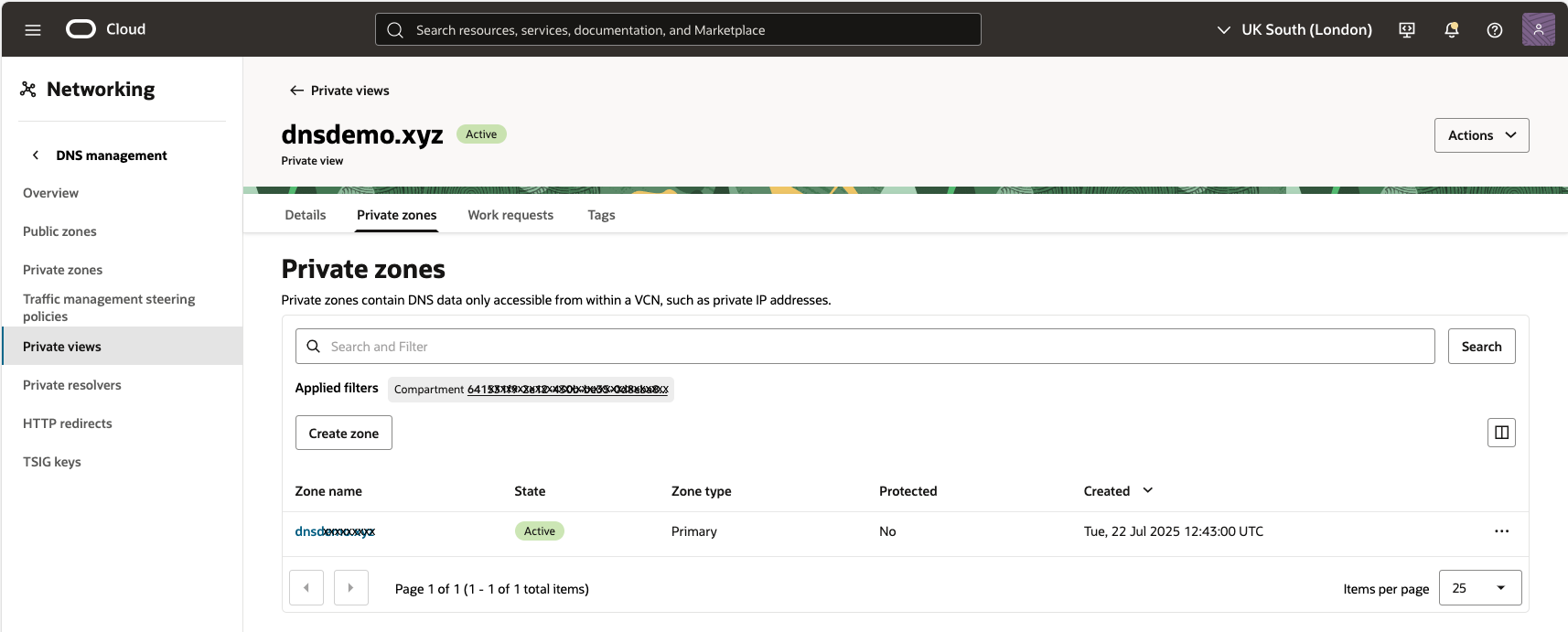

Configuration on the OCI Console (Pre-Deployment):
  1. Navigate to your OCI tenancy and the compartment designated for Oracle AI Database@Azure.
  2. Go to Networking > DNS Management > Private Views.
    Private View
  3. Create a Private DNS Zone for your custom domain (for example, oradb.prod.dnsdemo.xyz). This zone is used by Oracle AI Database@Azure to resolve external DNS names, including other Azure resources. You can add multiple zones and views as needed.
    private DNS zone

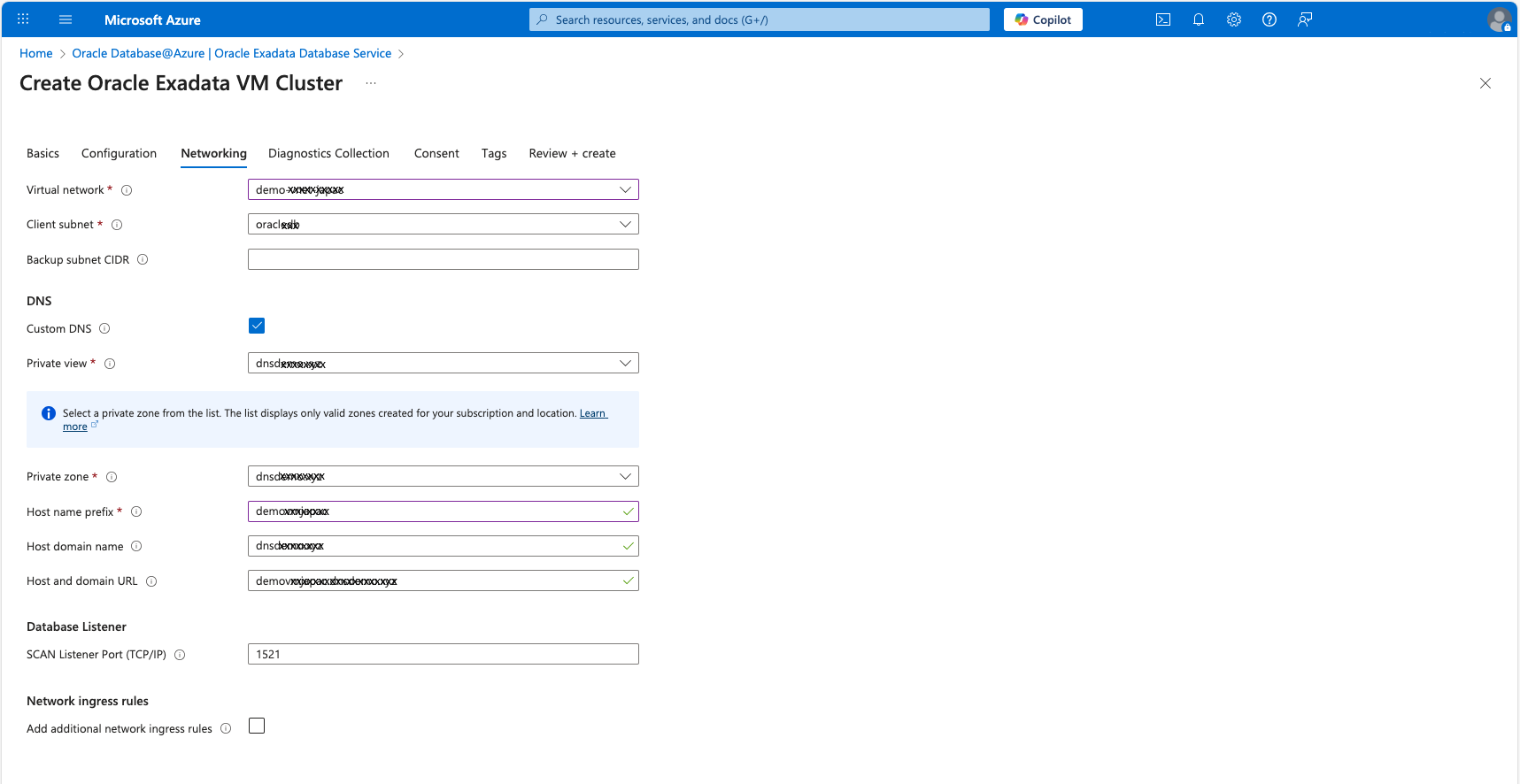

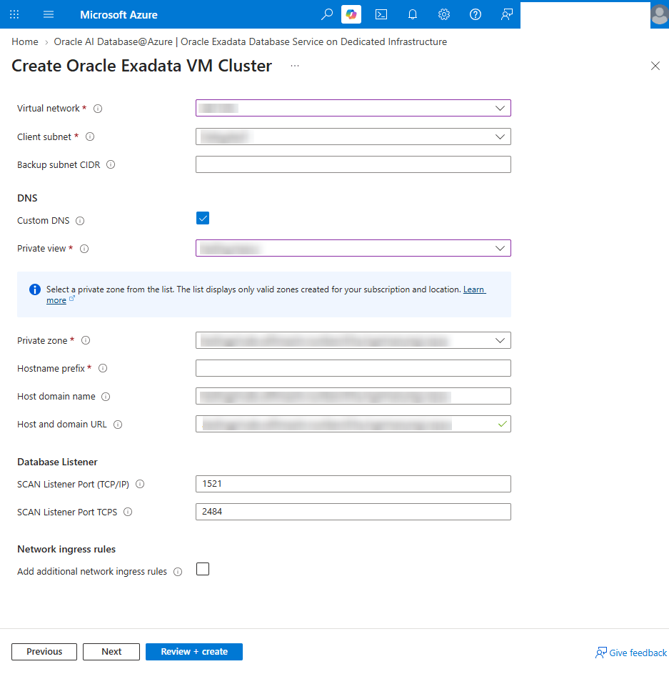

Configuration on the Azure Portal (Deployment):
  1. Prepare Virtual Network (VNet): Create and configure the VNet for Oracle AI Database@Azure. Set its DNS servers to Custom or Azure-provided based on your environment's needs.
  2. Provision Oracle AI Database@Azure:
    • From the Oracle AI Database@Azure blade, begin provisioning the infrastructure and Exadata VM Cluster.
    • During configuration, select Custom DNS.
    • From the menu, select the private view containing your custom DNS zone (oradb.prod.dnsdemo.xyz).
    • Provide a Hostname prefix (for example, oradb). The database records is automatically added to your custom domain within OCI.
      create cluster
  3. Manual DNS Record Duplication: Because custom DNS was selected, the oraclevcn.com private zone will not be created in Azure. You must manually duplicate the DNS records for the Oracle AI Database@Azure SCAN and VIPs from OCI into your production DNS zone (oradb.prod.dnsdemo.xyz) managed in Azure or your on-premises DNS servers.

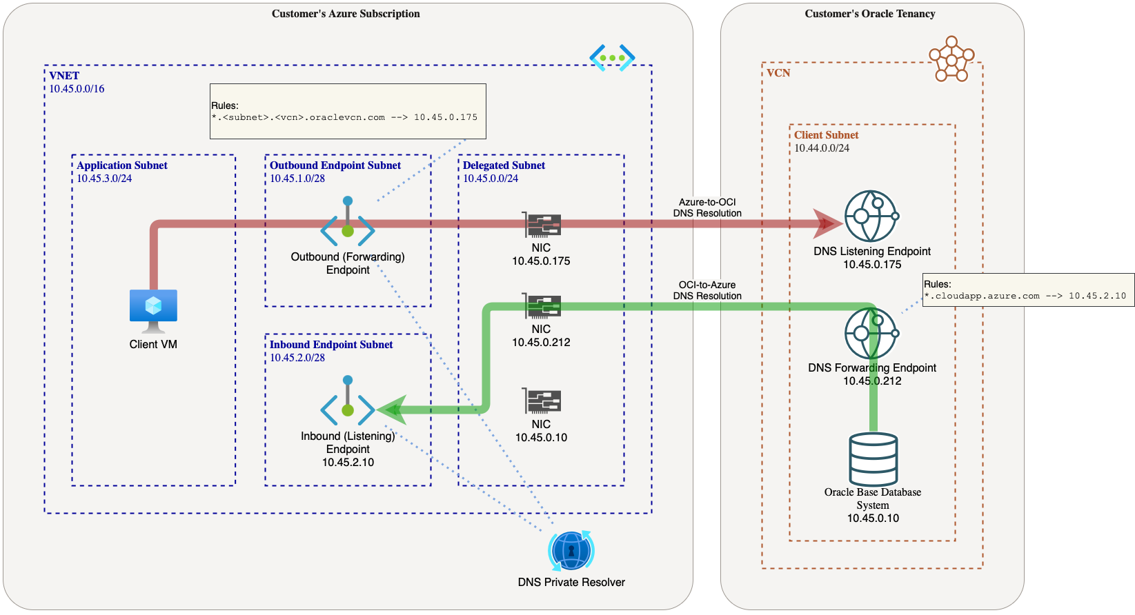

Reference Architecture
The following illustration shows the reference architecture for DNS implementation through Network Anchors:
Network Anchor architecture diagram
Enable Inbound DNS (OCI → Azure)
Inbound DNS allows resources running in an OCI child or parent site, such as databases and database hosts, to resolve hostnames in Azure or on-premises environments.
  • As part of the Resource Anchors creation, it provides the option to list of DNS forwarding rules for domains that need to be resolved from OCI to Azure.
  • The Network Control Plane performs the following tasks:
    • Creates a forwarding DNS endpoint in the network link VCN.
    • Adds the forwarding rules you provide.
    • Synchronizes DNS Records from OCI to Azure if the outbound DNS isn't enabled.
Enable Outbound DNS (Azure → OCI)
Outbound DNS allows resources on the Azure side ( such as VMs or on-premise systems) to resolve DNS names for Oracle AI Database@Azure.
  • The Network Control plane performs the following tasks:
    • Creates a listening DNS Endpoint in the network link VCN.
    • Updates the network security group to allow inbound DNS traffic from the VNet CIDR (for example 10.45.0.0/16) using both UDP and TCP on Port 53.
    • Exposes the listening endpoint IP address in Network Anchor, which you can access in the Network Anchor overview page.
