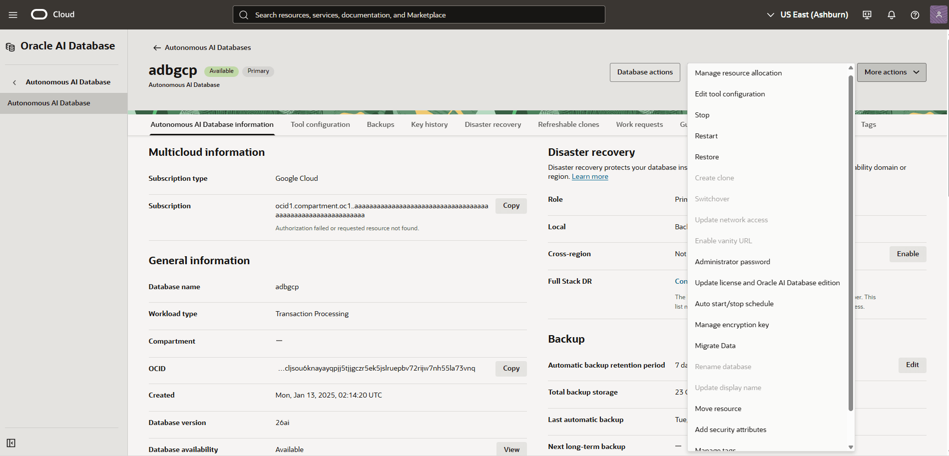

Autonomous AI Database
To modify an existing Autonomous AI Database, follow these steps.
  • Manage an Autonomous AI Database
    1. From the Oracle Database@Google Cloud dashboard , select Autonomous AI Database Service > Autonomous AI Database from the left-menu.
    2. Select the Autonomous AI Database from the list.
    3. Select the Manage in OCI link.A screenshot of modifying the Autonomous AI Database process.

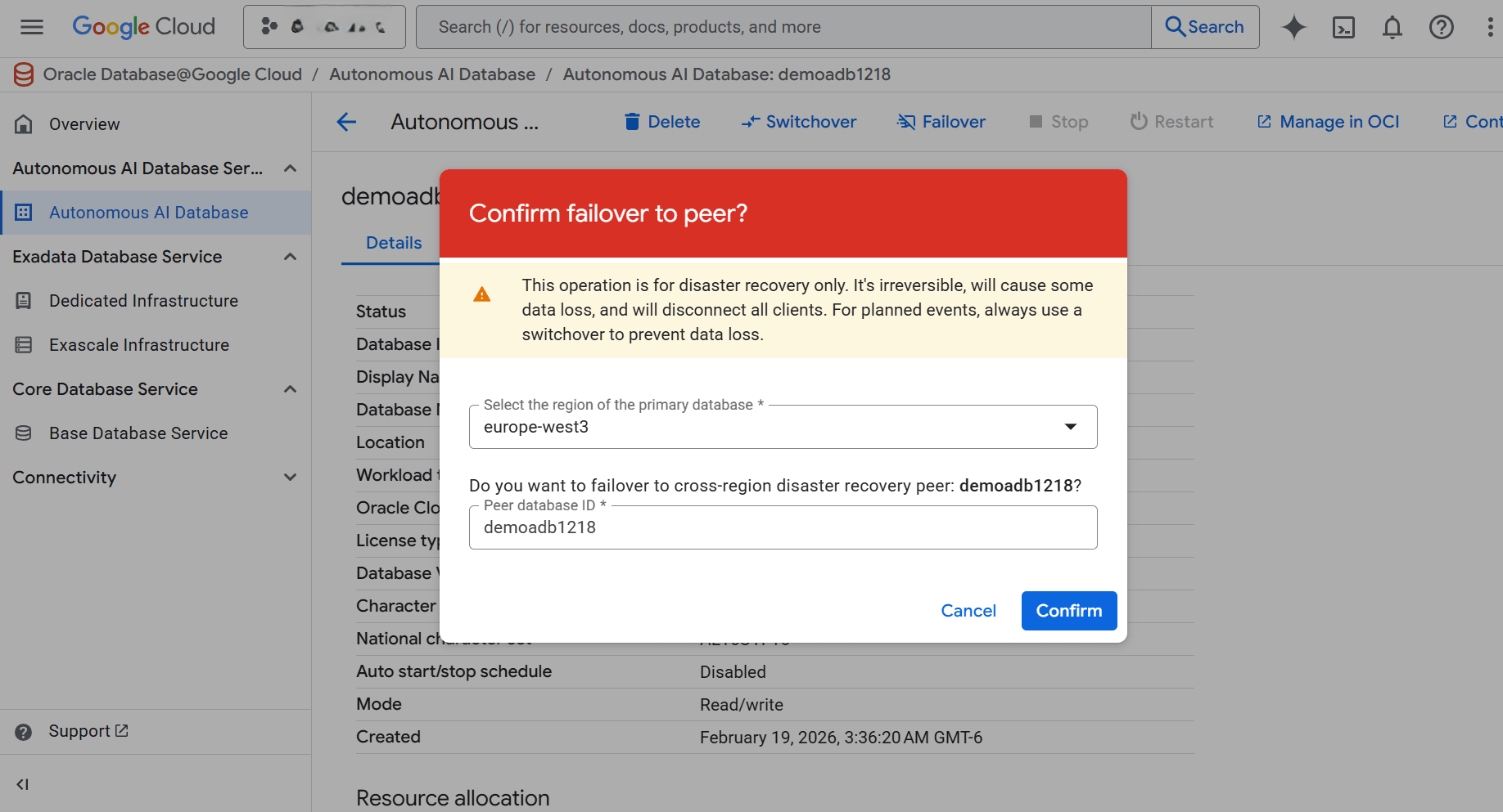

    Failover
    A failover is an unplanned operation that promotes the standby database to primary when the original primary becomes unavailable, which may result in data loss depending on the outage and data replication status. You should perform a switchover first and perform a failover when a switchover can not be completed such as in the event of a system failure or unplanned outage.
    These are the steps to perform a failover of your Autonomous AI Database from the Oracle Database@Google Cloud dashboard.
    1. Select Autonomous AI Database Service > Autonomous AI Database from the left-menu.
    2. Select your Standby Autonomous AI Database.
    3. Select the Failover button.
      1. From the Select the region of the primary Autonomous AI Database drop-down list, select the region of the primary Autonomous AI Database.
      2. Enter your Autonomous AI Database ID in the confirmation field.
      3. Select the Confirm button to save your changes.
        Note
        This operation is for disaster recovery only. It's irreversible, will cause some data loss, and will disconnect all clients. For planned events, always use a switchover to prevent data loss.
      This screenshot shows how to perform a failover.
    4. Navigate back to the Autonomous AI Databases list to check the Status of your Autonomous AI Database.

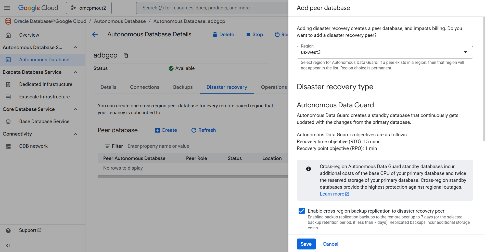

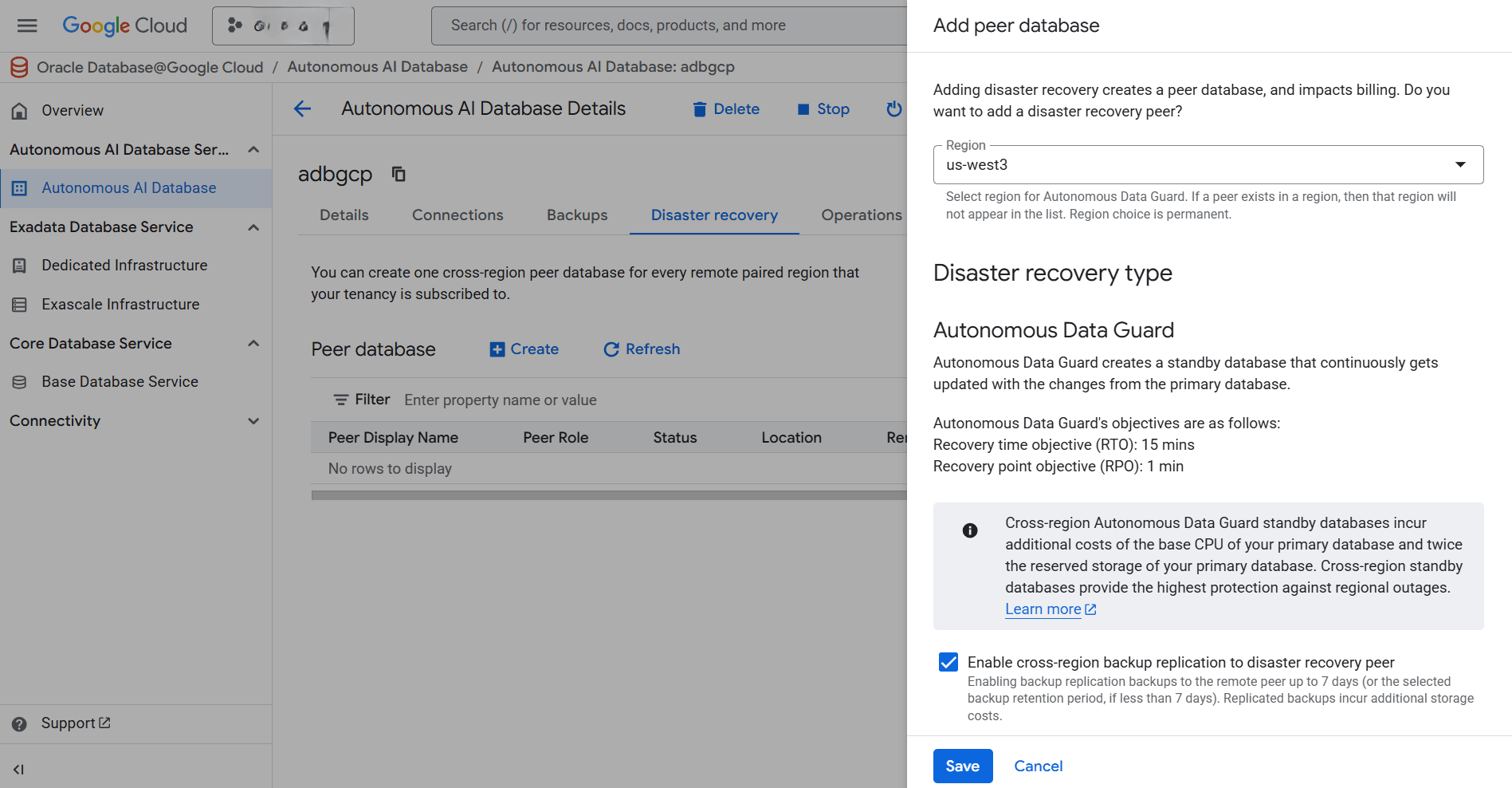

    Disaster Recovery
    This topic explains how to create a cross-region disaster recovery peer to protect your Autonomous AI Database instance from a complete region failure with a standby database or a backup copy in a different region than the primary database.
    Complete the following steps to create a cross-region disaster recovery peer.
    1. From the Google Cloud console, select Oracle Database@Google Cloud.
    2. From the left-menu, select Autonomous AI Database Service and then Autonomous AI Database.
    3. Select your Autonomous AI Database that you want to create disaster recovery peer.
    4. Select the Disaster recovery tab, and then select the + Create button. Adding disaster recovery creates a peer database and incurs an additional cost.This screenshot shows how to perform a disaster recovery.
    5. From the Add peer database page, complete the following substeps:
      1. From the Region dropdown list, select region for Autonomous Data Guard.
        Note
        • You can create up to 1 local peer and 1 cross-region peer for every remote paired region that your tenancy subscribed to
        • If there is already a paired region, then that Region will not displayed in the list.
        • Some regions have a paired region to support cross-region disaster recovery. The pairing is bi-directional and it will allow you to create a cross-region peer in a different region. You can only create a cross-region disaster recovery in a paired region. For more information, see the following table below.
          Table 1-1 Paired Regions
          Regional Pair A Regional Pair B
          US East US West
          UK South Germany Central
          US East US Midwest (Des Moines)
      2. From the Disaster recovery type section, select the checkbox to Enable cross-region backup replication to disaster recovery peer.
        Note

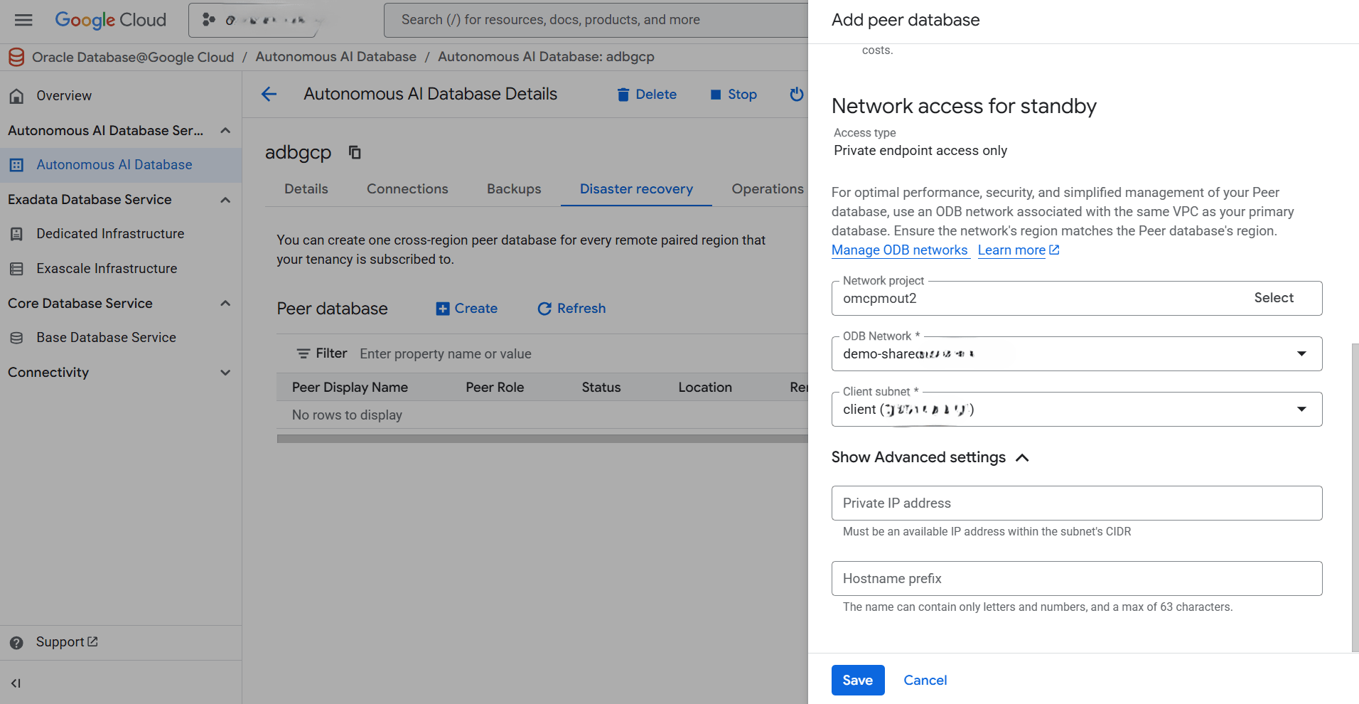

      3. From the Network access for standby section, select your Network project, ODB Network and Client subnet.
        Note
        You can modify and manage your network settings within the OCI console after creating a peer database.
      4. Expand the Show Advanced settings section, enter an available IP address within the subnet's CIDR in the Private IP address field. Then, enter a name in the Hostname prefix field. The name can contain only letters and numbers, and a max of 63 characters.
      5. Review your information, and then select the Save button to create a peer database.
    6. Once the process completes successfully, the Status changes to Available.
    7. You can view the peer database in the resource list under the Disaster recovery tab.

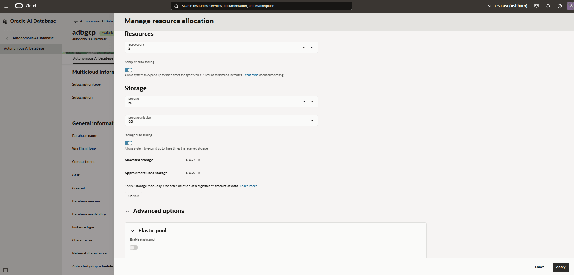

    1. To manage resource allocation, in the OCI console for the selected Autonomous AI Database, select the More actions button and the Manage resource allocation item from the menu. From the Manage resource allocation page, you can change the following options.
      1. In the Resources section, you can change the following.
        1. In the ECPU count field, you can enter a value.
        2. The Compute auto scaling checkbox enables or disables compute auto scaling as needed.
      2. In the Storage section, you can enter the following.
        1. In the Storage field, you can enter a value.
        2. In the Storage unit size drop-down, you can select GB or TB as needed.
        3. The Storage auto scaling checkbox enables or disables storage auto scaling as needed.
        4. The Allocated and Available fields are read-only calculated values.
        5. The Shrink button allows you to reduce the current Allocated storage of your database after you have deleted a significant amount of data. For more information, see Shrink Storage
        6. The Elastic pool checkbox enables or disables elastic storage if you have enabled it on your Autonomous AI Database. If it has not been enabled, this checkbox is unavailable.
        7. Select the Apply button to continue.

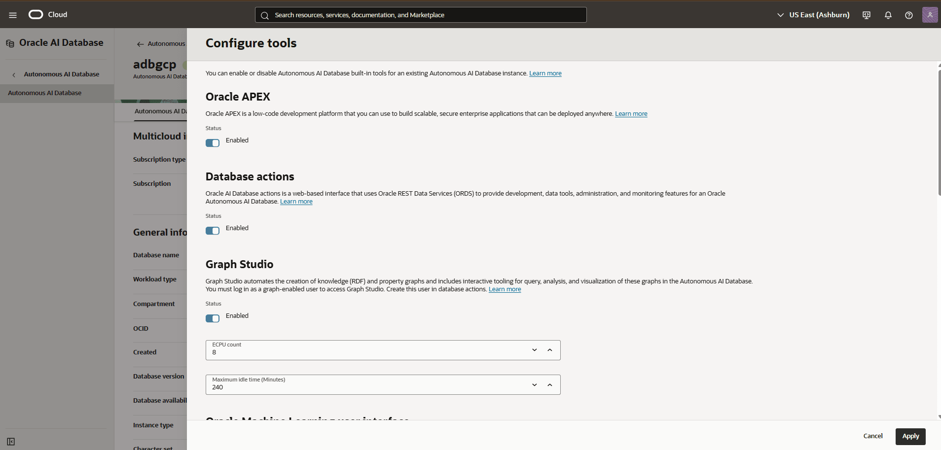

    2. To configure the available tools, in the OCI console for the selected Autonomous AI Database, select the Actions button and the Edit tool configuration item from the menu. From the Configure tools page, you can change the following options.
      1. All of the Autonomous AI Database tools have checkboxes allowing you to enable or disable the tool, including Graph studio, Oracle Machine Learning user interface, Data Transforms, and Data Lake Accelerator.
      2. Some of the Autonomous AI Database tools have an ECPU count field that allows you to control the number of ECPUs assigned to that tool, including Oracle APEX, Database actions, Graph studio, Oracle Machine Learning user interface, Data Transforms, Web Access (ORDS), MongoDB API, and Data Lake Accelerator.
      3. Some of the Autonomous AI Database tools with ECPU count fields also have an Maximum idle time (Minutes) field that allows you to control the time, in minutes, after which an idle process for that tool will be terminated.
      4. Select the Apply button to continue.

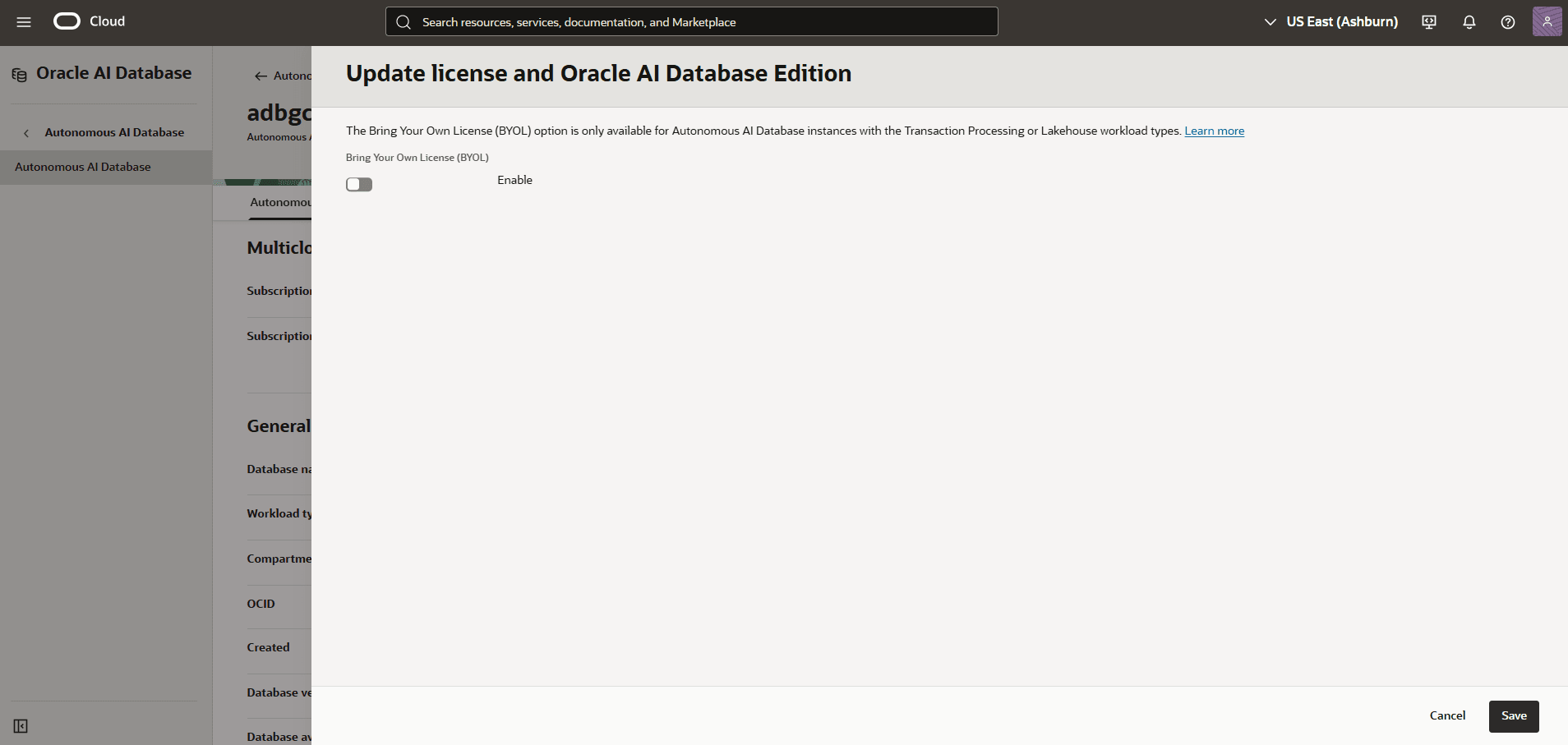

    4. To change the license type, in the OCI console for the selected Autonomous AI Database, select the Actions button and the Update license and Oracle Database edition item from the menu. From the Update license and Oracle Database Edition page, you can change the following options.
      1. The Bring Your Own License (BYOL) checkbox can enabled or disabled.
      2. If Bring Your Own License (BYOL) is enabled, you can select the Oracle Database edition. See the ECPU limits for each addition in the help text.
      3. If Bring Your Own License (BYOL) is enabled, you can enable or disable the Enable BYOL ECPU limit checkbox. BYOL ECPU limits allow you to control how many ECPUs will be covered by BYOL licenses.Use the limit when the number of BYOL licenses you bring may not be enough to cover all of the database ECPUs you have provisioned, including auto-scale, disaster recovery peers, and database tools.
      4. If Bring Your Own License (BYOL) and Enable BYOL ECPU limit are enabled, enter a value in the Number of ECPUs to be covered by BYOL
      5. Select the Save button to continue.

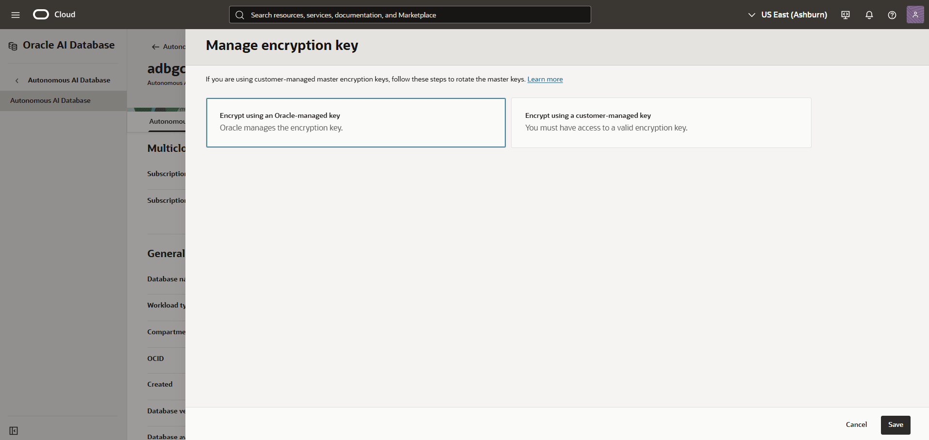

    6. To change encryption key, in the OCI console for the selected Autonomous AI Database, select the Actions button and the Manage encryption key item from the menu. By default, your Autonomous AI Database uses Oracle-managed encryption keys during creation. From the Manage encryption key page, you can change the following options.
      1. Select either Encrypt using an Oracle-managed key or Encrypt using an customer-managed key.
      2. If you select Encrypt using an customer-managed key, you see the Key type drop-down of available customer-managed options. Select the one you want to use.
      3. Depending on the option you select, there may be additional fields and values required by that encryption key management option. For more information, see Use Customer-Managed Encryption Keys with Vault Located in Local Tenancy, Use Customer-Managed Encryption Key Located in a Remote Tenancy, AWS Key Management Service, or About Azure Key Vault as required.
      4. Select the Save button to continue.

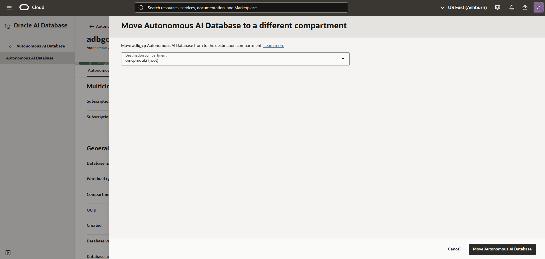

    7. To move a resource in your Autonomous AI Database, in the OCI console for the selected Autonomous AI Database, select the Actions button and the Move resource item from the menu. From the Move resource page, you can change following.
      1. The Move resource page shows the current compartment at the top. In the Destination compartment enter a new compartment. You cannot move resources to the same compartment.
      2. Select the Move resource button when finished.

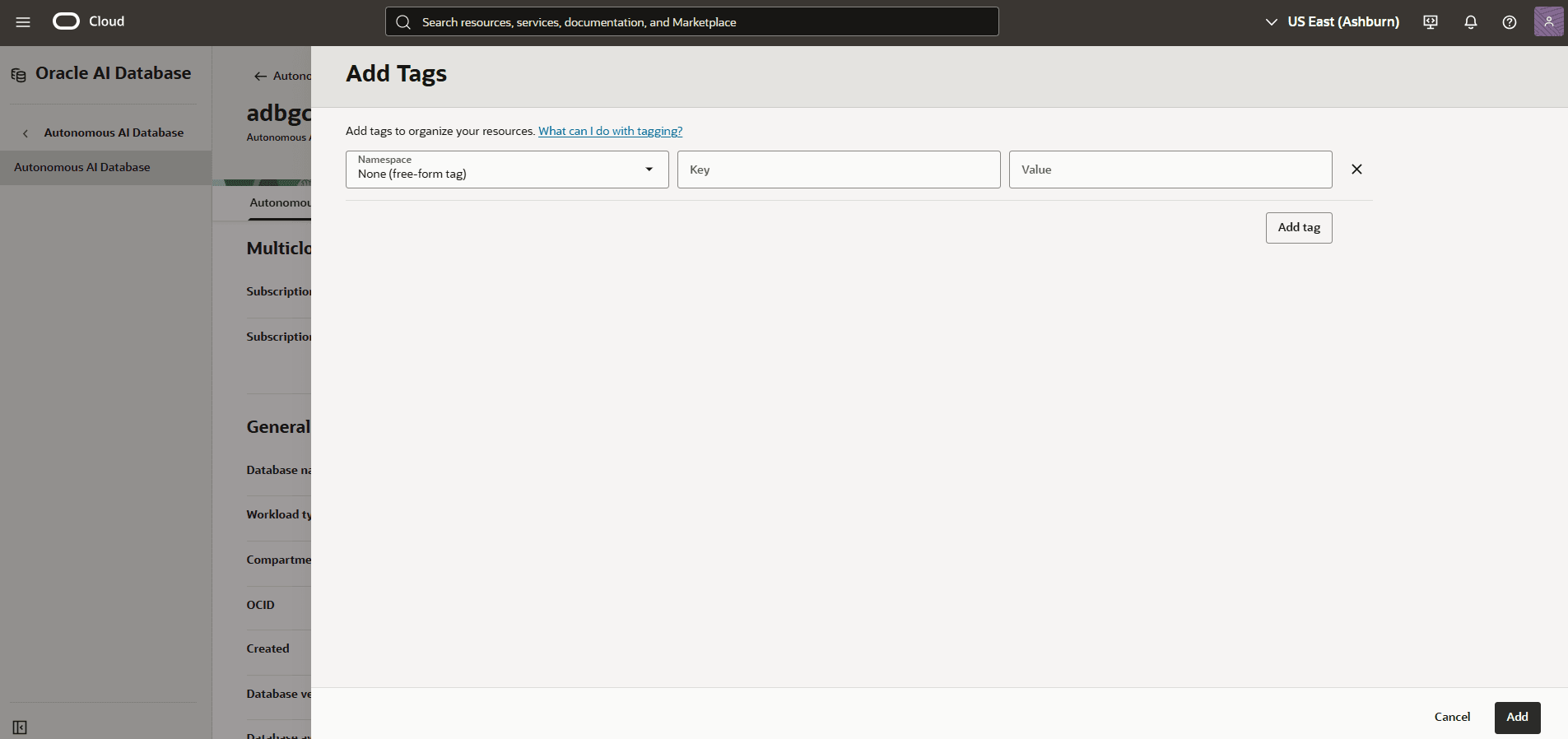

    9. To add a tag to your Autonomous AI Database, in the OCI console for the selected Autonomous AI Database, select the Actions button and the Add Tags item from the menu. From the Add Tags page, you can change following.
      1. The Namespace drop-down is a single value None (free-form tag).
      2. The Key and Value fields can be used needed.
      3. For more information on what you can do with tags, see Overview of Tagging.
      4. If you want to enter another tag, select the Add tag button.
      5. When you have added the tag(s) you want, select the Add button.
