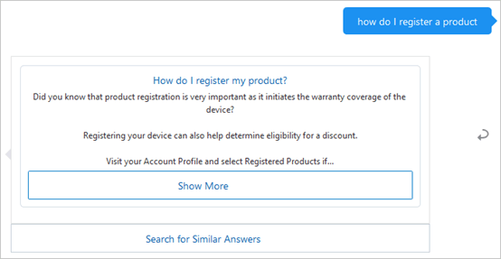

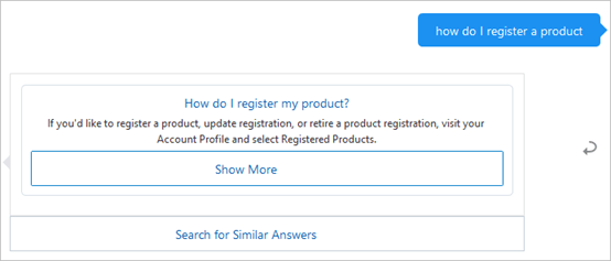

value: "returns"Tailor Knowledge Foundation Response for Chat Conversation
Oracle B2C Service Knowledge Foundation answers are typically written for web pages and thus can be too long to fully display in a conversation. For lengthy answers, the output is truncated and the user must click the Show More button to see the full content. When your answer is longer than a short paragraph, consider adding a special response that you tailor specifically for chat conversations.
To display the special response instead of the answer, set the
Knowledge Search component's Preferred Version of
Results property to Special Response
and set Only Show Preferred Version to
false. With these settings, the component outputs
the special response if it exists. Otherwise it outputs the full answer if
the result-size limit hasn't been met.
If your skill is in YAML dialog mode, the corresponding property names are
resultVersion and
resultVersionExclusive.
The following screenshots show the difference between a full answer and a special response. The first screenshot shows the full answer. Notice how the response to "how do I register a product", which begins with "Did you know that product registration is very important", is not the way a human would respond to the question, and thus is not "conversational." In addition, the full answer is cut off in the middle of the third paragraph. The second screenshot shows the special response, which is more conversational and not truncated.

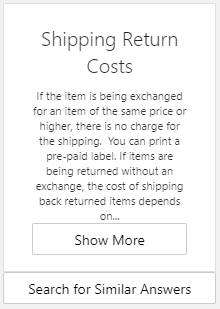

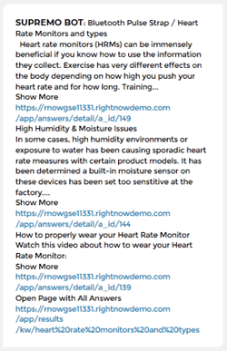

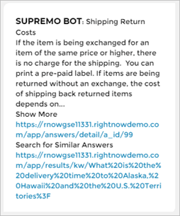

Remove the View Details Button and Display All the Text
By default, the Knowledge Search dialog flow component just displays the first few lines of the answer along with a button that the user clicks to see the full answer in a browser tab.
If you want it to show all the answer's content, set the Knowledge Search component's
Web Article Link Label to On and set the
value of the systemComponent_KnowledgeSearch_resultLinkLabel resource
bundle key to the FreeMarker literal notation ${r""}.
If your skill is in YAML dialog mode, you accomplish this by setting the
System.KnowledgeSearch's resultLinkLabel property
to an empty string ("").

How the results from the Knowledge Search dialog flow component appear depend on whether they are displayed in the default chat that's accessed through the customer portal or the Oracle Inlay Toolkit embedded chat inlay.
- Links: Links appear as buttons in the embedded chat inlay. In the default chat, the label is displayed as text, and it is followed by a clickable URL.
- Multiple Results: When there's more than one result, the results appear as cards either horizontally or vertically depending on the value of the component's
cardLayoutproperty (the default is horizontal). In the default chat, the results appear vertically.
Note that images don't appear in the results.
This table illustrates how single and multiple results display in the embedded chat inlay and the default chat.
| Example Component Configuration | Embedded Chat Inlay | Default Chat |
Example of a single result (Visual mode):
Example of a single result (YAML mode):
Example of multiple results (Visual mode):
Example of multiple results (YAML mode):
