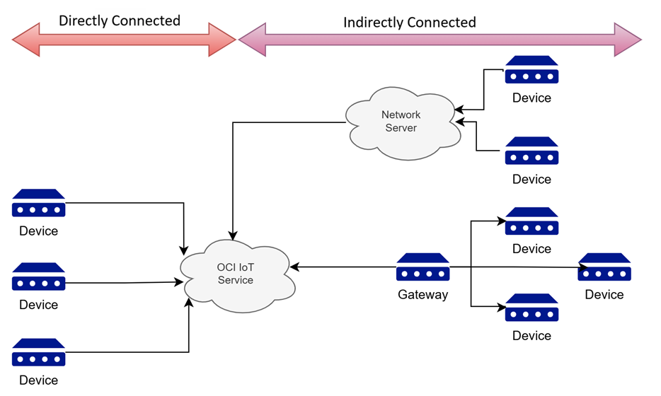

Use this scenario to create one reusable gateway, one directly connected device, and several indirectly connected devices.
To illustrate this scenario, the examples model a small building heating, ventilation, and air conditioning system (HVAC) including:
  • A gateway named Bosch Gateway 1 authenticates to the IoT domain and collects or routes data for devices such as HVAC units, boilers, and dehumidifiers.
  • The directly connected HVAC instance shows a device that sends its own telemetry.
  • The indirectly connected HVAC, boiler, and dehumidifier instances show devices whose telemetry and commands move through the gateway instead.
For more concepts, see Indirectly Connected Devices FAQ. To route messages for different device families or nested payload structures, see Route Indirect Device Data Using target and contentRoot.
Review the diagram to understand how the gateway, directly connected devices, and indirectly connected devices interact with the 3 types of digital twin instances.

How to decide which connectivity type to use for a digital twin instance. To complete an end-to-end connectivity change, see Change a Digital Twin Instance Connectivity Type.
Directly Connected
Use when
The device connects to the IoT domain on its own.
Use when
Another device, typically a gateway, sends telemetry data and receives commands on the device's behalf.
Required
One or more gateway associations is required. Use more than one gateway when a wireless device might roam between gateways. Confirm with an administrator if this works in your environment.
