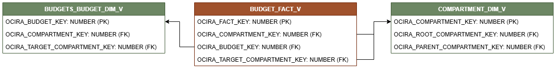

Relationship Diagram
This section provides diagrams that define the logical relationship of a fact table with different dimension tables.
The contents of each view and their relationships are listed in the following file: Budgets views.
This diagram shows the relationship of the Budgets fact view with different dimension views.
BUDGETS_FACT_V
Relationship diagram showing the fact table, BUDGETS_FACT_V.

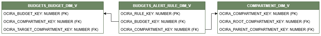

Relationships exist among dimensions. Dimensions can be joined directly to each other. This diagram shows the relationship between dimension views.
BUDGETS_ALERT_RULE_DIM_V
Relationship diagram showing the dimension table, BUDGETS_ALERT_RULE_DIM_V.
