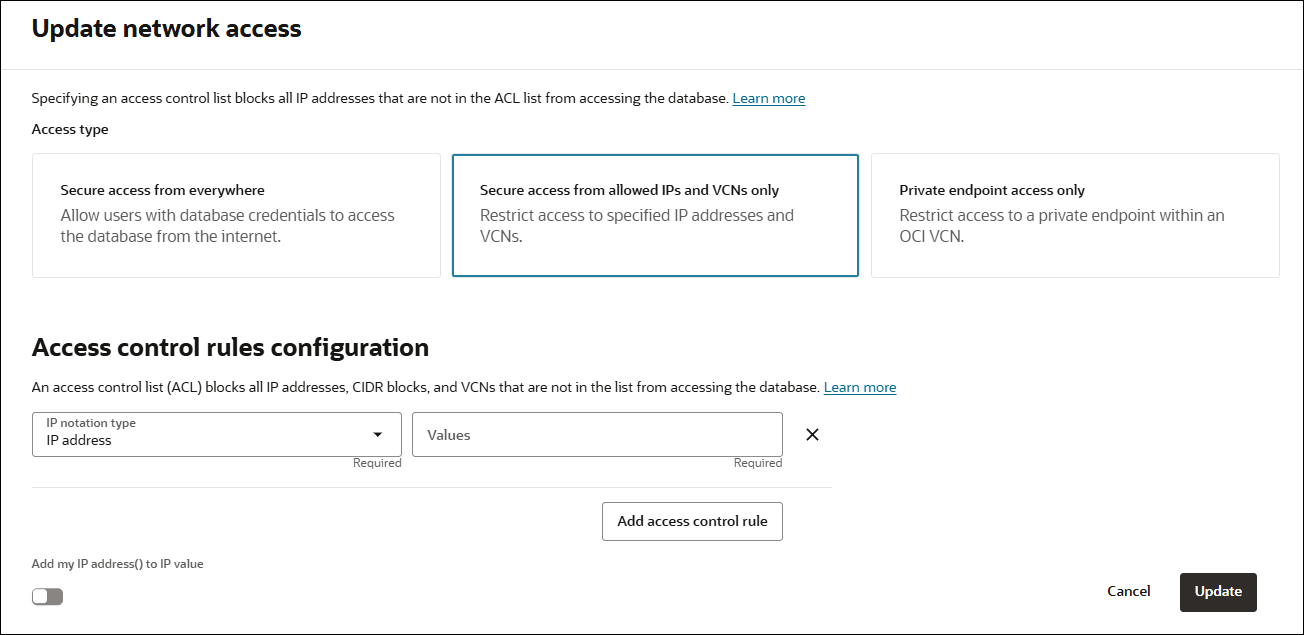

At this point, to use Oracle AI Database API for MongoDB configure secure access by selecting and configuring one of these network access types:

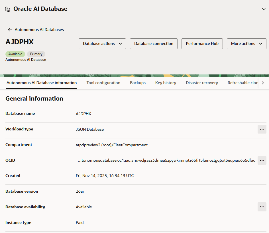

Open the Oracle Cloud Infrastructure Console for your Autonomous AI Database instance.
Description of adb_ajd_console_details.png follows

Access Control List (ACL) Setup
See Configure Access Control Lists for an Existing Autonomous AI Database Instance for more information.
To configure your ACL for an IP address, you will need to obtain the public IP address. There are several ways to show your public IP address:
  • In the choose network access area, click Add my IP address. This copies your IP address into the Values field.
  • After disabling any VPN, use the WhatIsMyIP website.
  • After disabling any VPN, use the curl command: curl -s https://ifconfig.me.

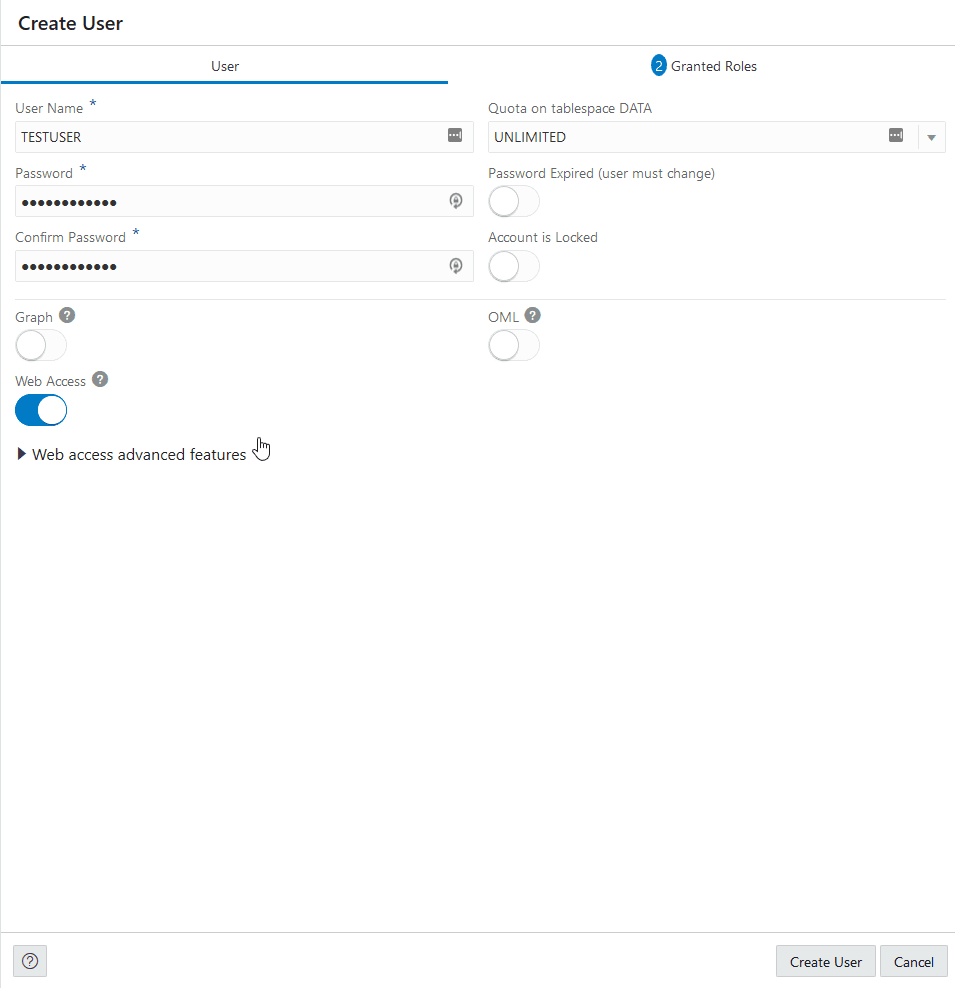

The steps that follow use Database Actions to create a test user with the proper roles. You can also use Database Actions SQL or other SQL command line utilities to execute the SQL statements directly. See Create Users on Autonomous AI Database - Connecting with a Client Tool for more information.
  1. Open the Oracle Cloud Infrastructure Console for your Autonomous AI Database.
  2. Select Database Actions.
  3. From the Database Actions Launchpad, select Administration > Database Users.
  4. Select + Create User on the Database Users page.
  5. Enter a User Name and password for your test user. Select Web Access, and set the Quota on tablespace DATA.
    Description of database_actions_create_user_for_mongodb_use.png follows
    Description of the illustration database_actions_create_user_for_mongodb_use.png

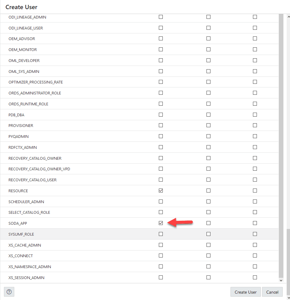

  6. Select the Granted Roles tab.
  7. In addition to the default roles, select and add the SODA_APP role for the user.
    Description of database_actions_grant_roles_for_mongodb_use.png follows
    Description of the illustration database_actions_grant_roles_for_mongodb_use.png
  8. Select the Create User button.

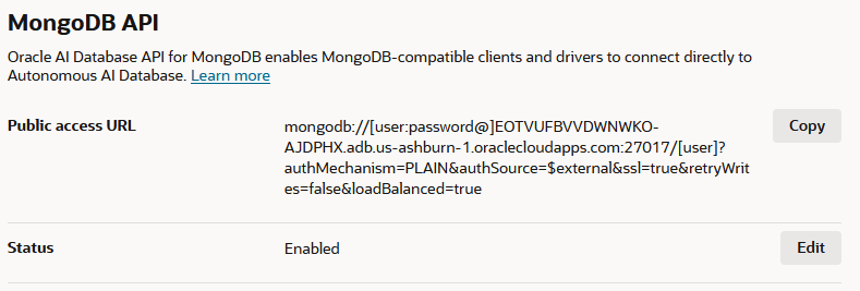

To retrieve the MongoDB API connection string:
  1. On the Autonomous AI Database details page, select the Tool configuration tab.
  2. In the MongoDB API row, under Access URL click Copy.
    Description of adb_tools_mongo_connect_string.png follows

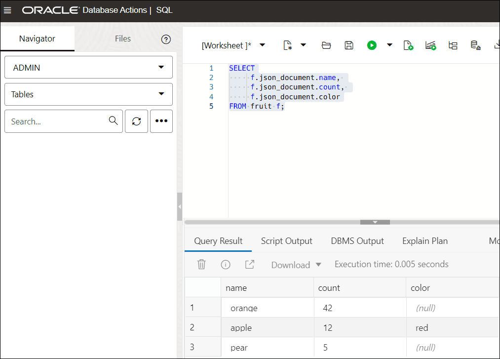

  3. Query the collection using a SQL client such as Database Actions.
    SELECT
        f.json_document.name,
        f.json_document.count,
        f.json_document.color
    FROM fruit f;
    Description of database_actions_sql_for_mongodb_use.png follows
