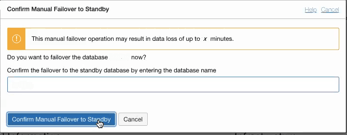

To initiate a manual failover when the primary database is unavailable and the local standby is available:
  1. On the Autonomous AI Database details page, under Disaster recovery, in the Local field, click Failover.
    This shows the Confirm failover to peer dialog, along with information on possible data loss that may result if you perform the manual failover to standby.
    Description of adb_failover_manual.png follows
  2. In the Confirm failover to peer dialog, enter the Autonomous AI Database name to confirm that you want to failover.
  3. In the Confirm failover to peer dialog, click Failover.
