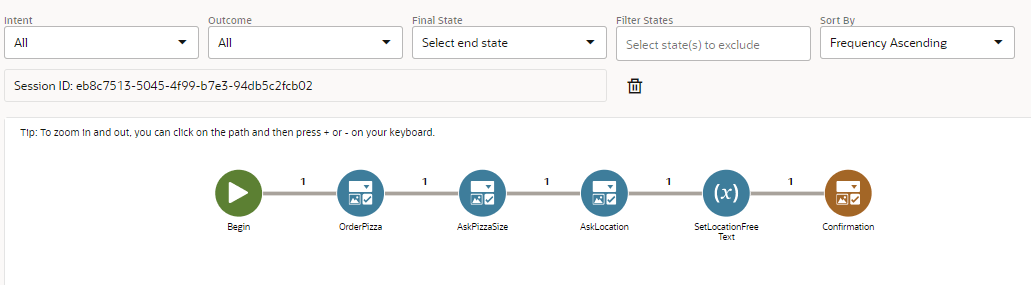

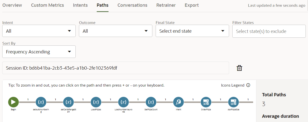

Use Case 2: You Want to Exclude Supporting States from the Insights Pathing Reports
The
![Description of pathing_set_variable_included.png follows Description of pathing_set_variable_included.png follows](img/pathing_set_variable_included.png)
You can add the
![Description of pathing_set_variable_excluded.png follows Description of pathing_set_variable_excluded.png follows](img/pathing_set_variable_excluded.png)
states
node of the CrcPizzaBot skill begins with a series of
System.SetVariable
states. Because these states are positioned at
the start of the definition, they begin each path rendering when you haven't excluded
them with the Filter States option. You may consider supporting states like these as
clutter if your focus is instead on the transactional aspects of the path. You can
simplify the path rendering manually using the Filter States menu, or by adding the
insightsInclude: false
property to the dialog flow definition.
You can add the
property to any state
that you don't wish to see in the Paths

For
the CRCPizzaBotSkill, adding the insightsInclude: false
property to
each of the System.SetVariable
states places the transactional states
at the start of the path.![Description of pathing_set_variable_excluded.png follows Description of pathing_set_variable_excluded.png follows](img/pathing_set_variable_excluded.png)
