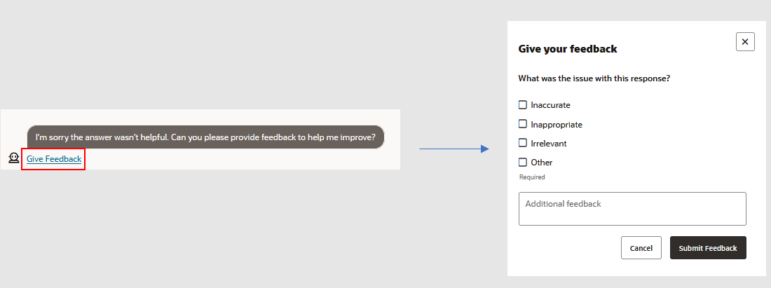

User Ratings for LLM-Generated Content
By default, the user rating (thumbs up and thumbs down) displays on each message.
Thumbs Up and Thumbs Down icons in the skill response message
When users give the LLM response a thumbs down rating, the skill follows up with a link that opens a feedback form.
You can disable these buttons by switching off Enable Large Language Model feedback in Settings > Configuration.
The Enable Large Language Model feedback option.
