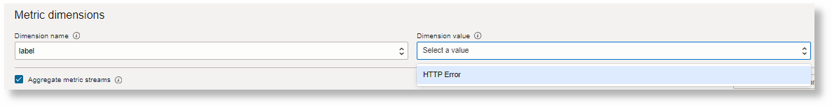

    • The dimensions are added based on parsed log fields Entity and Host IP Address (Client).
    • Additionally, the dimensions are automatically added for the label (HTTP Error in this case), and the detection rule OCID. Those are implicit dimensions.

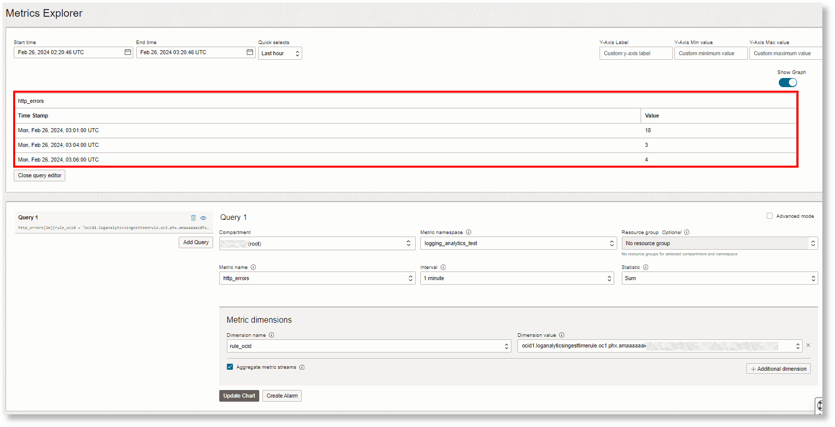

  • View the metrics generated by detection rule in the Metrics Explorer:
    View the metrics generated by the detection rule in the metric explorer
    When looking at the metrics explorer for the http errors metric, the following information can be noted:
    Coinciding with the Log Explorer, three data points with 18, 3, and 4 log records match this label.
    The following dimensions are displayed. Note that Host IP Address (Client) is not displayed because the log records triggering the alarms didn't have a value for that field.
    metric dimensions displayed

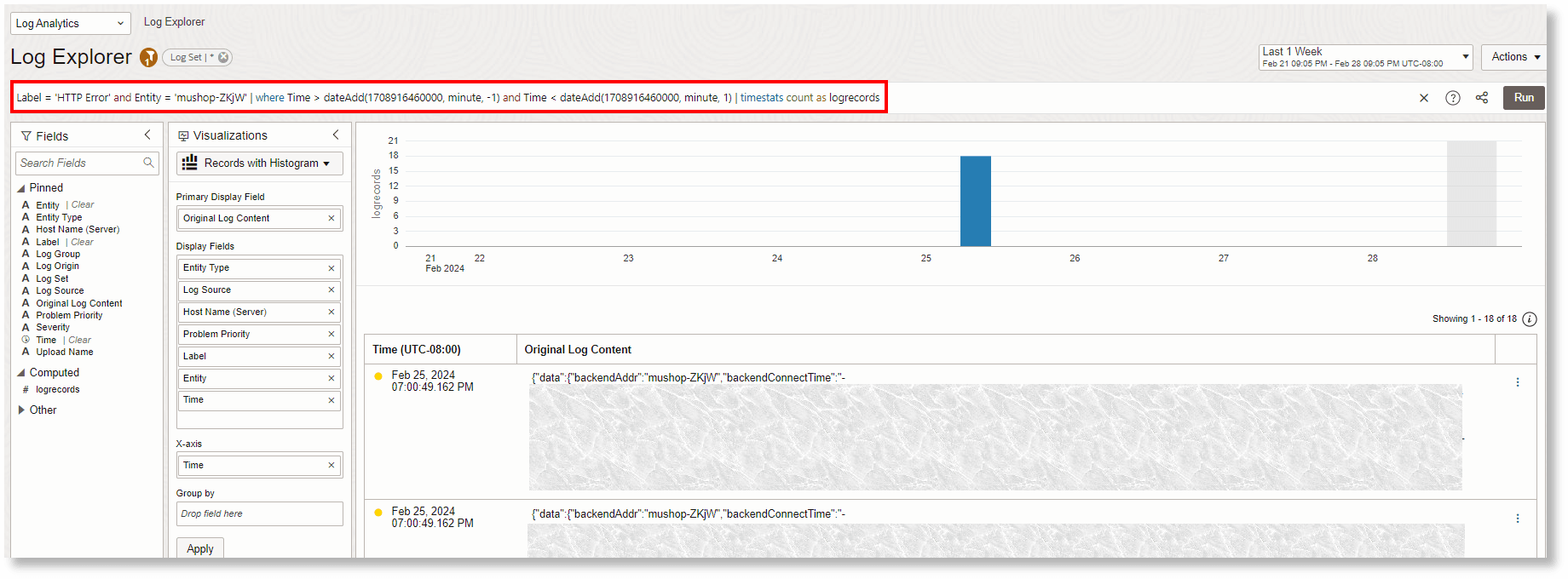

    Running the following query takes you back to the Log Explorer in context; for example, when the alarm is triggered on 18 matching log records (the first data point in the Metric Explorer):
    Label = 'HTTP Error' and Entity='mushop-ZKjW' | where Time > dateAdd(1708916460000, minute, -1) and Time < dateAdd(1708916460000, minute, 1) | timestats count as logrecords
    Here the values HTTP Error, mushop-ZKjW, and 1708916460000 come from the alarm variables. In the query, we look for the time one minute before and after the alarm time. You can adjust this in the query.

  • View result in the Log Explorer:
    When you click the link in your email, and after you log into your tenancy, the following is displayed:
