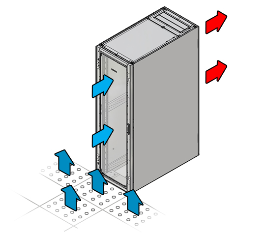

Optional Raised Floor Installations
For installations on optional raised floors, use perforated tiles, approximately 400 CFM/tile, in front of the rack for cold air intake. The tiles can be arranged in any order in front of the rack, as long as cold air from the tiles can flow into the rack. Inadequate cold airflow could result in a higher intake temperature in the system because of exhaust air recirculation. The following is the recommended number of floor tiles:
  • Four floor tiles for a rack with up to 12 compute nodes (fully loaded)
  • Three floor tiles for a rack with up to 6 compute nodes (half loaded)
  • One floor tile for a rack with 3 compute nodes (quarter loaded)
Figure showing the typical data center configuration for perforated floor tiles.
