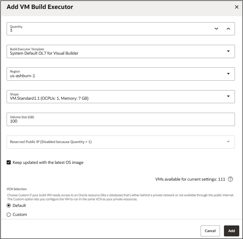

  2. Click + Create VM.
  3. In the Add VM Build Executor dialog box, in Quantity, specify the number of VM executors you want to create.
    To minimize build execution delays, set the number to the number of jobs that you expect to run in parallel using the template you'll specify in Build Executor Template. If you're not sure, start with one VM executor. You can add more VM executors later, based on your actual usage.
  4. In Build Executor Template, select the executor template.
  5. In Region, select the region that's closer to you geographically.
    The drop-down list displays regions your OCI account is subscribed to.
  6. In Shape, select the VM executor's shape.
    For example:
    Description of add-vmbuildxecutor-withlatestos.png follows

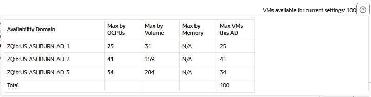

    Click the question mark icon Help iconto see how the number of available VMs was calculated for the current settings. Here's an example of what you might see:
    Description of add-vm-executor-stats-2.png follows
    The display shows the realtime statistics that were used to make this calculation, using your settings. As you change your settings, new statistics are computed and displayed. See What Determines How Many VMs I Can Create? for more information about how the calculations are made.
    If the required number of Compute VM instances aren't available, choose another shape.
  3. In the Add VM Build Executor dialog box, in Quantity, specify the number of VM executors you want to allocate.
  5. In Region, specify the VM executor's region.
    For example:
    Notice the message below the Reserved Public IP (Optional) field. Click the question mark icon Help iconto see how the number of available VMs was calculated for the current settings. Here's an example of what you might see:

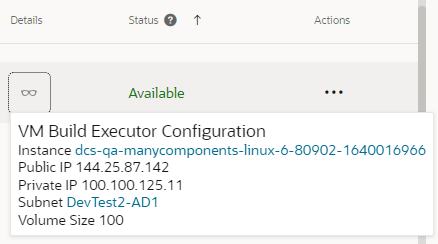

Get the name and IP addresses of a VM executor's VCN subnet.
  1. In the VM executor's Details column, click Show machine detailsDetails.
  2. Note the VCN subnet's name.
    The VM executor's subnet name is displayed only if it's in the Available state. If the VM executor is in the Stopped or the Pending state, click Actions and select Start to start the VM executor.
