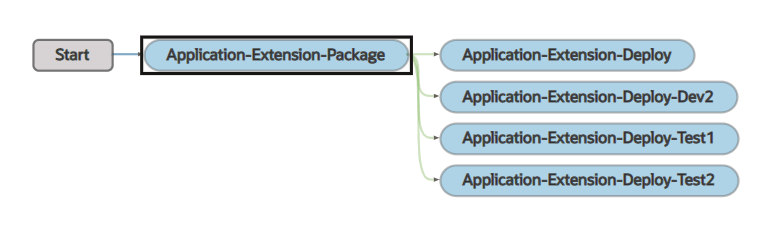

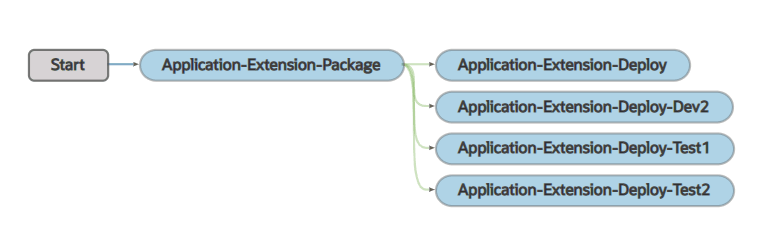

      Instead of creating a new pipeline, configure the existing extensionName-Package and Deploy pipeline to deploy to other instances as well. (If you created this project manually, this pipeline's name is Application-Extension Package and Deploy.) See Configure the Default Pipeline to Deploy to Other Oracle Cloud Applications Instances. Remember, the default pipeline runs automatically when a code change is pushed to the main branch. After you've configured the pipeline, it deploys the extension to all development and test instances on every SCM commit to the main branch.
      After creating this pipeline, you'll have one pipeline in your project that deploys to all DEV and TEST instances.

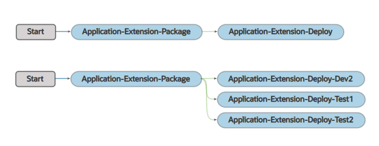

      Here's an example of what this pipeline could look like:

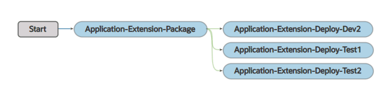

    • A pipeline to deploy the extension to other DEV and TEST Oracle Cloud Applications instances manually. See Create and Configure a Pipeline to Deploy to Other Oracle Cloud Applications Instances.
      Create this pipeline if you don't want to deploy the extension to other instances on every SCM commit, but only after your team members have validated the extension on the primary development instance.
      After creating this pipeline, you'll have two pipelines in the project: 1) Your primary pipeline, which deploys to the primary development instance, and 2) this pipeline, which deploys to other DEV and TEST instances.
      Here's an example of what these pipelines could look like:

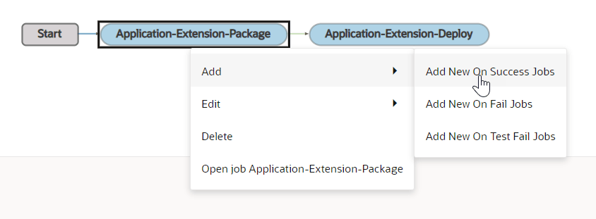

  4. Right-click the extensionName-Package job and select Add, then Add New On Success Jobs.
  5. Click in the Select new on success job(s) field, select the jobs that you want to add from the list, and click Save.

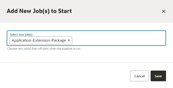

  7. On the Pipeline Configuration page, right-click the Start node and select Add New Start jobs.
  8. Click in the Select new on success job(s) field, select extensionName-Package, and click Save.

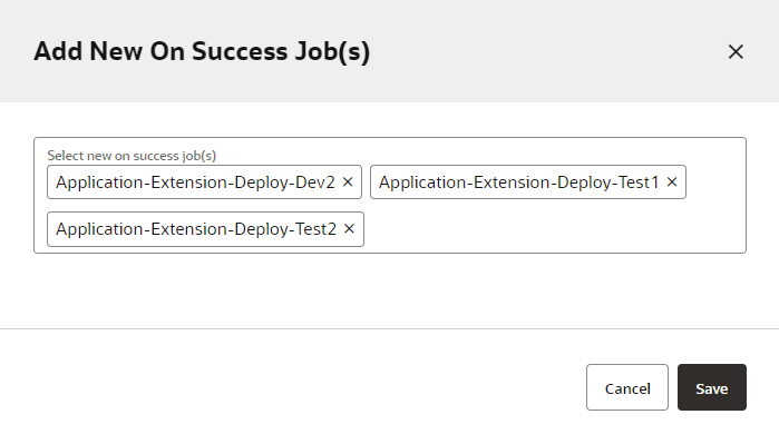

  9. Right-click the extensionName-Package job and select Add, then Add New On Success Jobs.
  10. Click in the Select new on success job(s) field, select the jobs that you want to add from the list, and click Save.
