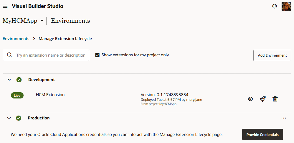

  1. Access the Manage Extension Lifecycle page:
    • From the VB Studio left navigator, click Environments, then click Extension Lifecycle. You won’t see this option if you haven’t yet added an Oracle Cloud Applications instance to your environment.

    • Or, from the menu in the Designer’s header, click Extension Lifecycle. You should now see the Manage Extension Lifecycle page, which lists all the environments that are available.
      Description of mel-ui-full-project1.png follows You can work with an environment on this page as long as the authentication method for its Oracle Cloud Applications instance is OAuth. If there’s an environment listed whose authentication method isn’t OAuth, then you’ll first need to add a new environment with the same base URL, but using OAuth as the authentication method, before you can work with it.

      Note: If you see a Provide Credentials button next to an environment, you must first sign in before you can delete any extensions deployed to that instance.
      Expand each environment to view a list of the extensions already deployed. Use the Show extensions for my project only checkbox to toggle between viewing extensions deployed from the current project only, or from all projects. Each entry includes the extension name plus additional details, such as extension version, deployment date, who deployed the extension, and project name.
  2. To delete an extension from an Oracle Cloud Applications instance, find the extension that you want to delete and click Delete Extension.

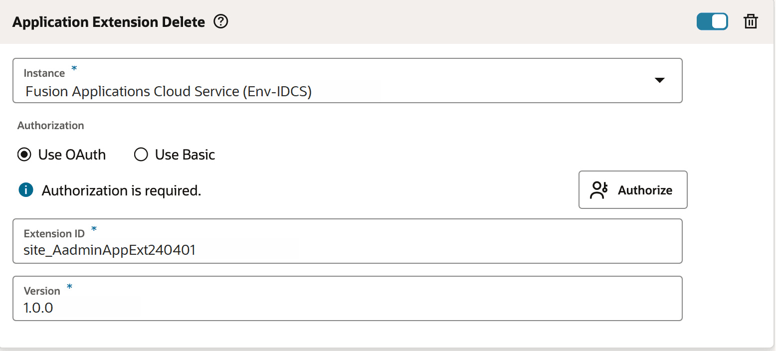

  8. From Add Step, select Application Extension, and then select Delete. This image shows the Application Extension Delete build job page that’s partially filled in.

  9. In Instance, select the Oracle Cloud Applications instance where the application is deployed.
  10. In the Authorization section, specify the authorization type to run this build step. With Use OAuth selected by default, you’ll see the Authorization is required message, indicating that this build step needs a one-time authorization to handle OAuth requests to your environment’s Oracle Cloud Applications instance. Click Authorize and enter credentials to access your Oracle Cloud Applications instance; you can also run the job manually and enter the credentials when prompted. Once authorized, the Authorization has been provided message shows.
    Note
    Note OAuth is the recommended authorization type. Use Basic authentication only if you run into issues with setting up an OAuth connection. To use Basic authentication, select Use Basic, then in Username and Password, enter the credentials of a user who is not only an Oracle Cloud Applications user, but one who can access the Oracle Cloud Application’s instance and undeploy from it. These credentials must be those of a local user, not a federated identity, and must not require multi-factor authentication.
    OAuth tokens (access and refresh) are cycled during regular use. A refresh token is used to obtain an access token whenever a user accesses the target instance. This refresh token is typically valid for seven days. (The token expiration time is set in the IDCS resource app and may be different based on your security requirements.) If the user authenticates with the target instance within the seven-day period, the active refresh token generates a new access token and a new refresh token. This cycle continues indefinitely as long as the refresh token stays valid. If the refresh token expires during extended periods of inactivity (say, when you’re away on vacation), click Renew Authorization (or run the job manually, so you’re prompted to authorize any expired OAuth tokens).
  11. In Extension ID and Version, enter the extension ID and version of the extension you want to delete. You can find these items in the extension’s details on the Manage Extension Lifecycle page.
