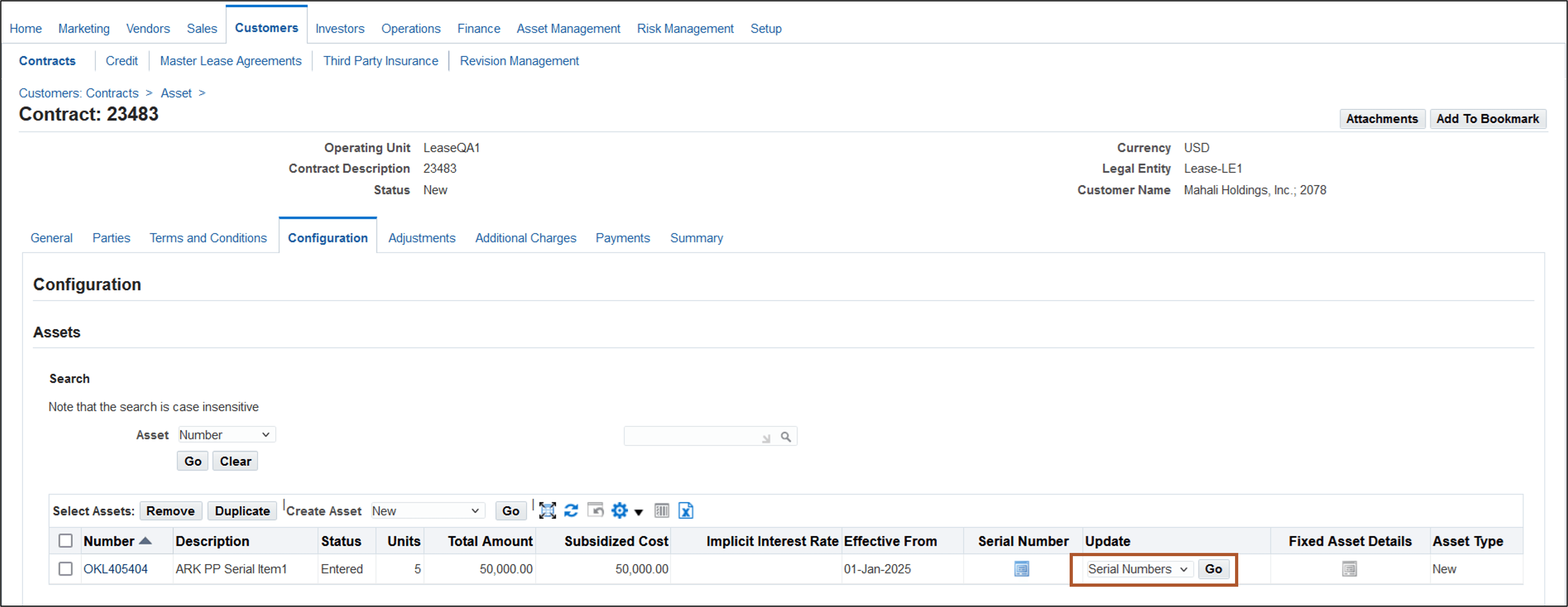

  1. Create a lease contract and add a serialized asset.
  2. Select Update Serial Numbers on the Configuration tab.

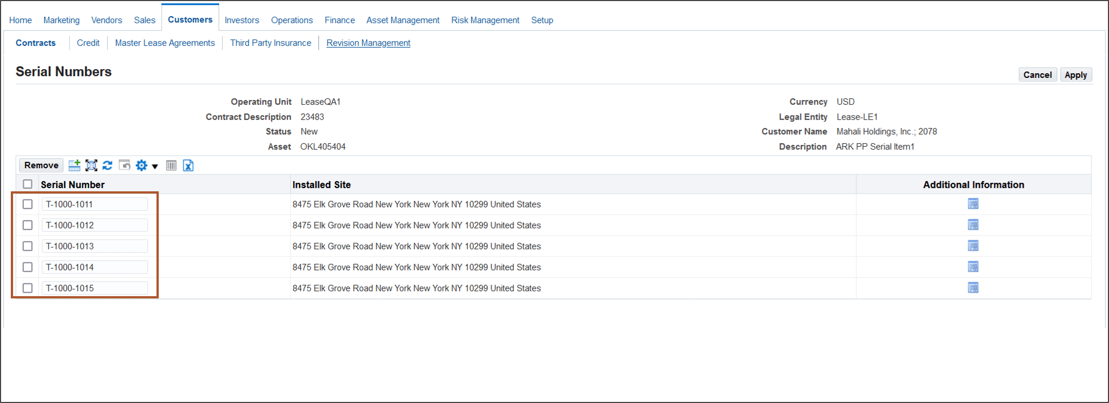

  3. Add serial numbers and save.

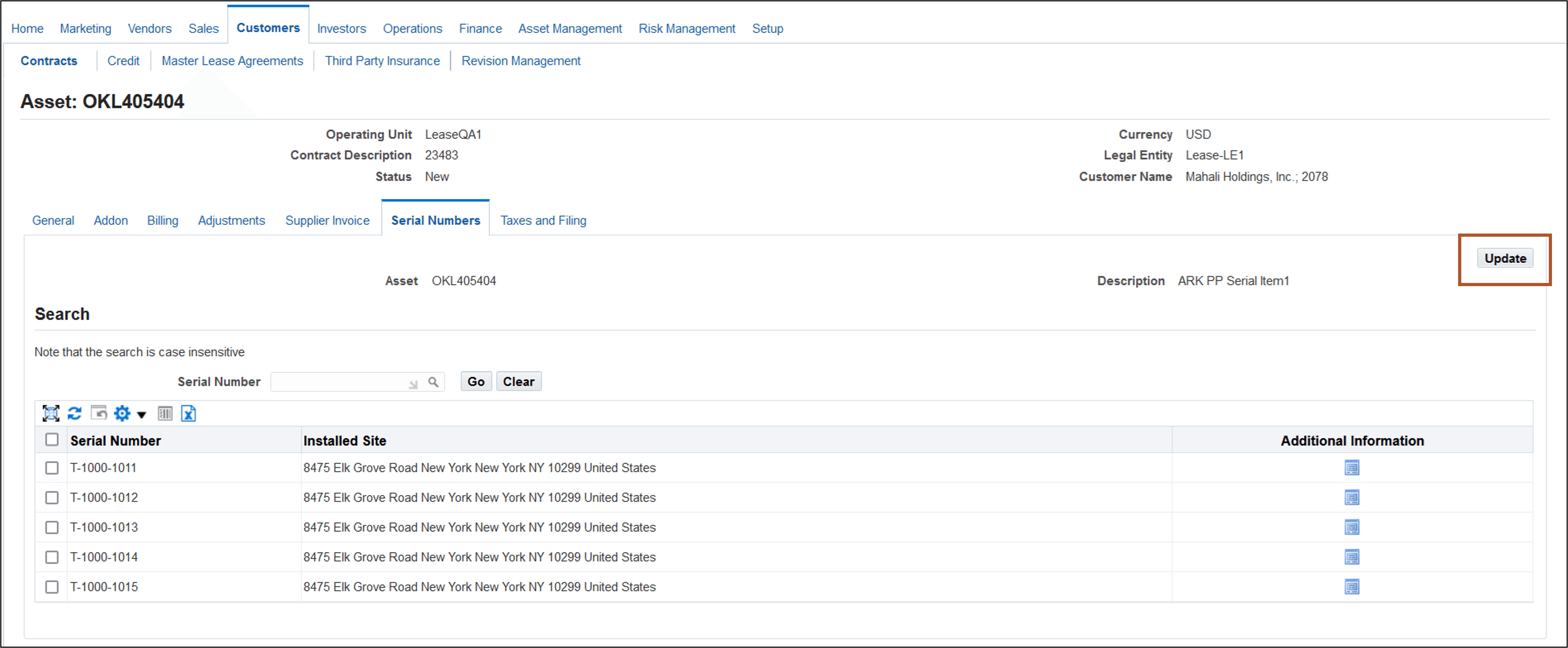

  4. Select Update and click on Additional Information.

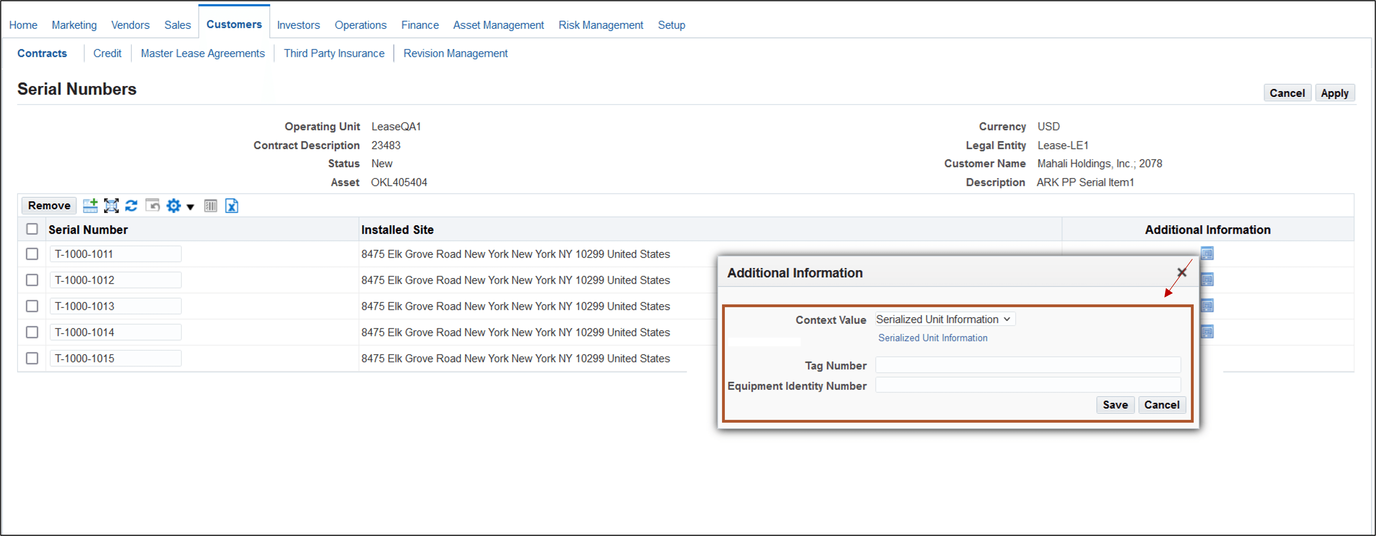

  5. Select the context for serialized lease units and enter additional information.

View Asset Details
View Asset Details
Add Serial Numbers
Add Serial Numbers
Update Serialized Units
Capture Additional Information

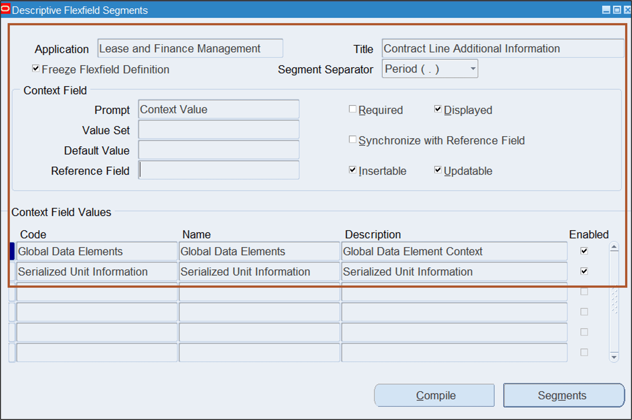

  1. Configure the Contract Lines Additional Information Flexfield.
  2. Define a context field and add segments to capture additional information for serialized leased asset units.
  3. Freeze the flexfield definition.
Configure Descriptive Flexfield
