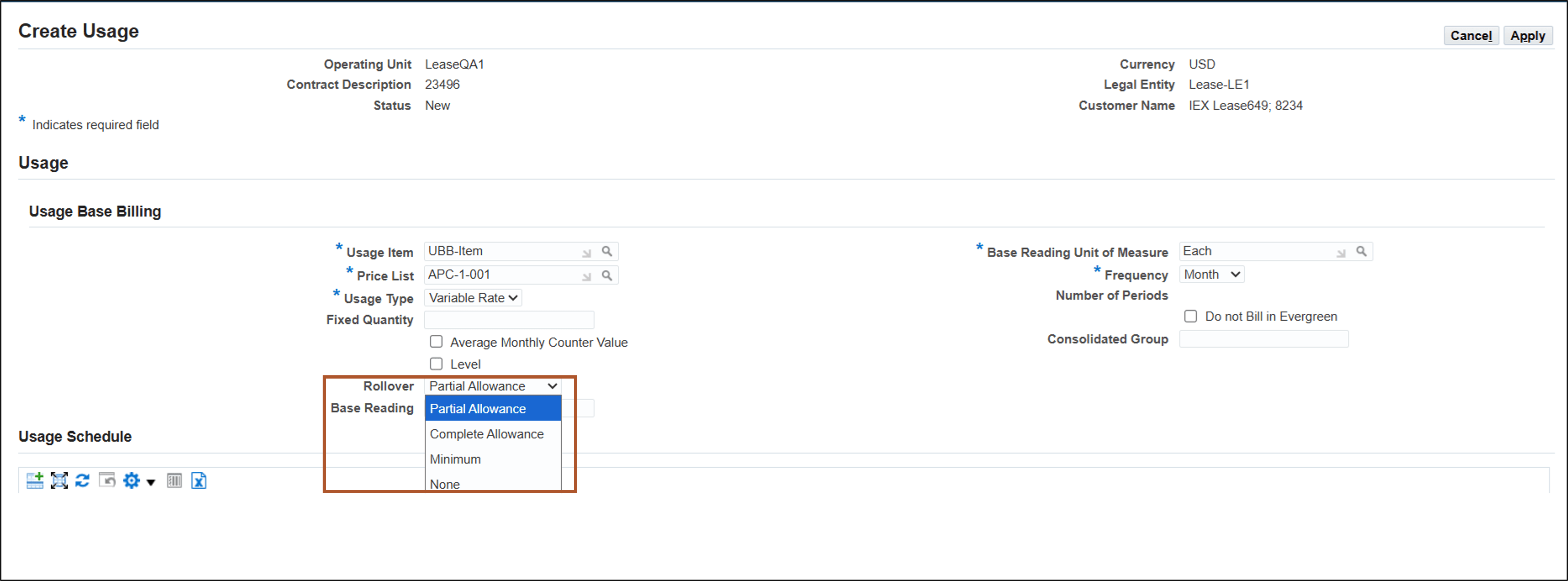

To configure usage pricing terms with rollover options:
  1. Create a contract and add assets
  2. Create a usage line
  3. Enter required attributes such as Usage Item, Price List, Base Reading Unit of Measure, and Frequency.
  4. Select Usage Type as Variable Rate.
  5. Select a Rollover option to indicate whether unused allowance or minimum carries over to the next period:
    • Partial Allowance: Allowance that is fully unused rolls over to the following period. If the allowance is partially used, then the remaining unused allowance rolls over to the following period.
    • Complete Allowance: Allowance that is fully unused rolls over to the following period. If any part of the allowance is partially used, then the remaining unused allowance does not roll over to the following period.
    • Minimum: Any unused minimum that the customer has paid for rolls over to the following period.
    • None: Unused allowance or unused minimum do not roll over to the following period.
The following screenshot displays the Create Usage page with Rollover options highlighted:
Create Usage page
Create Usage page
