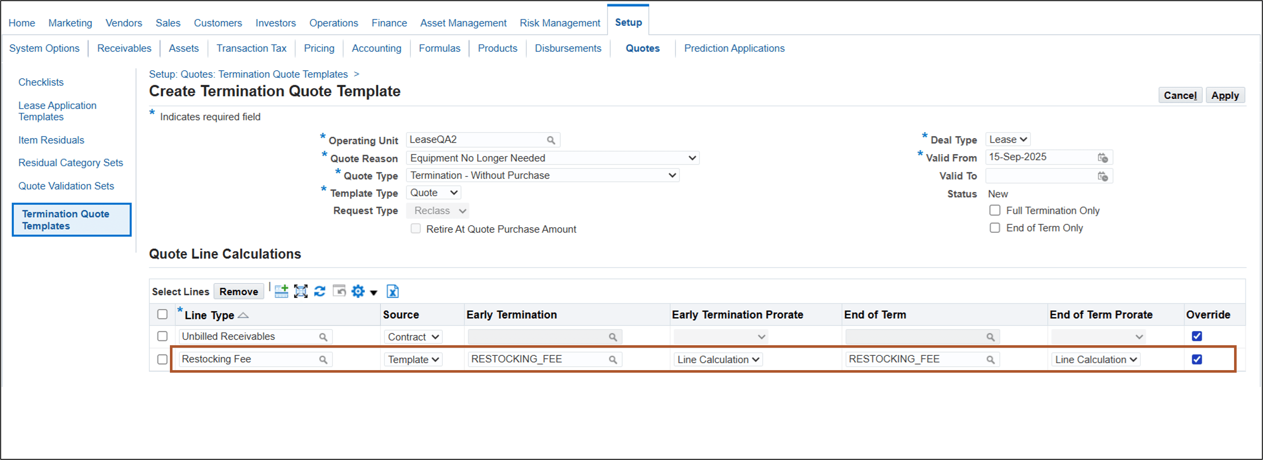

  1. Navigate to Setup > Quotes > Termination Quote Templates
    • Create a termination quote template and enter the required attributes such as Quote Type, Quote Reason, and Deal Type.
    • Add standard quote line types as needed.
    • Select the user-defined quote line type from the list of values for Line Type.
    • Select Source as Template and enter the formula and prorate options to calculate amounts for early and end of term termination.
    • Activate the termination quote template.

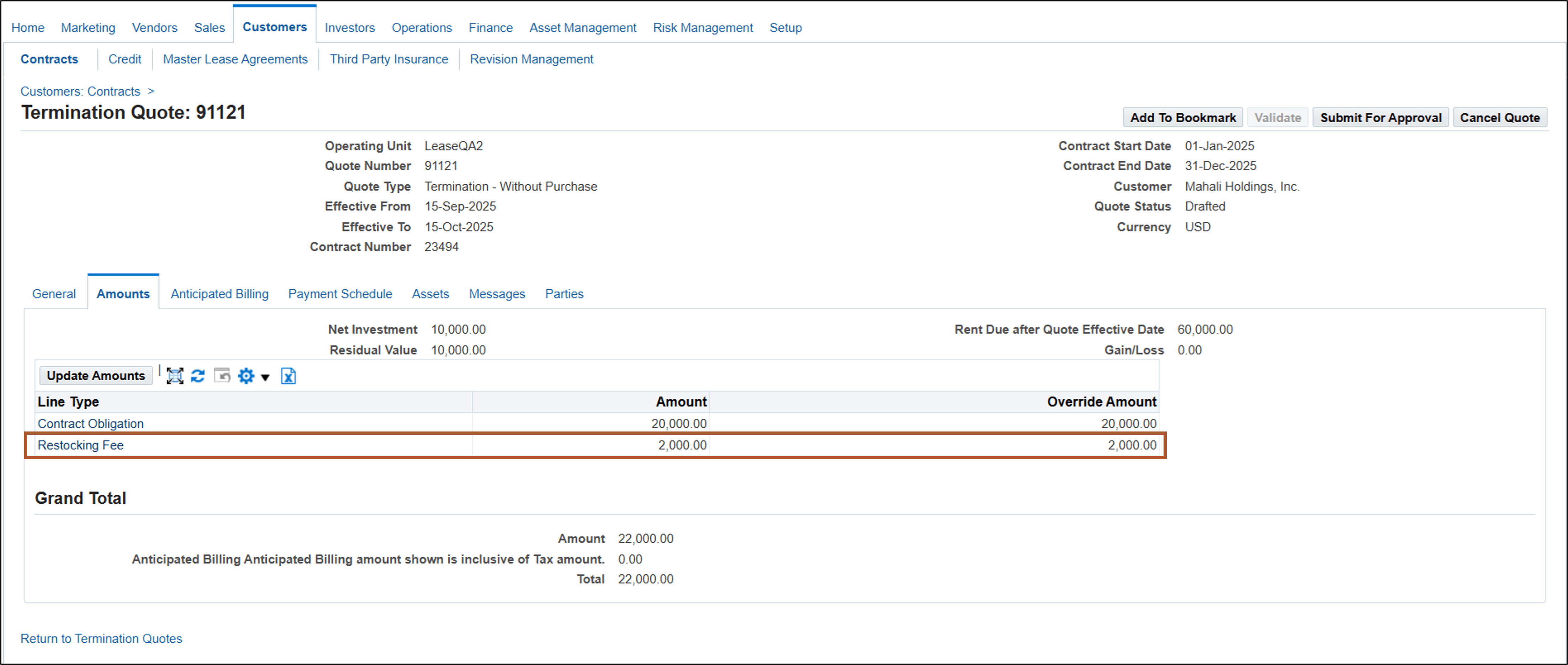

  2. Create a termination quote with Quote Type and Quote Reason associated with the above active template.
  3. The quote is created with both the standard and user-defined quote line amounts calculated based on the template.
  4. Approve and accept the termination request and process the termination transaction.
  5. The termination invoice is created for both the standard and user-defined quote line amounts.

Create Termination Quote Template

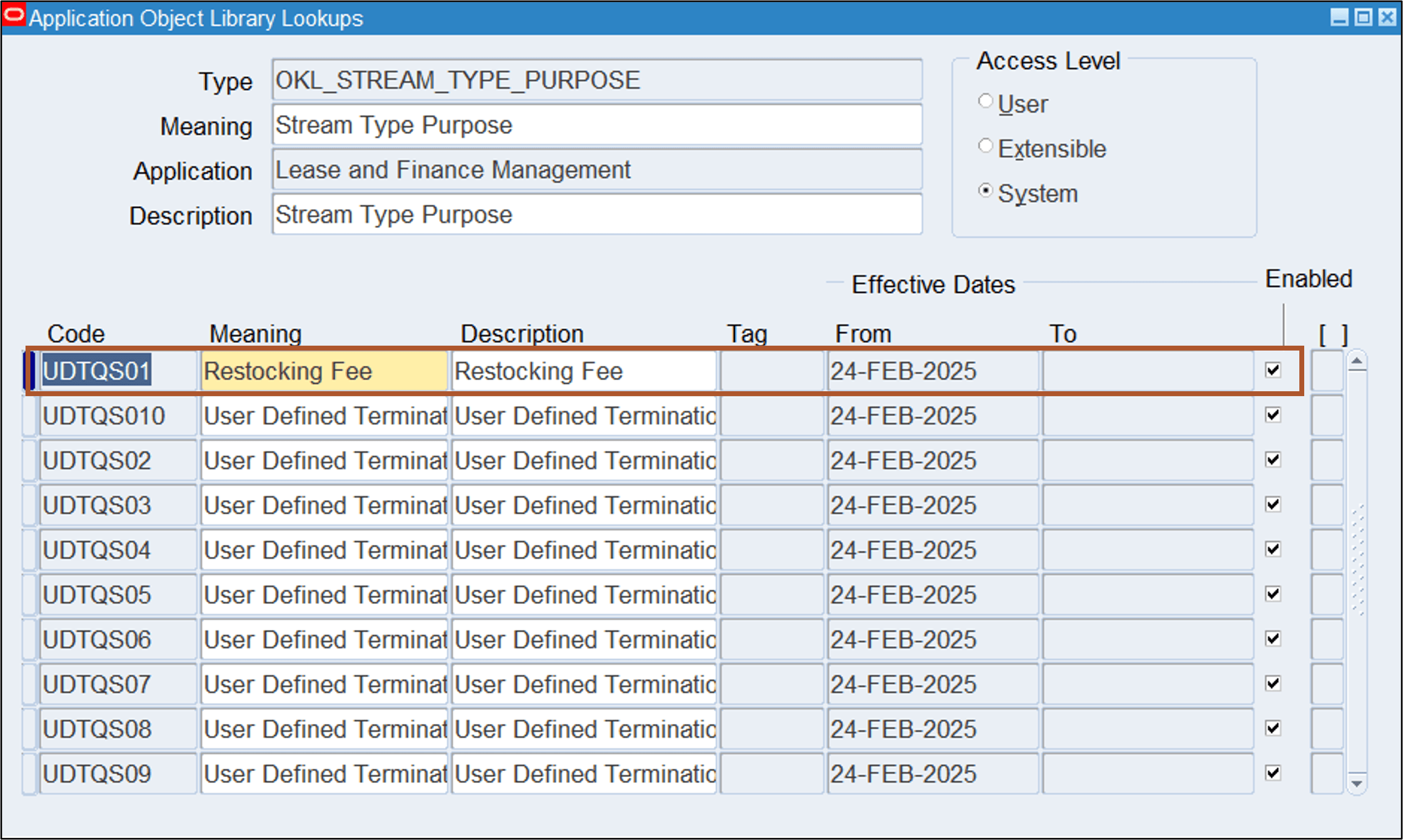

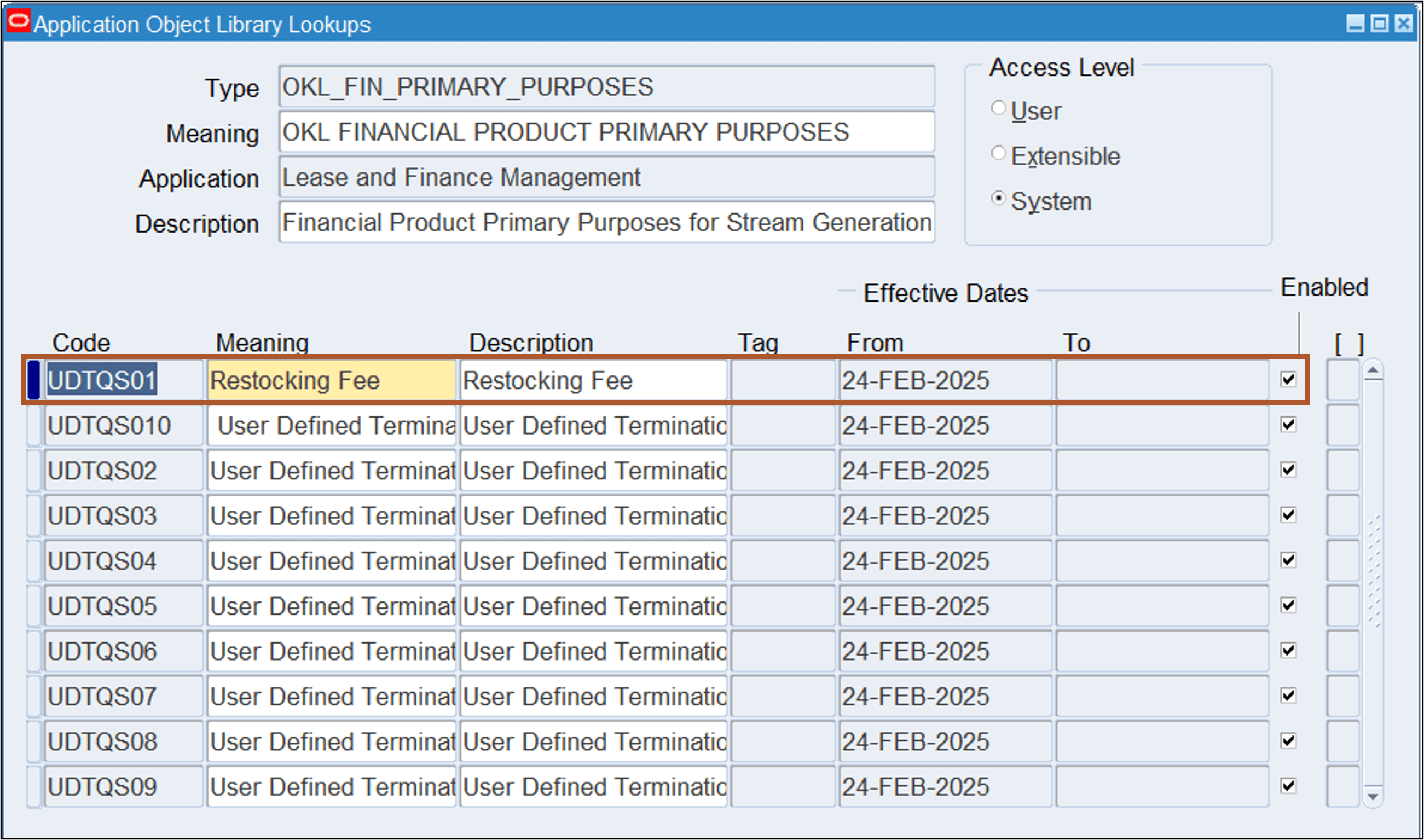

  1. Navigate to Application Developer > Application > Lookups > Application Object Library
    • Find Lookup Types OKL_STREAM_TYPE_PURPOSE and OKL_FIN_PRIMARY_PURPOSES.
      • Ten new lookup codes UDTQS01, UDTQS02 through UDTQS10 have been added to support configuring user-defined termination quote stream purposes.
      • Update the meaning and description for the user-defined termination quote stream purposes as needed.

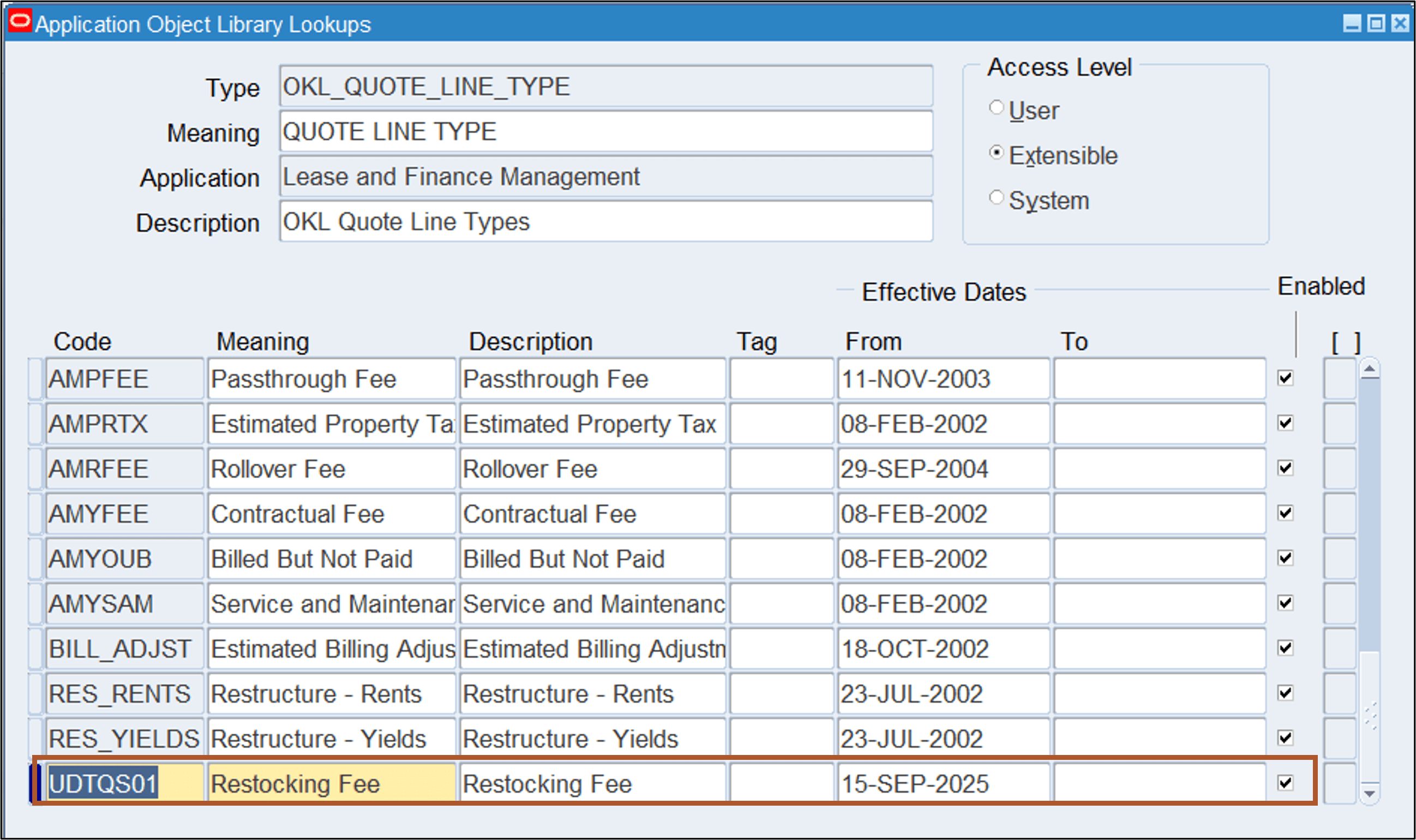

    • Find Lookup Type OKL_QUOTE_LINE_TYPE
      • Add up to ten lookup codes UDTQS01, UDTQS02 through UDTQS10 to configure user-defined quote line types.
      • The lookup code values must be the same as the newly seeded lookups in OKL_STREAM_TYPE_PURPOSE lookup type for user-defined termination quote stream purposes.
      • Update the meaning and description for the user-defined termination quote line types as needed.

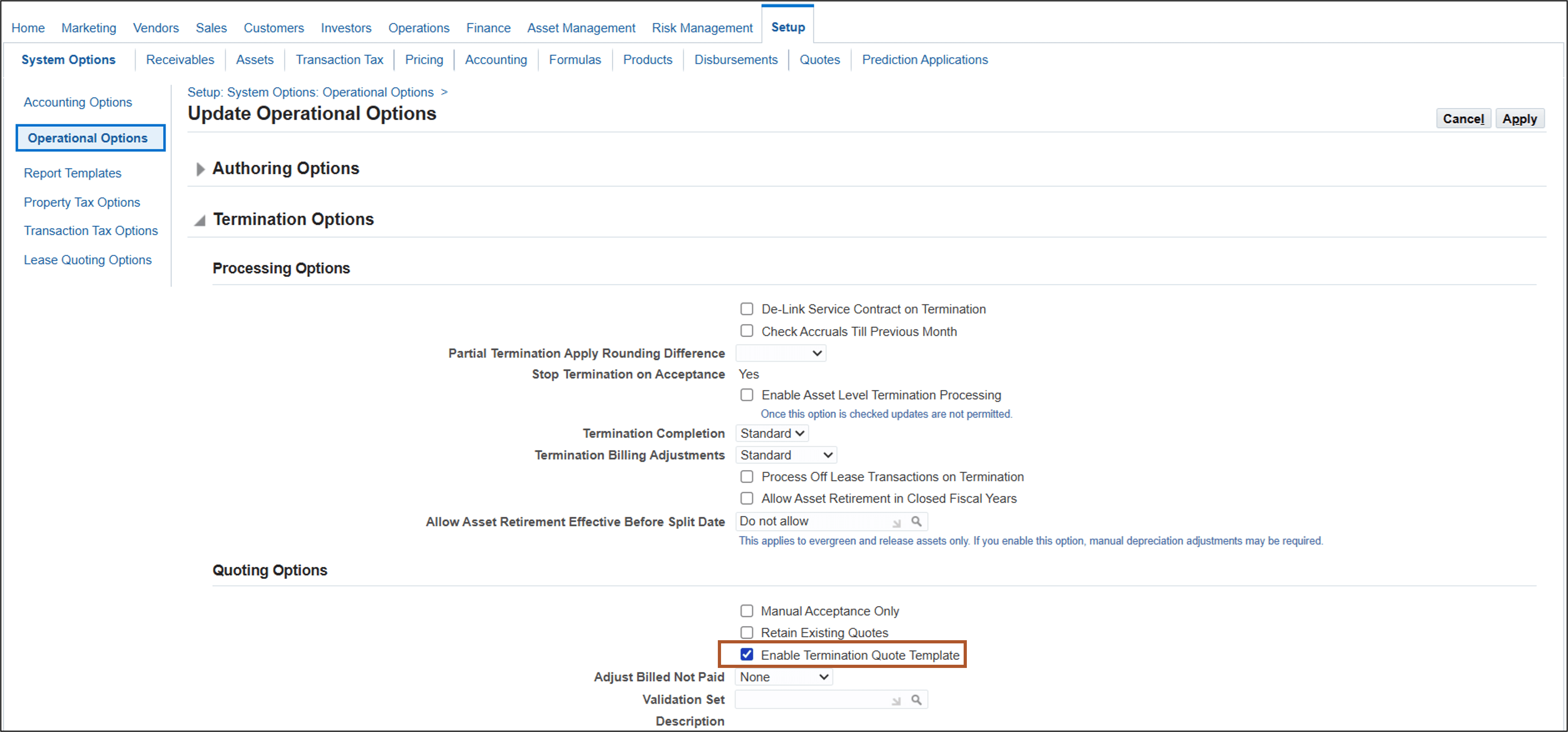

  2. Navigate to Setup > System Options > Operational Options
    • Enable the Termination Quote Template system option.

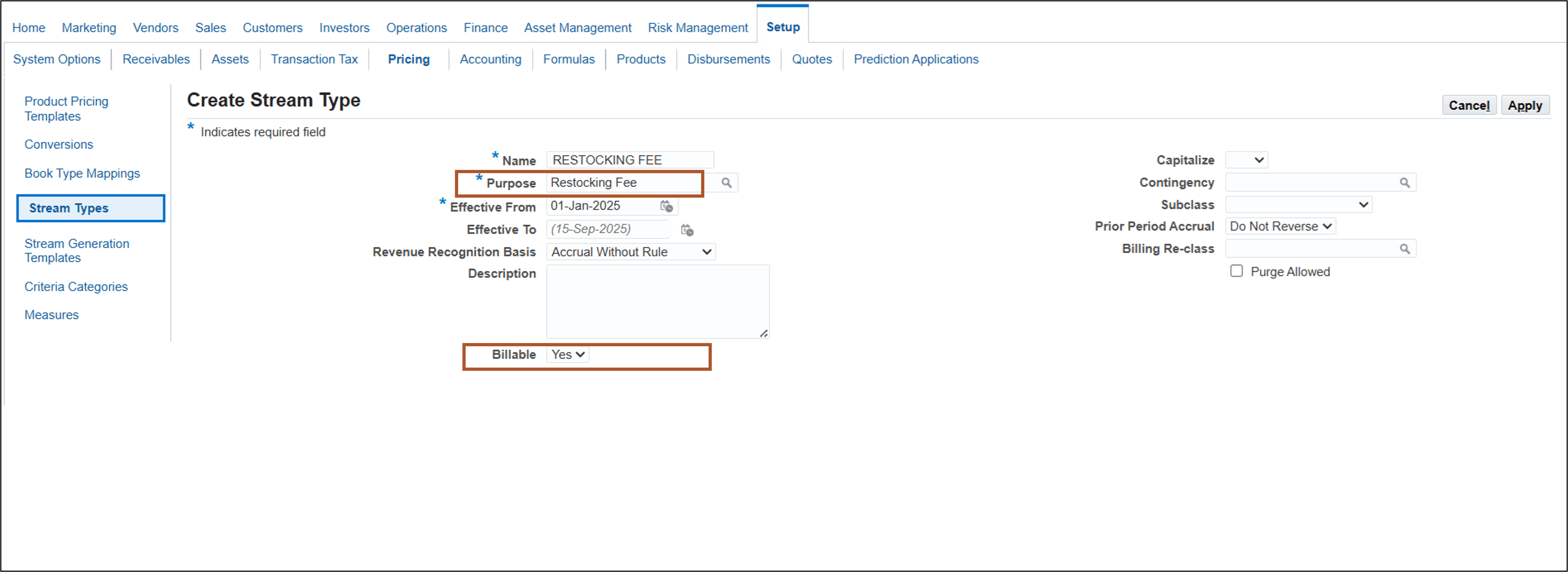

  3. Navigate to Setup > Pricing > Stream Types
    • Create a Stream Type and select the one of the ten user-defined termination quote stream purposes.
    • Select the Billable flag as Yes.

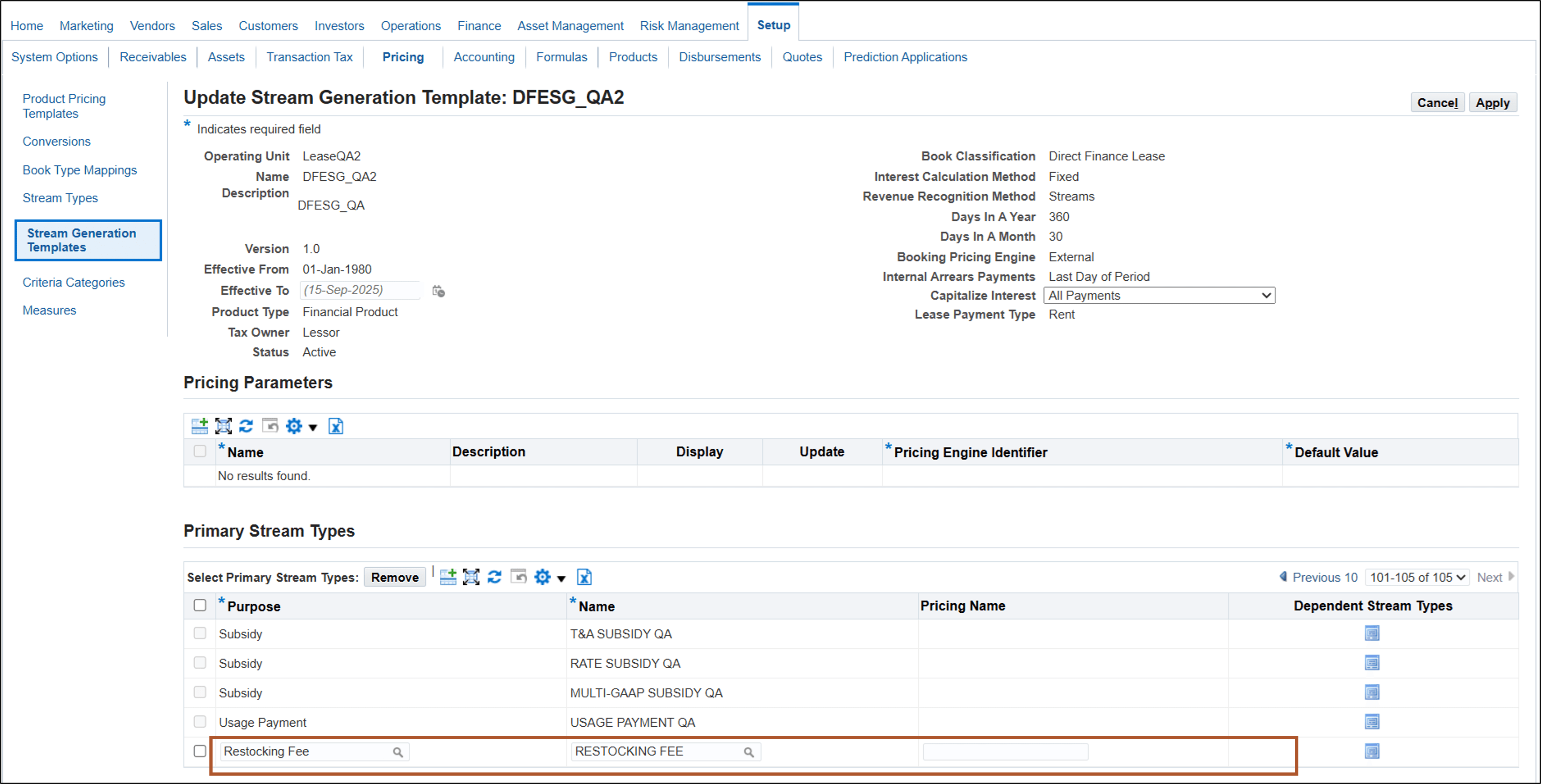

  4. Navigate to Setup > Pricing > Stream Generation Templates
    • Find and select the Stream Generation Template for update.
    • Add the user-defined termination quote stream type as a Primary Stream Type.

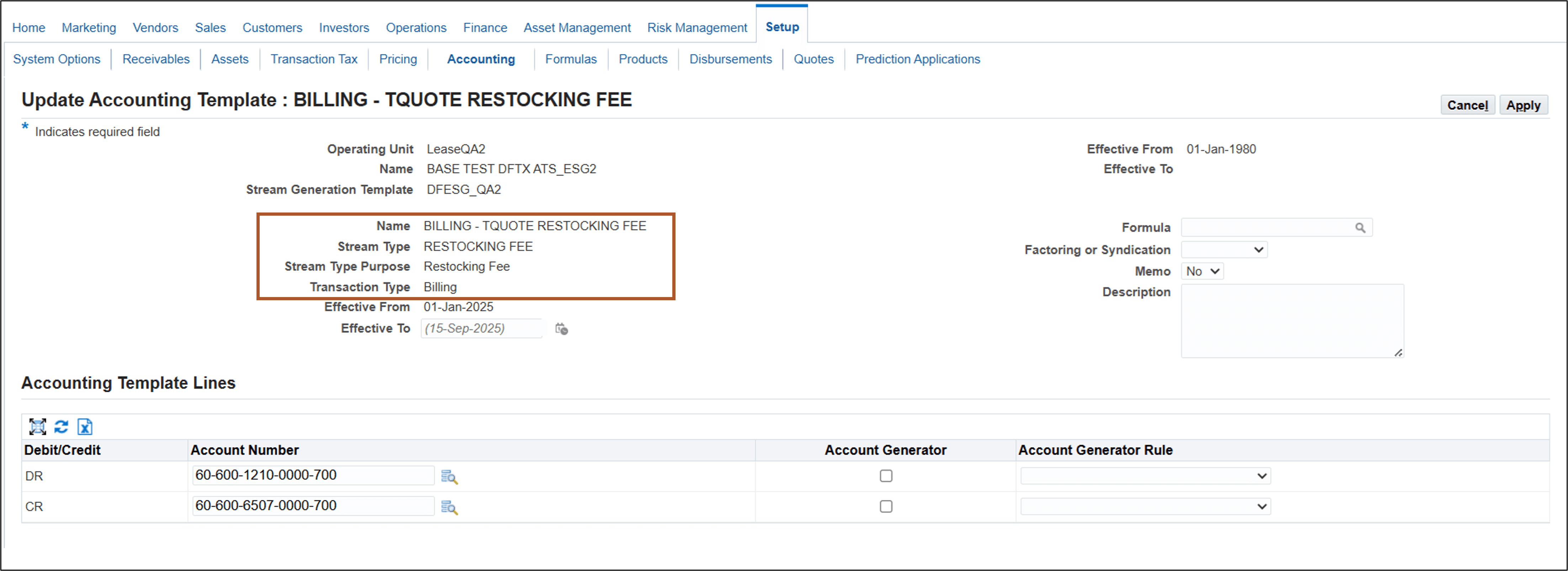

  5.  Navigate to Setup > Accounting > Accounting Template Set
    • Find the Accounting Template Set associated to the above Stream Generation Template.
    • Create an accounting template for the user-defined termination quote stream type with the Transaction Type as Billing.

Define Stream Type Purpose Lookup
Define Financial Product Primary Purposes Lookup
Define Quote Line Types Lookup
Configure System Options
Create Stream Type
Create Stream Type
Update Stream Generation Template
Update Accounting Template Set
