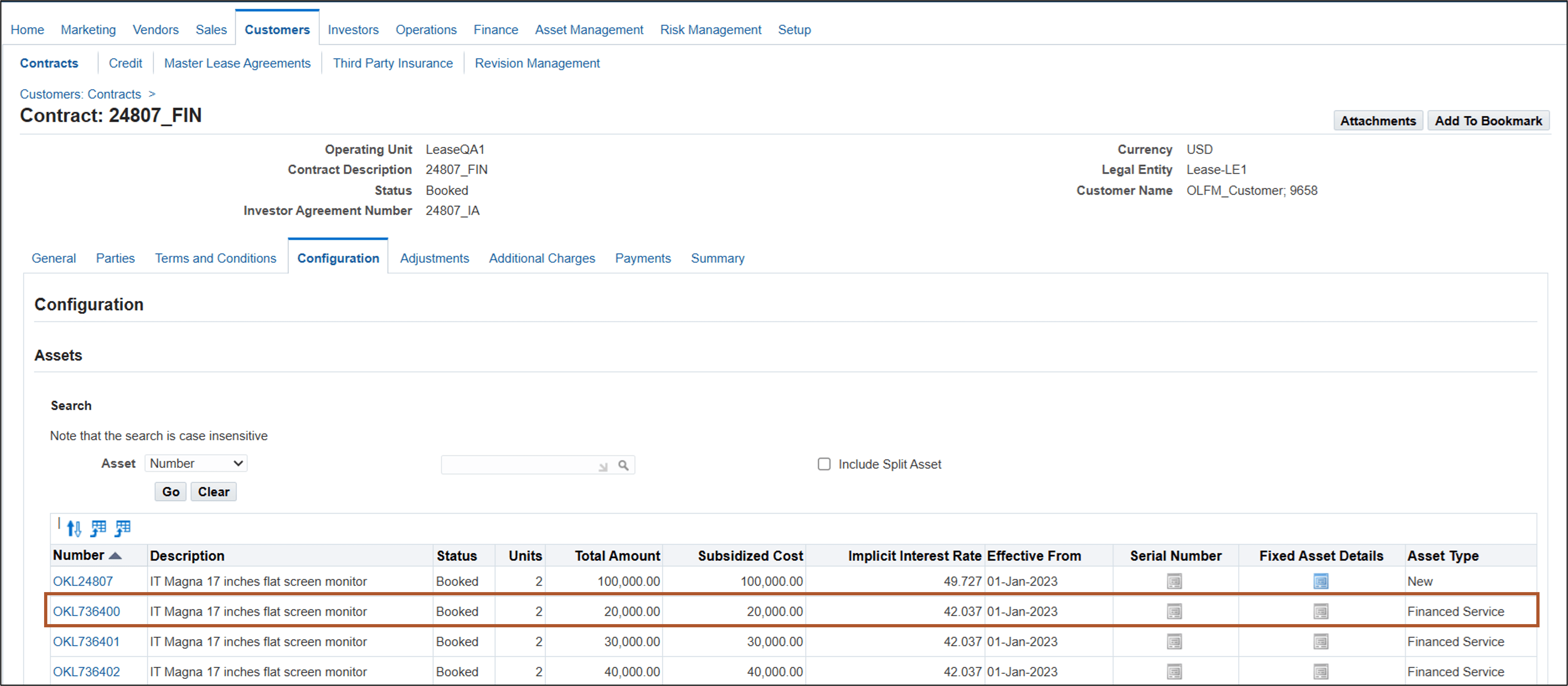

Create Contract with Financed Service Asset

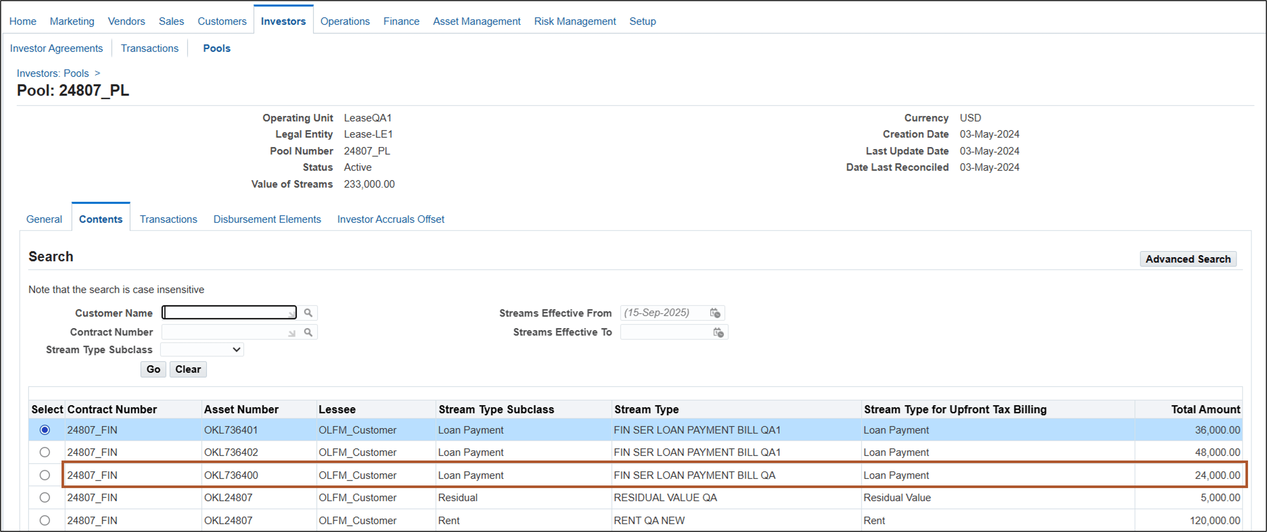

Create Fixed Pool
Create Fixed Pool

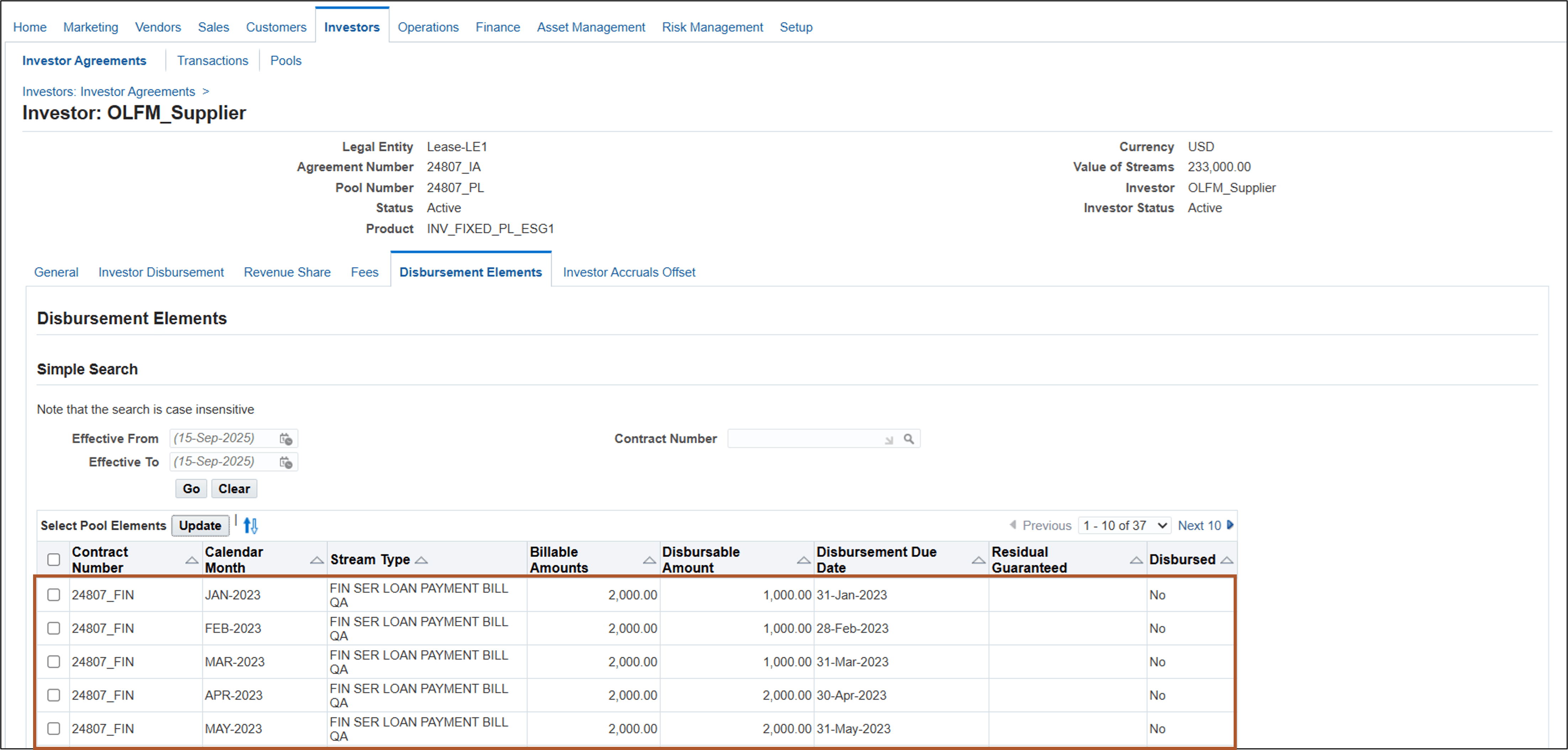

Create and Activate Investor Agreement

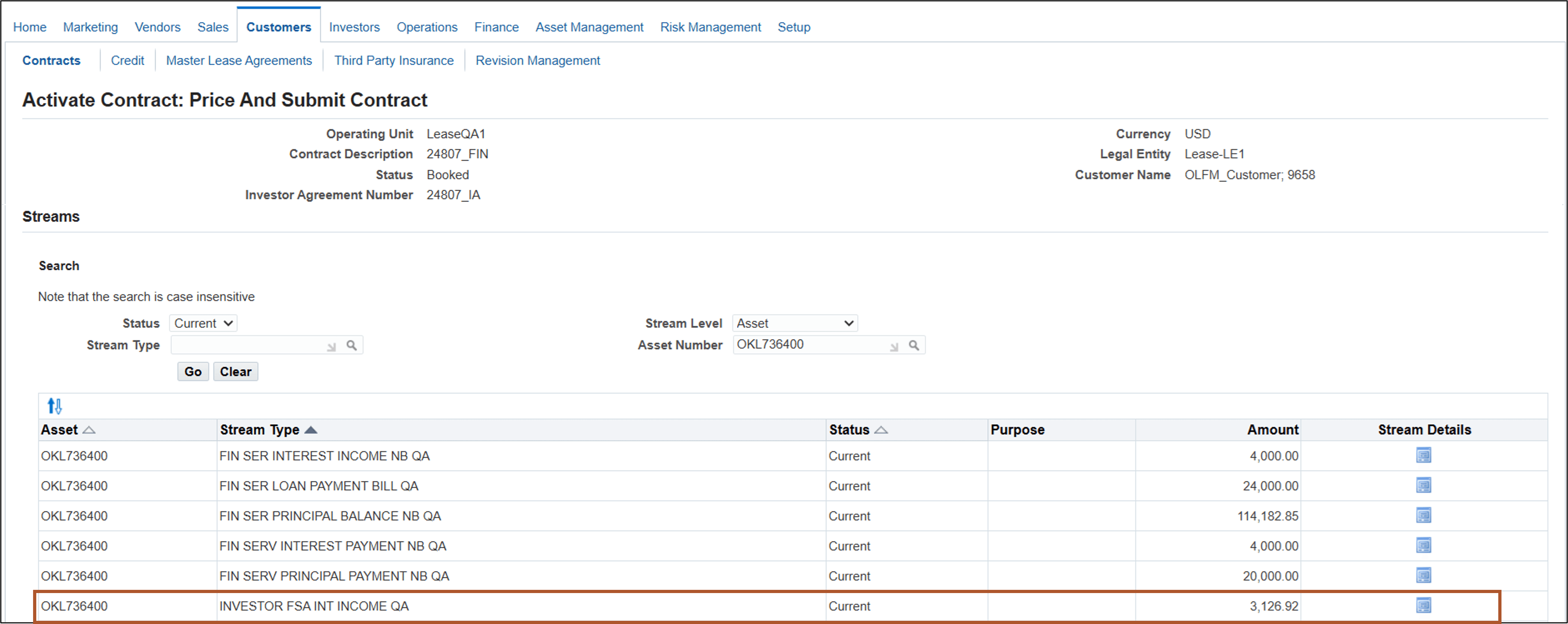

View Contract Streams
