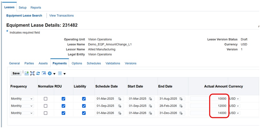

Equipment Lease
Equipment

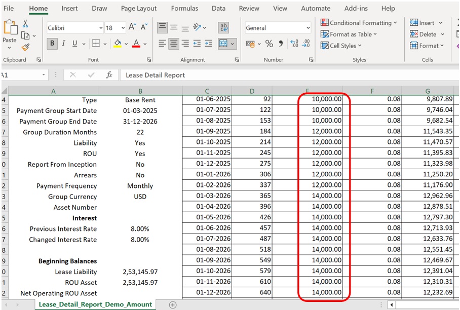

Booking LDR
  1. Approve and export Schedules to Oracle Payables till the Amortization Commencement Date -1.

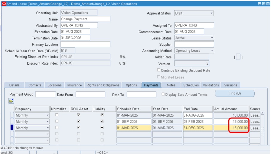

  2. Amend the lease for the amend terms. You can modify amounts for payment terms that meets the conditions listed earlier.
Property Lease
Property amend

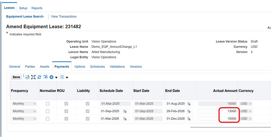

Equipment Lease
Equipment Amend

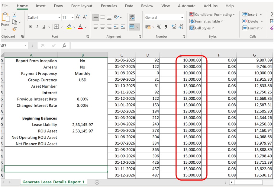

  3. Verify the  Lease Details Report after amendment as shown in the following diagram:
             Amend LDR
