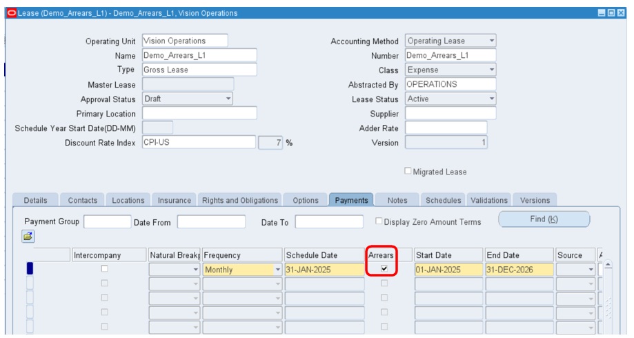

  1. Create Lease with all the required information. Enter property or asset details and Save.
  2. Define payment terms. While defining the payment term, enable Arrears checkbox and provide Schedule Date as the last day of the frequency period. With this definition, payment is considered to be made at the end of the frequency period. Interest will be calculated for the complete period before payment.
Property Lease
The following diagram displays the new option in the Property Lease form:
 Property

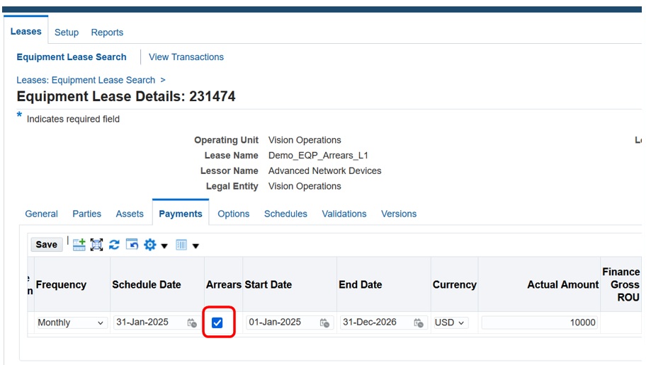

Equipment Lease
The following diagram displays the new options in the Equipment Lease Details page:
Equipment

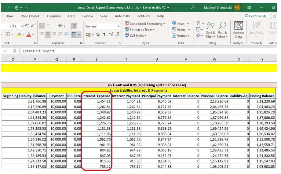

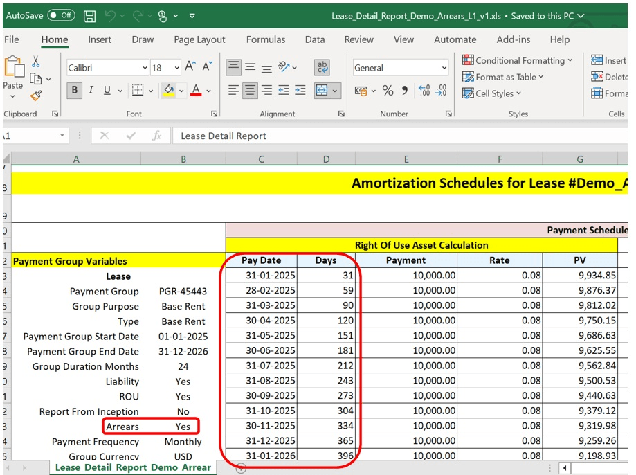

      4.  Verify the Lease Details Report.
    1. Present Value is calculated for the complete month as the payment is made at the end of the month.
    2. Interest Expense is calculated as interest before the payment for the complete period.as shown in the following diagram:.
PV
Interest expense
