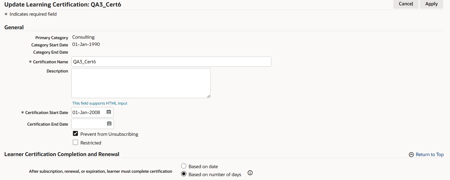

To prevent learners from unsubscribing from a learning certification, administrators can now select the new Prevent from Unsubscribing checkbox. If an administrator selects this check box, then the Unsubscribe field in the Certification Information section, Learning Certification page for learners is automatically displayed as No.If an administrator selects the Prevent Unsubscribing check box, then the Unsubscribe field in the Certification Information section, Learning Certification page for learners is automatically displayed as No.
Steps to enable and configure
  • Identify certifications where learners should not be allowed to unsubscribe themselves.
  • Set the Prevent from Unsubscribing option on the Certification setup page.
  • Test the learner self-service view to confirm the learner cannot remove themself from the certification.
