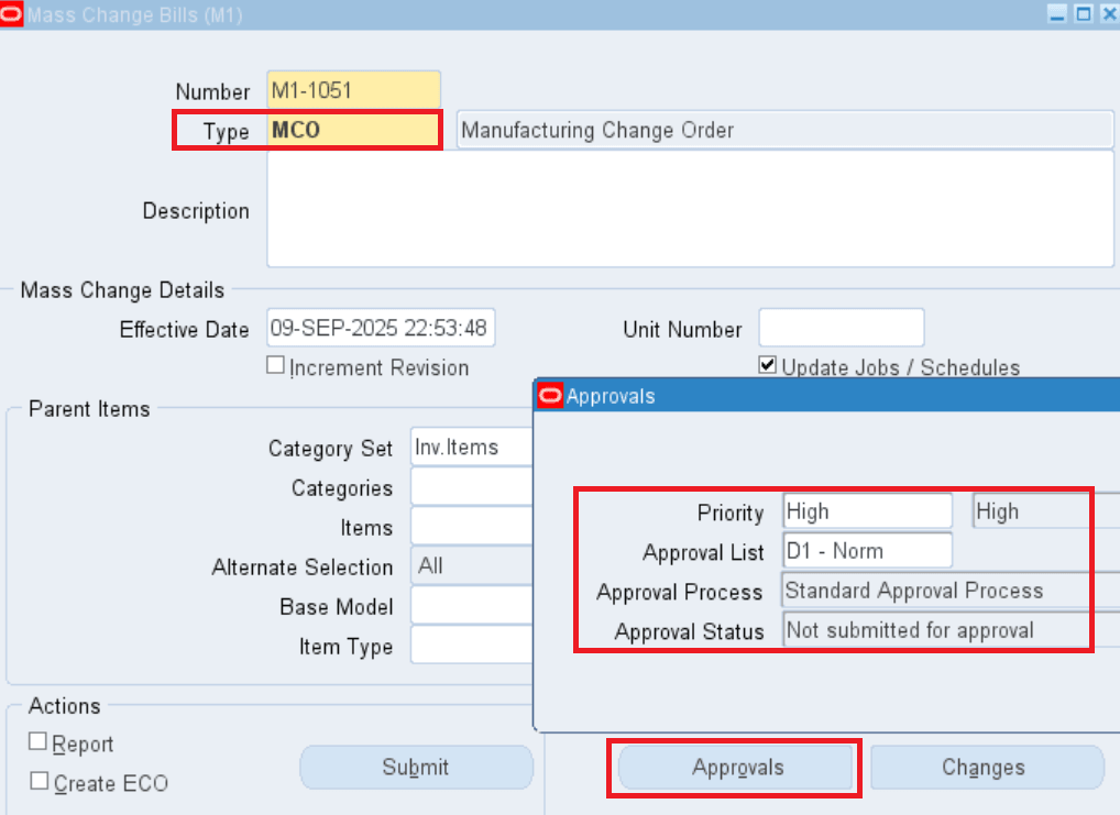

As shown in the example below, you can select the change type in the Mass Change Order and specify the priority and approval list in the Approvals window to define the approval process.
Mass Change Order
Mass Change Order

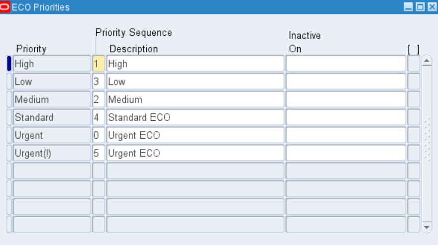

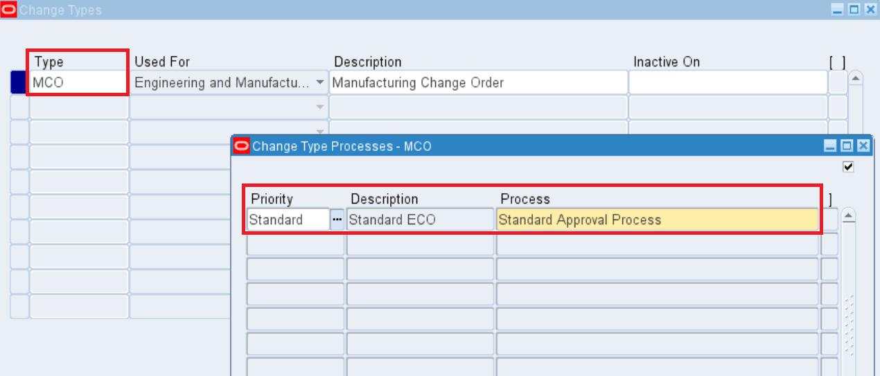

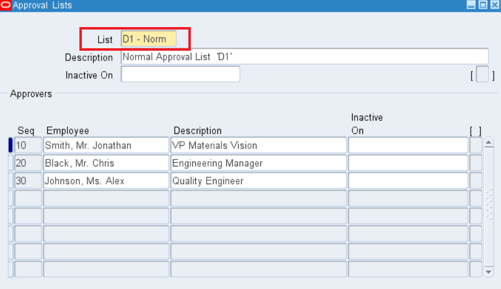

Choose the Change Type, ECO Priorities, and Approval List to enable the approval process.
Priority
Priority
Change Type
Change Type
Approval List
Approval List

Existing change types configured for approval process for Engineering Change Orders can be used for Mass Change Orders. If you want to create a different approval work flow, you can create a new change type for Mass Change Orders approval process.
