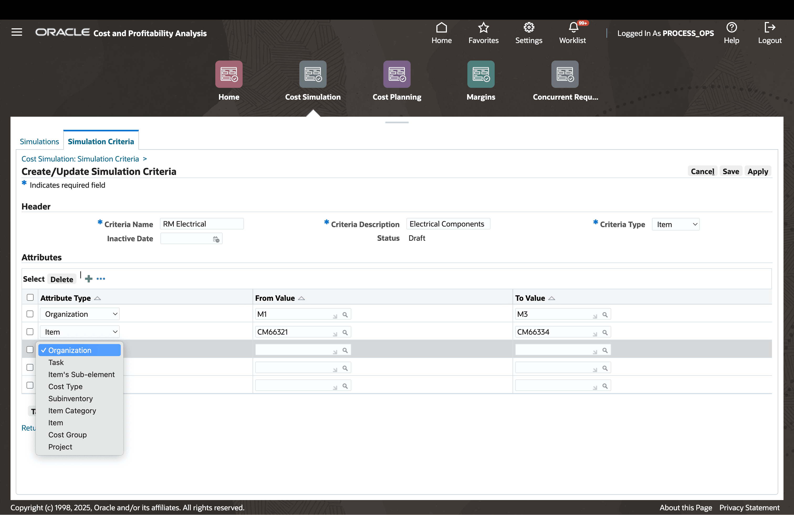

  1. Metadata setup — create reusable Simulation Criteria. In the metadata configuration, users define named Simulation Criteria (a group of items, resources, or overheads within one or more inventory organizations). These are reusable sets used for recurring simulations. Examples:
    • All raw materials whose costs are renegotiated together
    • Imported goods sensitive to exchange rates
    • Items subject to similar tax/duty provisions
    • Commodity inputs whose prices fluctuate or are determined post-consumption (e.g., metals)

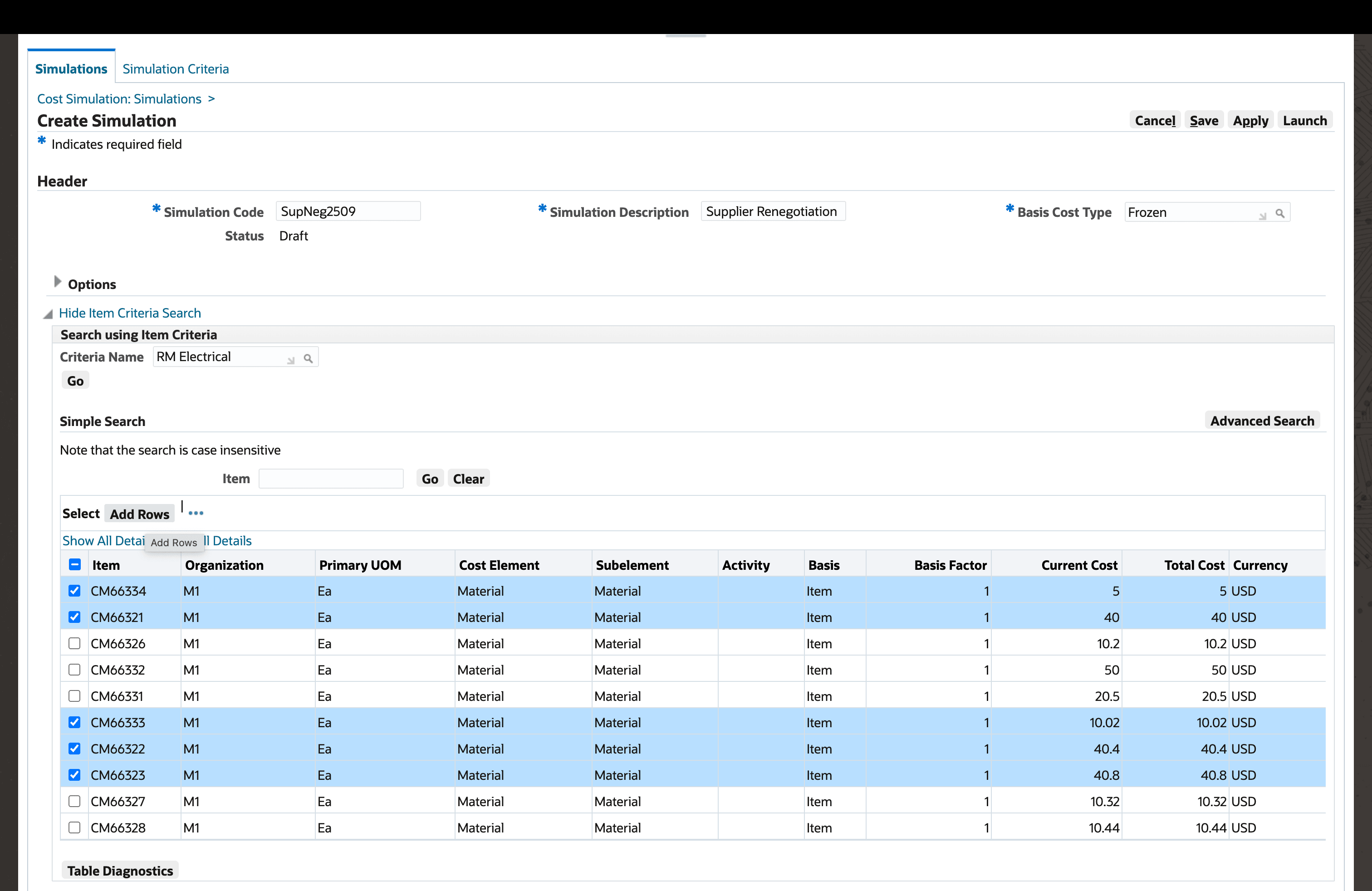

  2. Create a simulation — pick or define criteria.
When creating a simulation, users may select a predefined Simulation Criteria for recurring activities, or build a one-off criteria directly on the simulation screen (a manual list of items/resources/overheads to change).
Create a Simulation Criteria
Create a Simulation using a Simulation Criteria

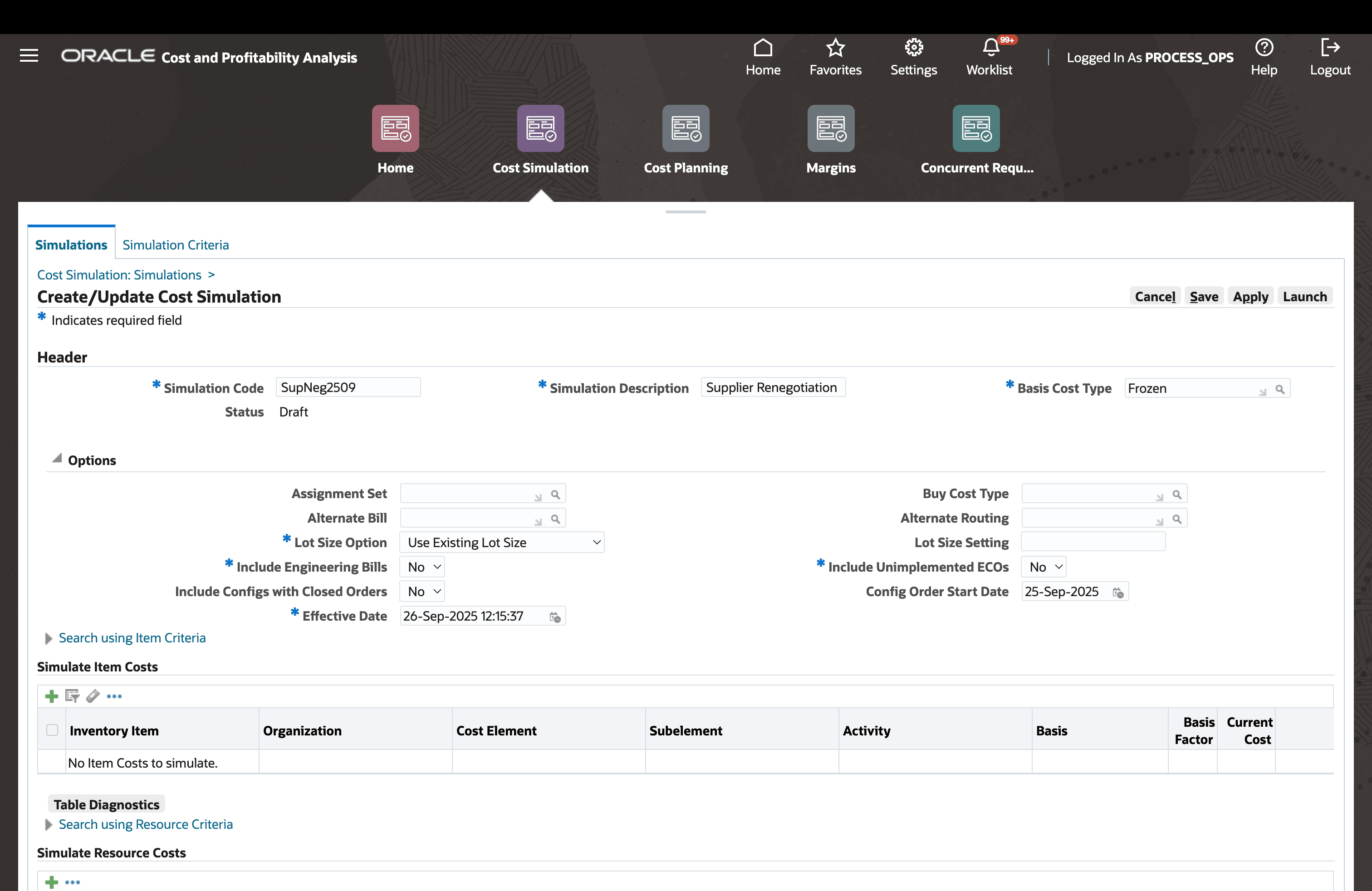

  • Select cost roll-up options.
    • Choose roll-up behavior to control how cost changes propagate — for example, simulate an engineering change, a process change, or a make-versus-buy decision (using sourcing rules).
Select roll-up options

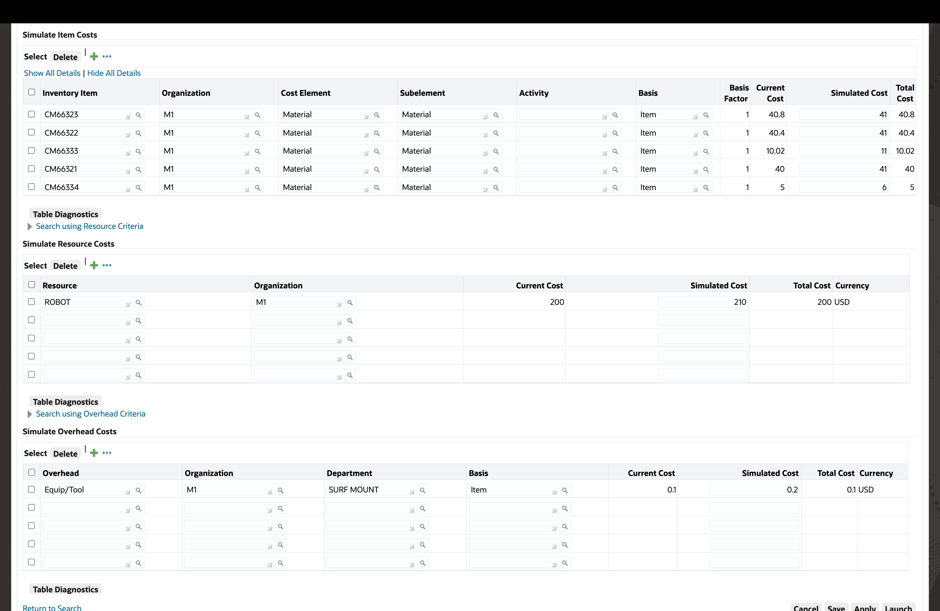

  • Provide change inputs and launch
    • Provide the list of entities, the cost change(s) (absolute or percentage), and the selected roll-up option, then launch the simulation.

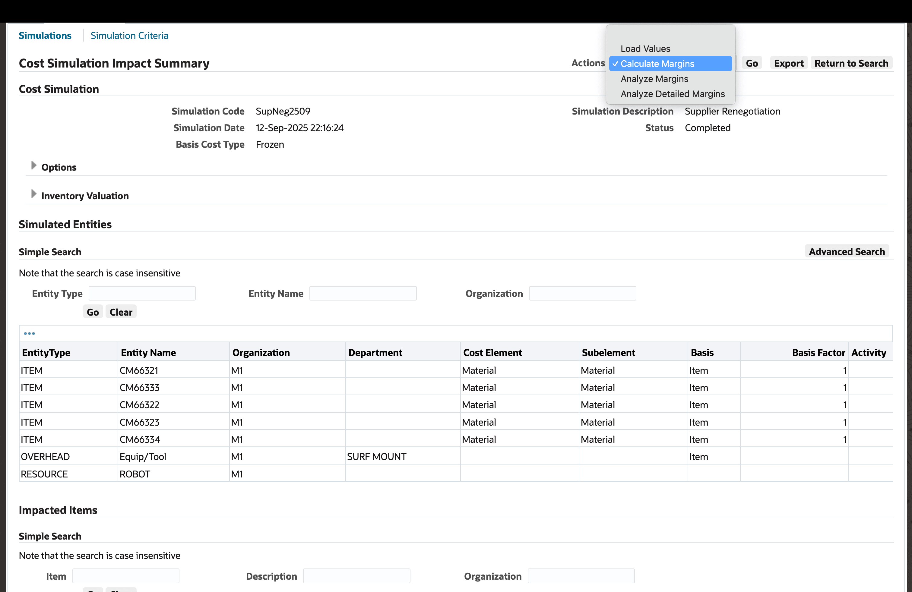

    • Create a Simulation for Changes in Item, Resource and Overhead Rates
      Create a Simulation for Changes in Item, Resource, and Overhead Rates

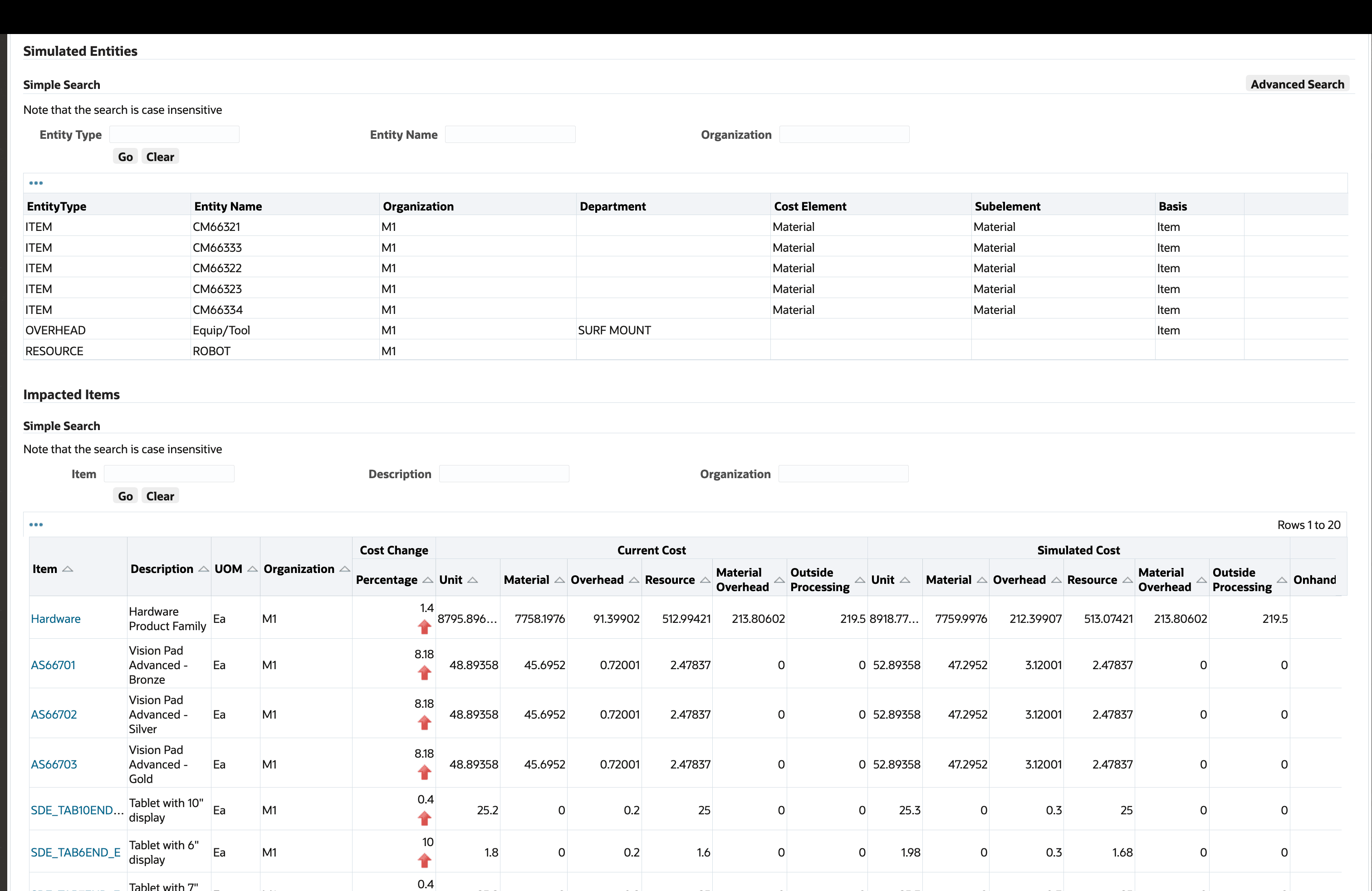

  1. Review impacted product list & valuation deltas
    • The simulation returns all products directly or indirectly affected by the change, showing percentage change in their product costs and quantified impacts to inventory, WIP and in-transit valuations that would result from implementing the change.
Review Impacted List of Items

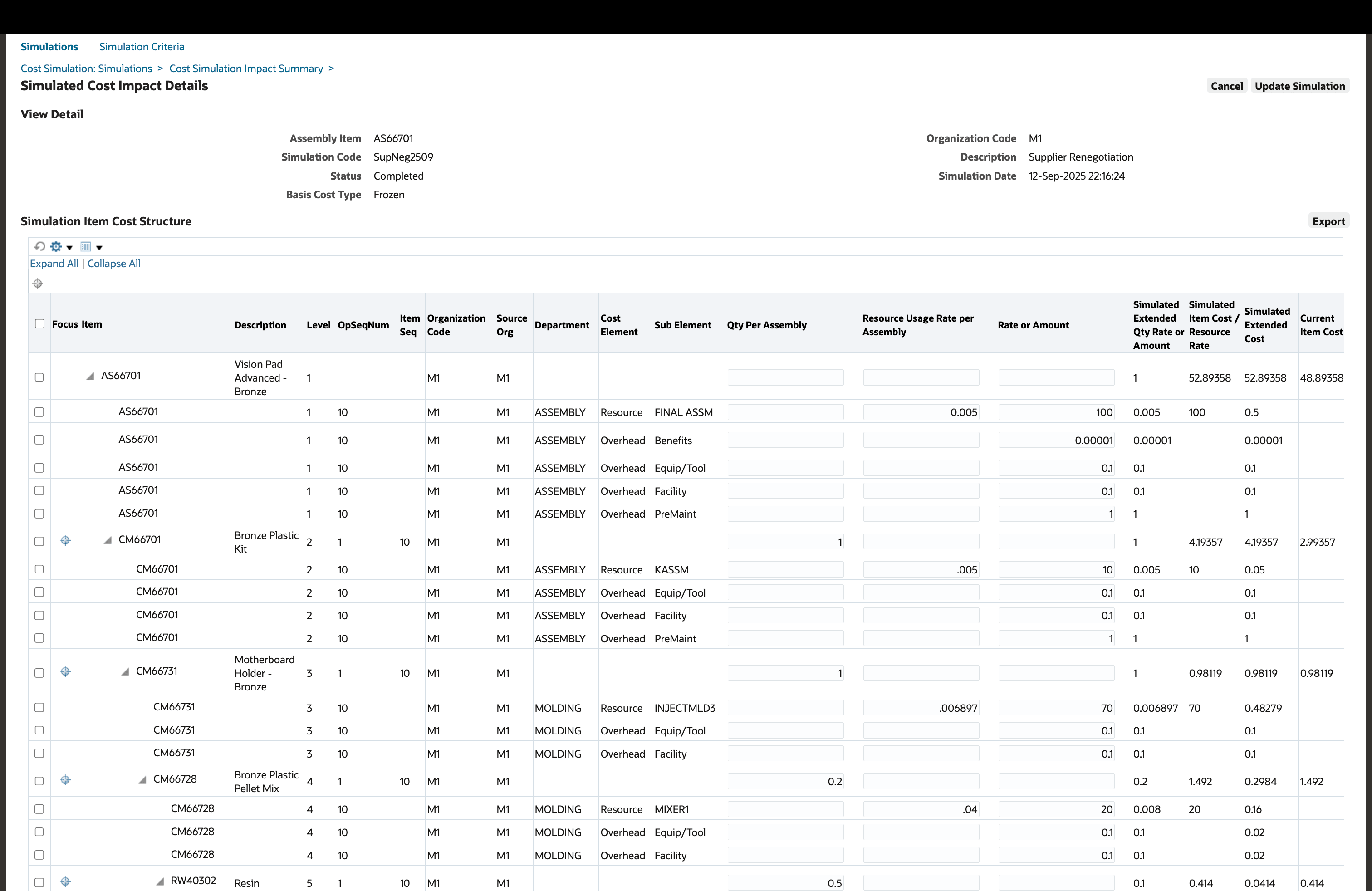

  1. Drill down to detailed multi-level cost views
    • Drill into any impacted product to view an indented, multi-level cost structure. The drill down clearly highlights cost elements that have changed and identifies one or more sources of change introduced by the simulation, making it easy to identify root causes.
Drill down through a Multi-Level Product Cost Structure and Trace the Cost Impacts Across Levels

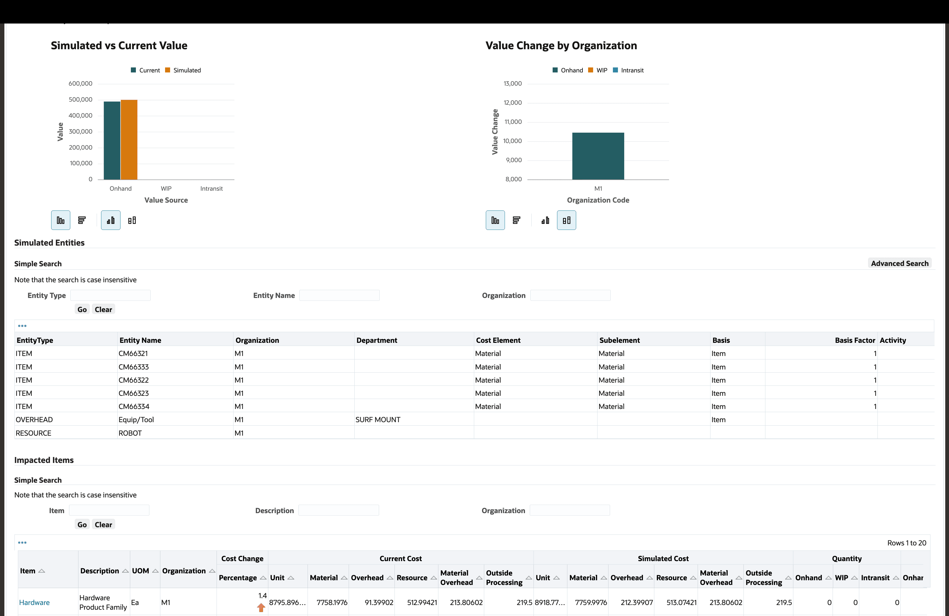

  1. Review impact to Valuation
    • The Current vs Simulated graphs and table values depict the expected impact to valuation if the simulated costs were to replace current costs.
Review Impact to Inventory, Intransit and WIP Valuation
