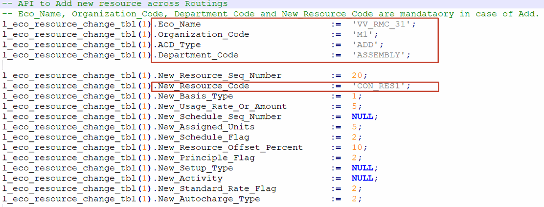

- Enter information for the Routing Resource Mass Change API parameters. The following example shows a new resource being added to a routing using the API:
