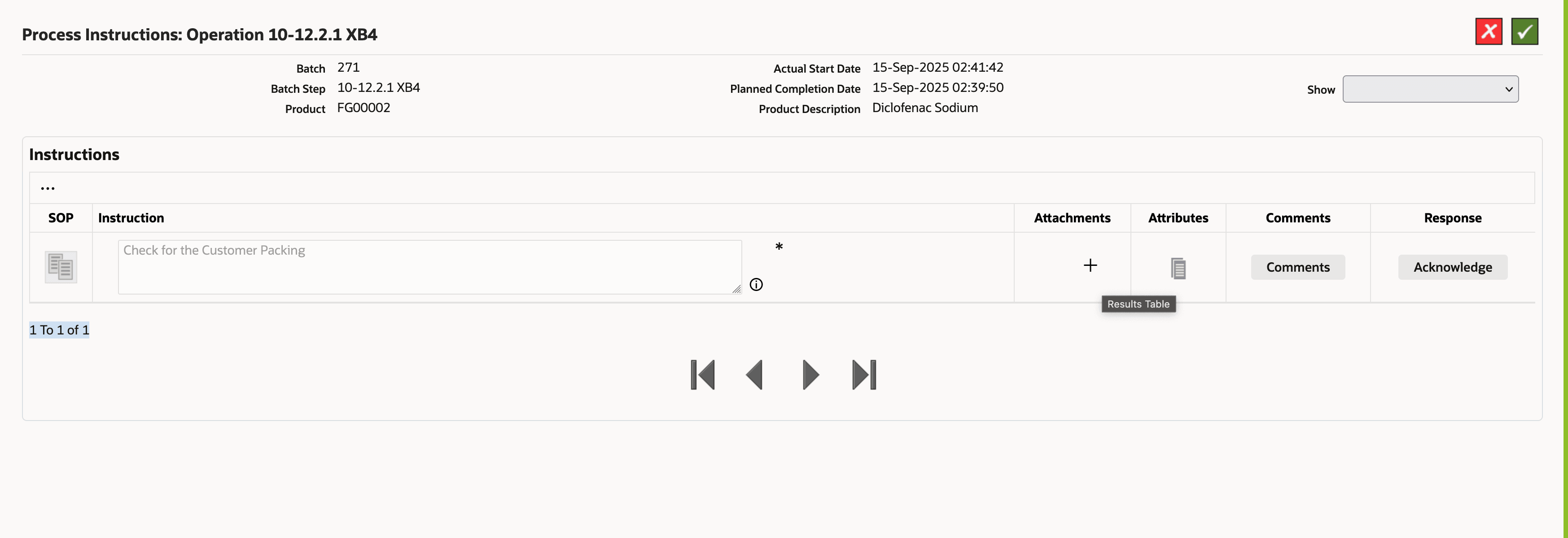

Execute Process Instruction
Execute Process Instruction for a Batch Step

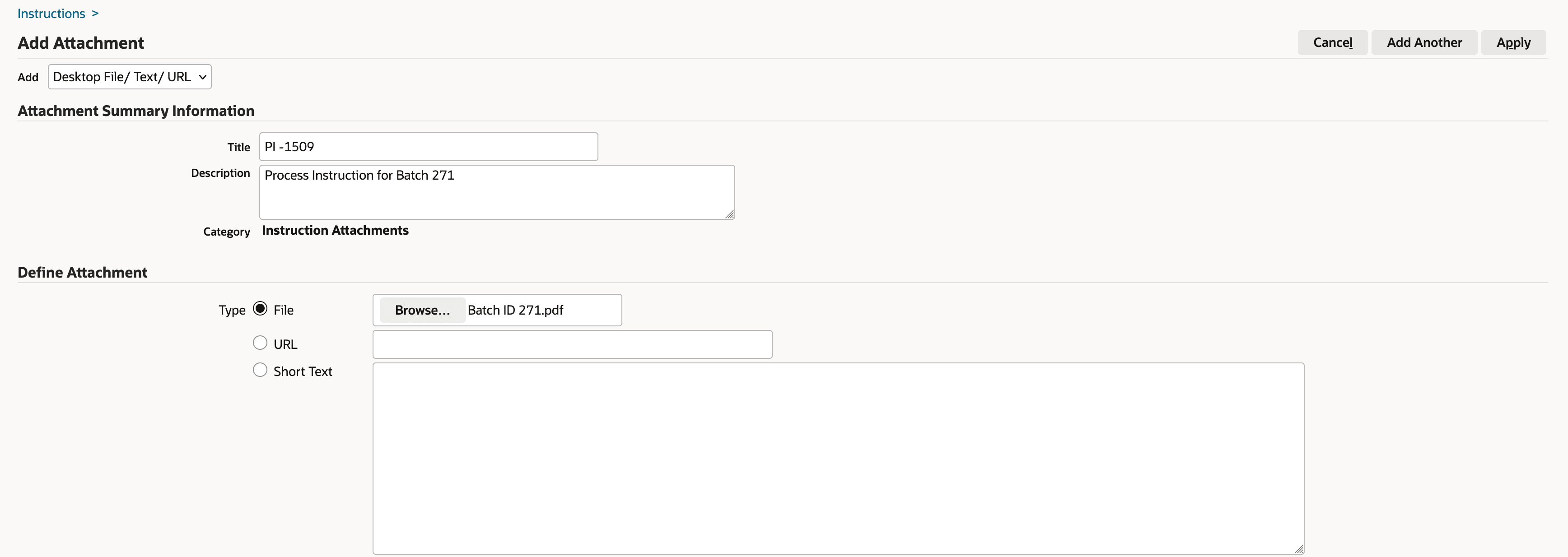

Attach Document
Attaching a Document

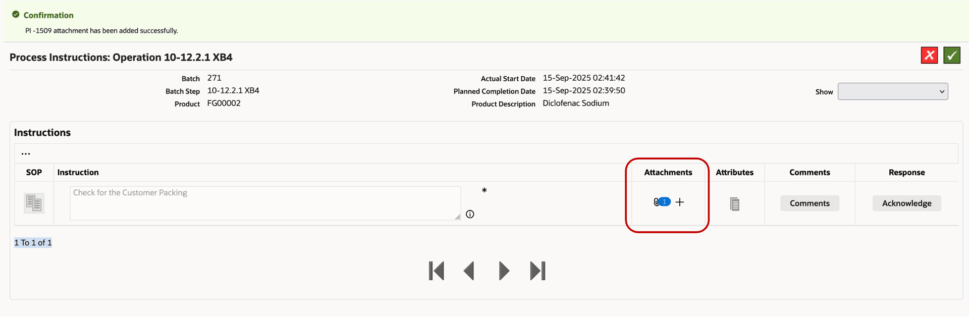

Document Attached against Instruction Set
Attached Document for an Instruction Set

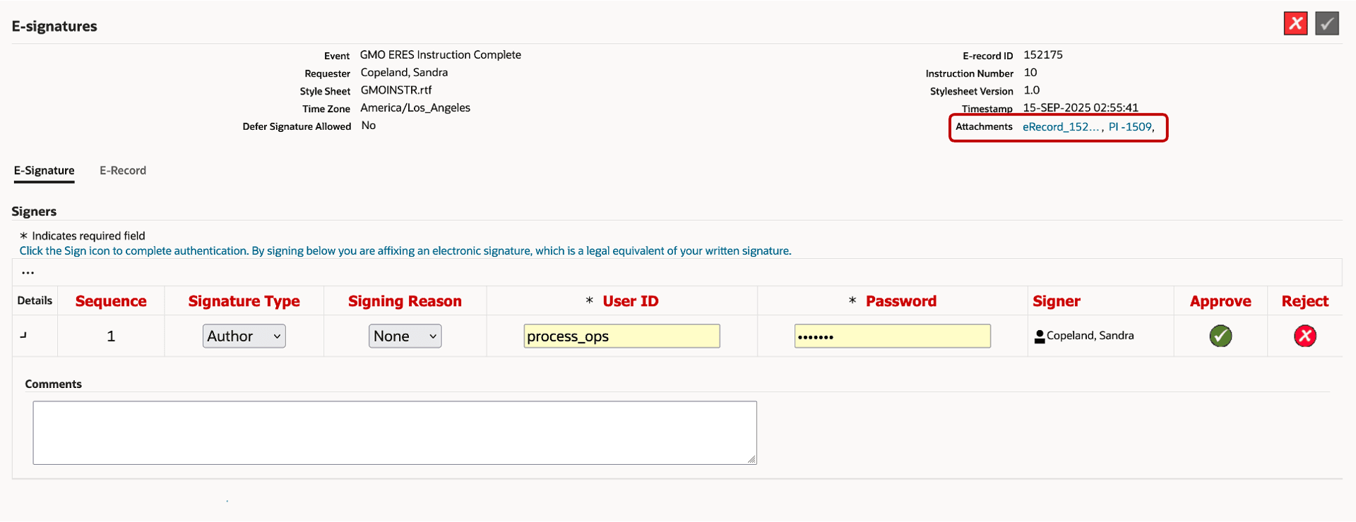

ERES Initiated
E-Signature initiated along with the attached document

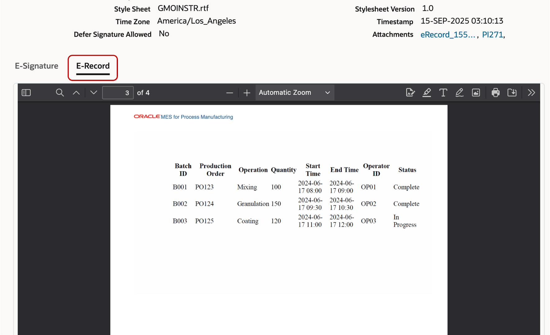

E-Record Tab showing Attached document
View the attached document under the E-Record tab

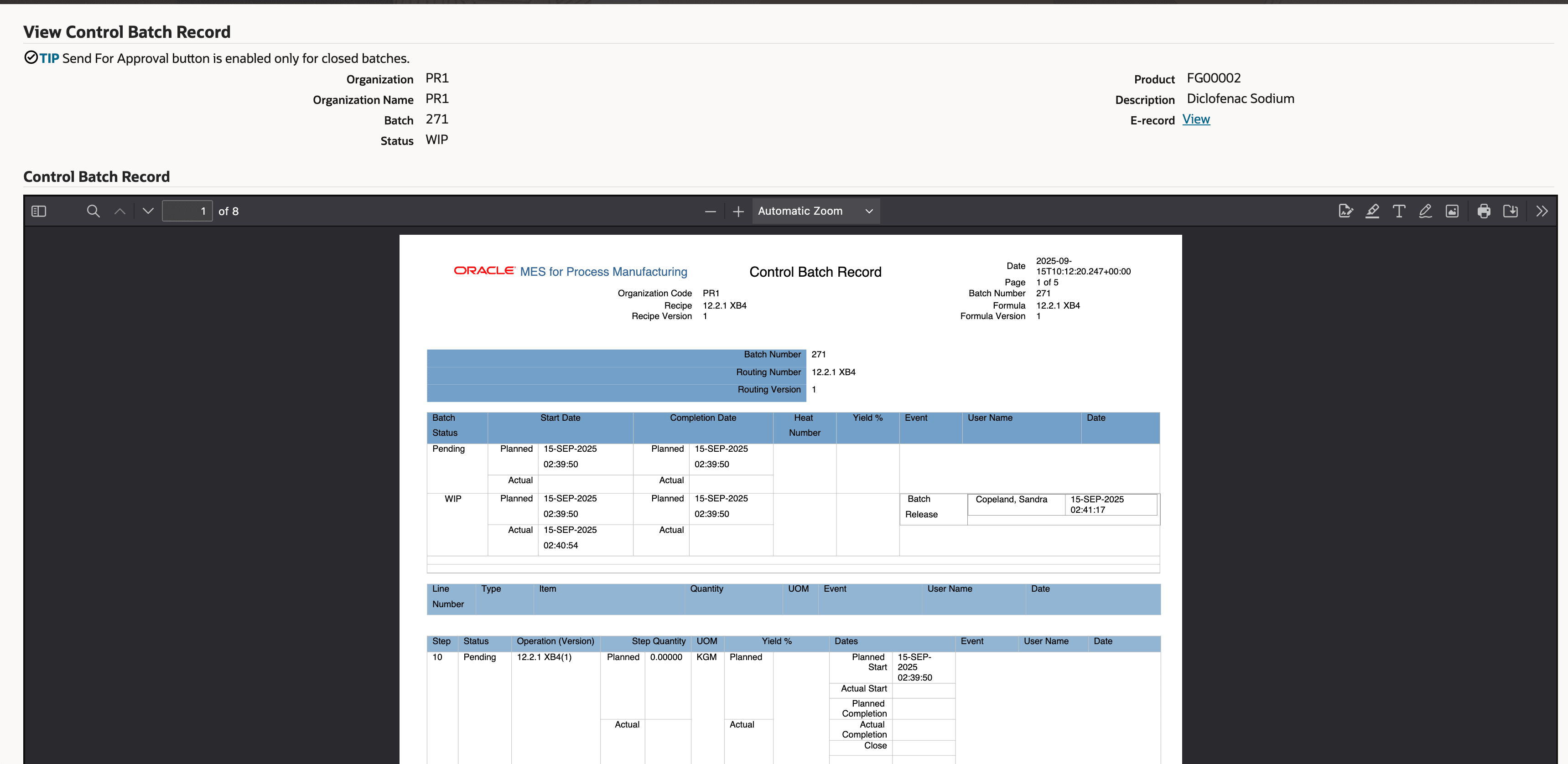

CBR Output
Control Batch Record created after batch transaction completion

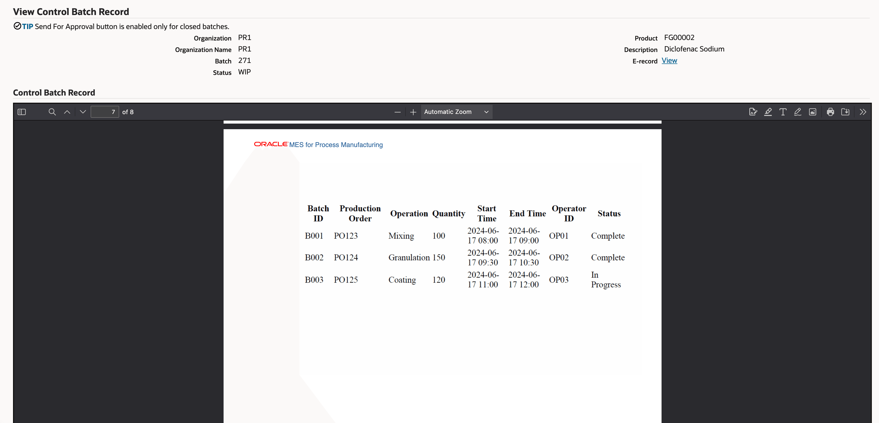

CBR with Attached Document
Attached Document Available in the last section of the CBR
