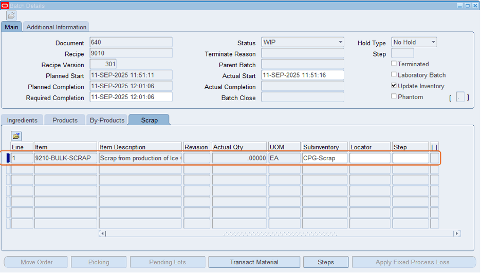

Tracking Scrap Using Predefined Inventory Items
When scrap is managed using predefined inventory items, users add the items to the Scrap tab in Batch Details. A reason code is mandatory for every scrap transaction, and Electronic Signatures (ERES) can be used for compliance. The process differs slightly for lot-controlled and non-lot-controlled items, as described in more detail below.

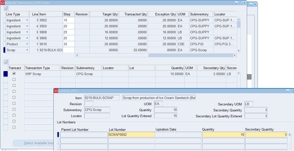

Lot-Controlled Items
For lot-controlled items, the predefined scrap item must first be added to the Scrap tab. The scrap quantity is then recorded through the Material Transactions form. The system requires a valid lot number and other relevant details to ensure full traceability.
After the transaction is posted, the actual scrap quantity in the Scrap tab is updated. Scrap returns are allowed but cannot exceed the quantity originally scrapped

Example: A predefined scrap item is added. The system prompts for quantity and lot information (if applicable), a reason code is entered, and a Material Transaction updates inventory and accounting.
Add Scrap Item
Add Scrap Item
Create Material Transaction

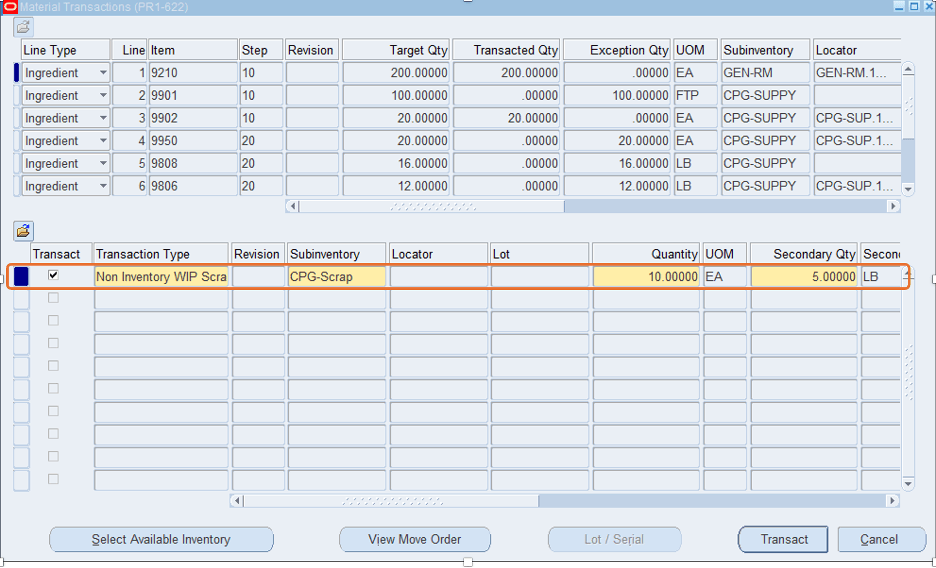

Tracking Scrap Without Predefined Inventory Items
Non-inventory scrap can be recorded directly against batch ingredients, products, or by-products. These transactions do not update inventory and are used for reporting purposes only. A reason code is mandatory, and any corrections must be made via the standard Material Transaction correction process.
For ingredients, scrap can be recorded, but the scrap quantity cannot exceed the transacted quantity Scrap returns can also be recorded but cannot exceed the original scrapped quantity. For products and by-products, scrap quantities can be recorded as needed, and scrap returns are allowed but cannot exceed the original scrapped quantity.
Example: An ingredient scrap is recorded for a batch.
Record Scrap without Pre-Defined Items
Record Scrap without a Predefined Item

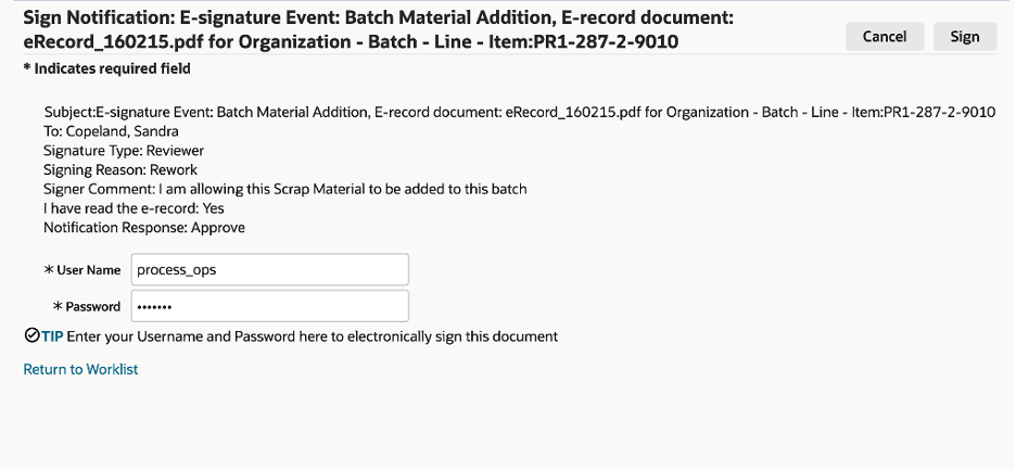

Electronic signatures are supported for both inventory and non-inventory scrap transactions, ensuring full compliance and traceability for audits. When enabled, the system prompts for an electronic signature at the time of recording scrap or scrap return.
Example: Users are adding material 9010 as a inventory scrap item to the batch
Sample Electronic Signature
