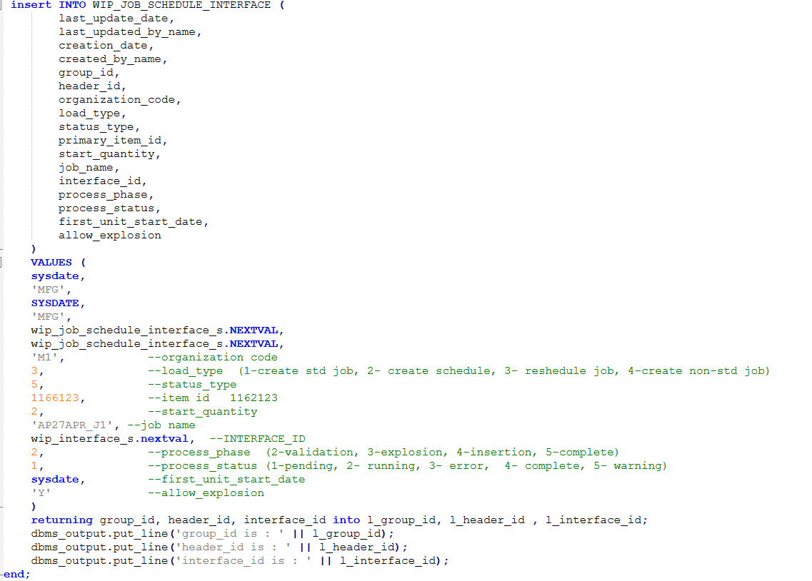

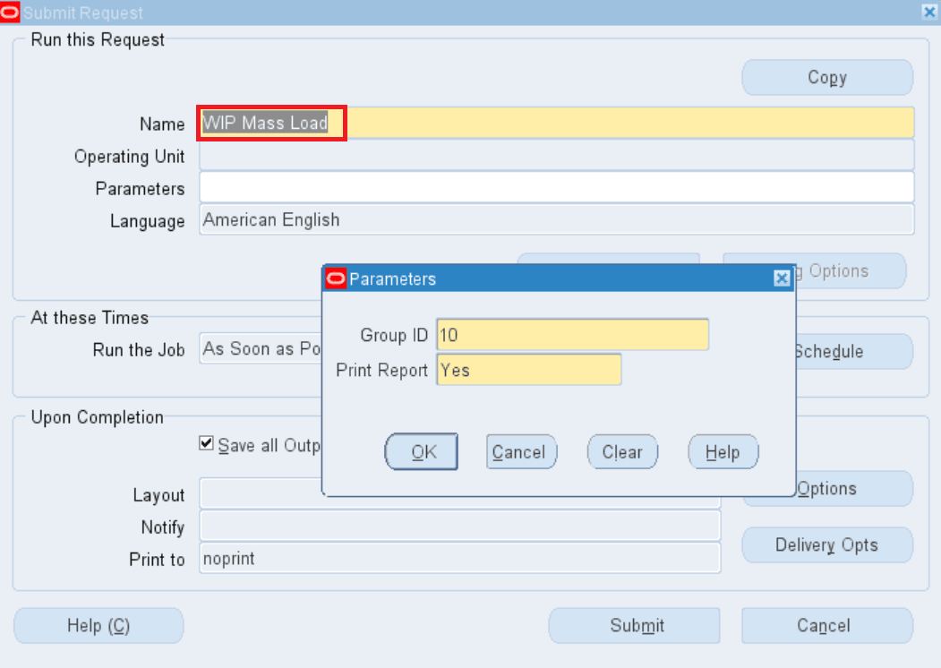

You can use the WIP Mass Load program to mass change work orders to the Complete- No Charges status. Instead of manually selecting Complete-No Charges for discrete jobs after changing the job status to Complete, you can run the WIP Mass Load program to update jobs from Complete to Complete-No Charges and from Complete-No Charges to Complete.

Insert data into WIP_JOB_SCHEDULE_INTERFACE Interface table
WIP Mass Load concurrent program
