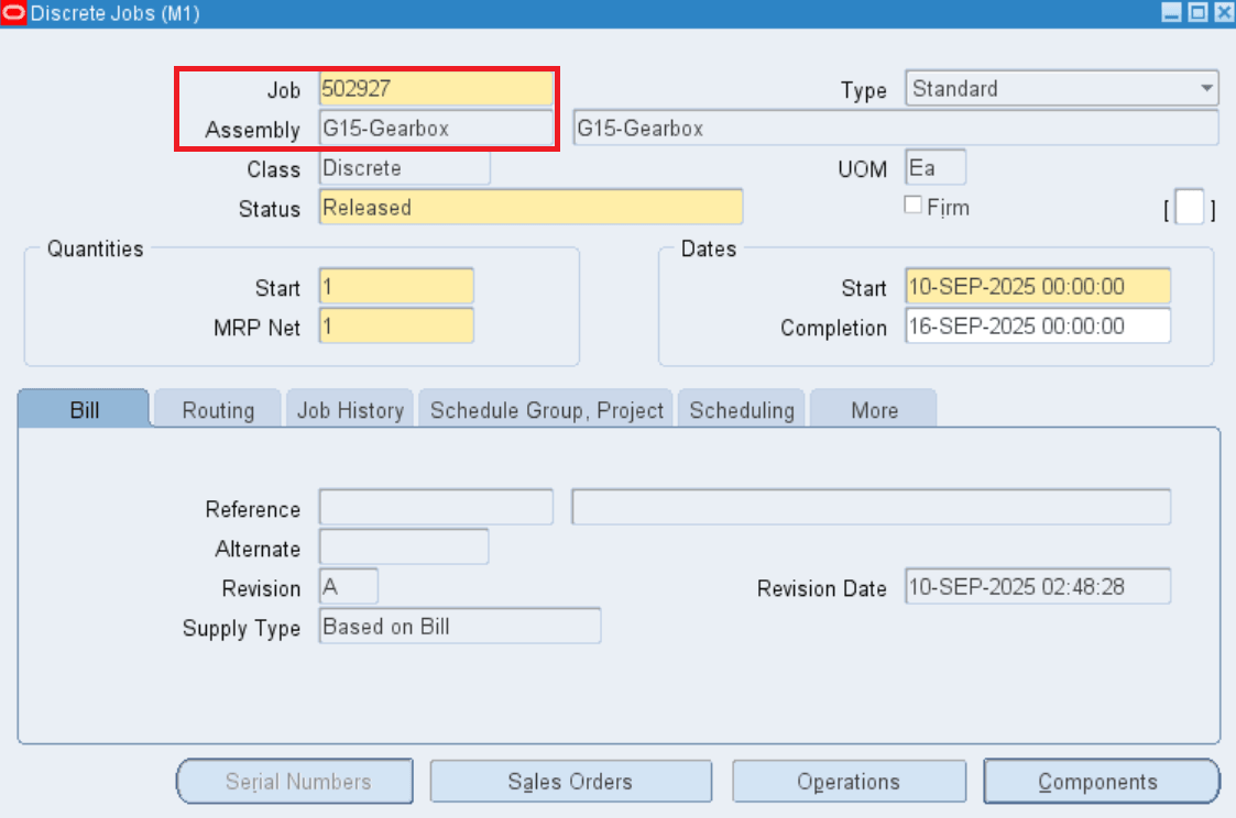

In the following example, a demand job is created for "G-15 Gearbox" assembly item. The component item is "Housing" subassembly.

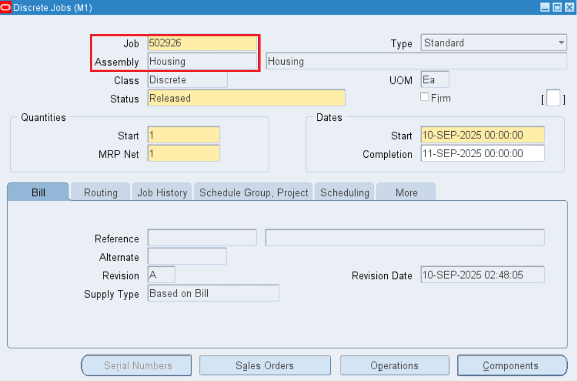

A supply job is created for the "Housing" subassembly item.
Discrete Job
Supply job

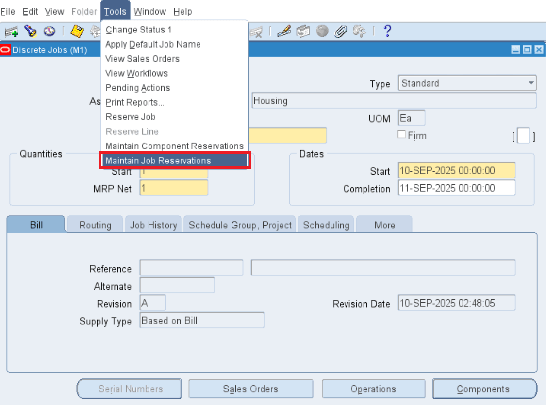

Click on the action link - Maintain Job Reservations

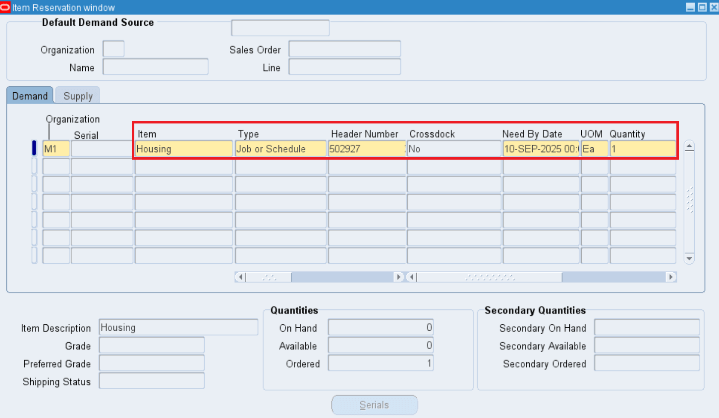

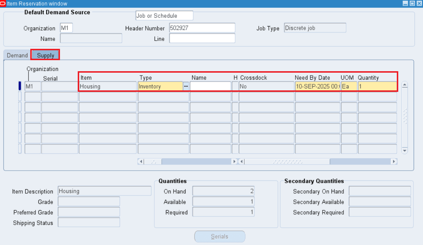

You can update the demand job details in the Item Reservations window.
Reserve the supply job with the demand job

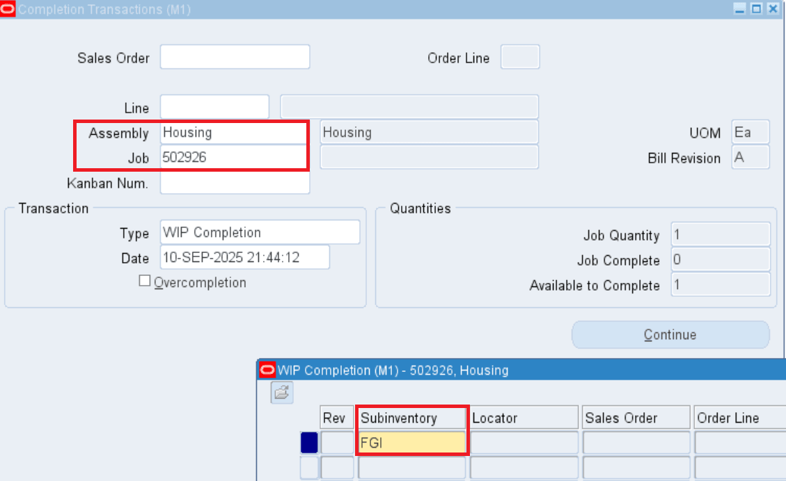

Complete the subassembly item
Complete the supply job
On completing the supply job to inventory, the supply job reservation is relieved. The reservation is updated in the demand job with Inventory as supply source.
To view the reservation details, navigate to the demand job and view the component item reservations.
Demand job
Demand job

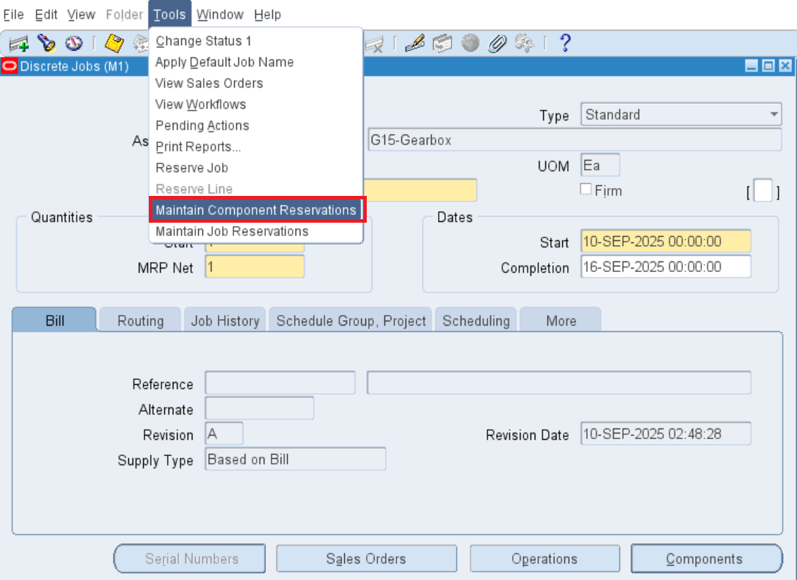

Click on the action link - Maintain Component Reservations
Component item reservations

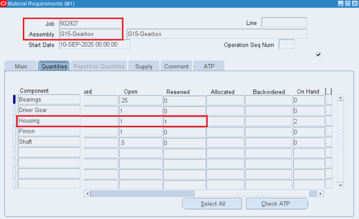

You can also see the reservation quantity for the "Housing" subassembly item in the Material Requirements window.
