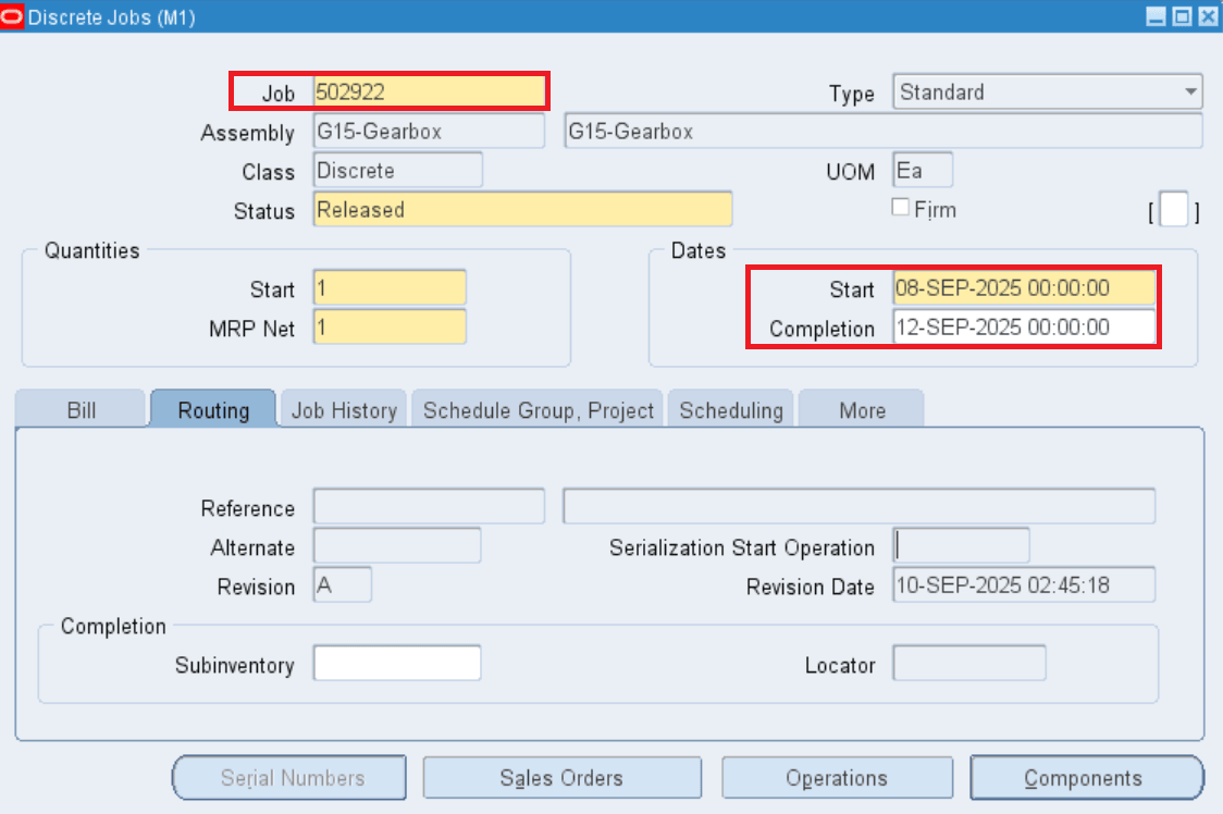

Discrete job
Discrete job

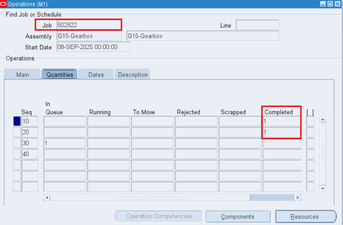

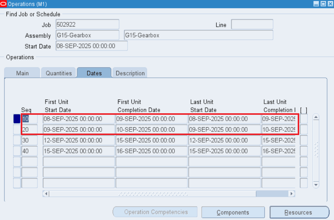

Job operations completed

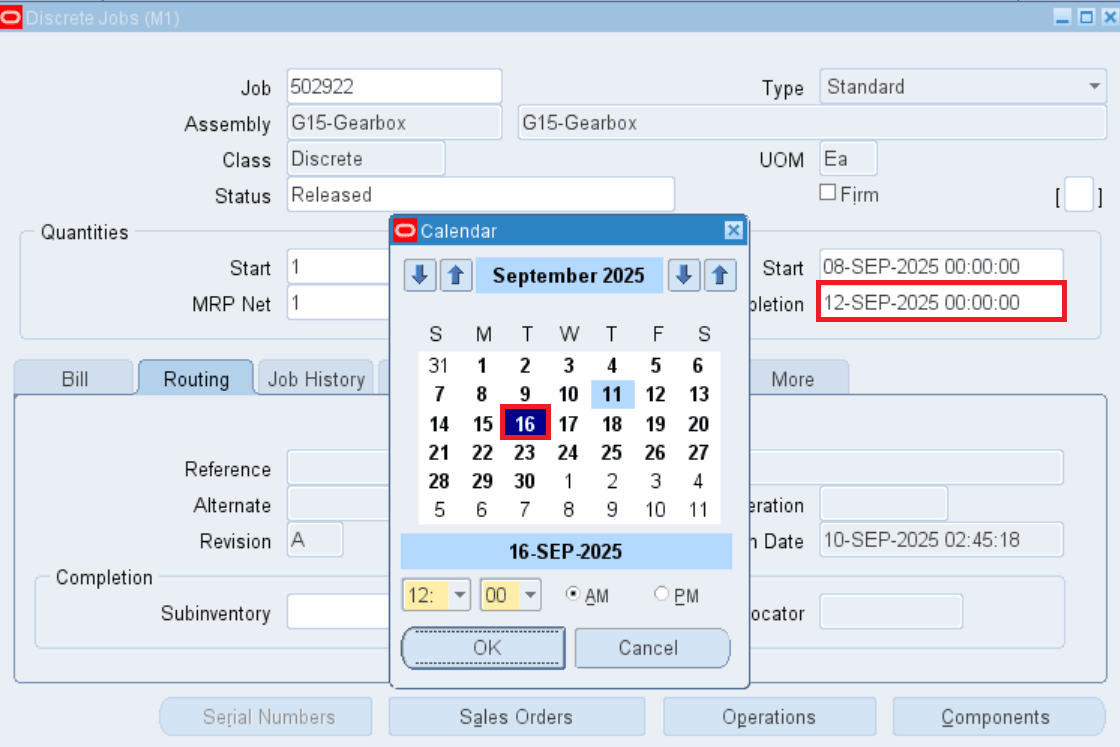

Backward scheduling with job completion date set as 16-SEP-2025
The Profile option "WIP: Ignore Completed Operations for Backward Scheduling" is set to Yes.
Completed operation schedule dates are not changed
Completed operation schedule dates remain unchanged
