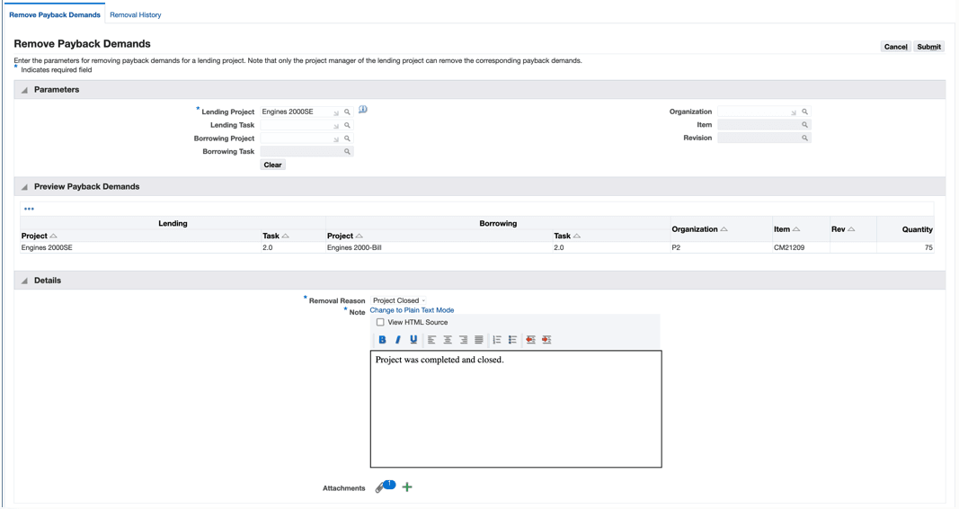

To remove payback demands:
  1. Navigate to the Remove Payback Demands page. From the Borrow, Payback Transfer menu, click Remove Payback Demand.
  2. Use the Remove Payback Demands page to search for and view all the payback demands for that closed lending project that you select. You can filter your search based on specific parameter combinations:
    • Lending Task
    • Borrowing Project
    • Borrowing Task
    • Organization
    • Item
    • Revision
  3. Select the payback demand you want to remove and in the Details region’s Removal Reason field, select the reason for removing the payback demand.
    Note: Currently, Project Closed is the only seeded value for the Removal Reason list of values. You can include additional values using the "Payback Demand Removal Reasons" lookup.
  4. Optionally, you can also add additional information related to the payback demand removal in the Note field or click Attachment to attach a file, URL, short or long text or a document catalog.
  5. Click Submit to confirm the payback demand removal.

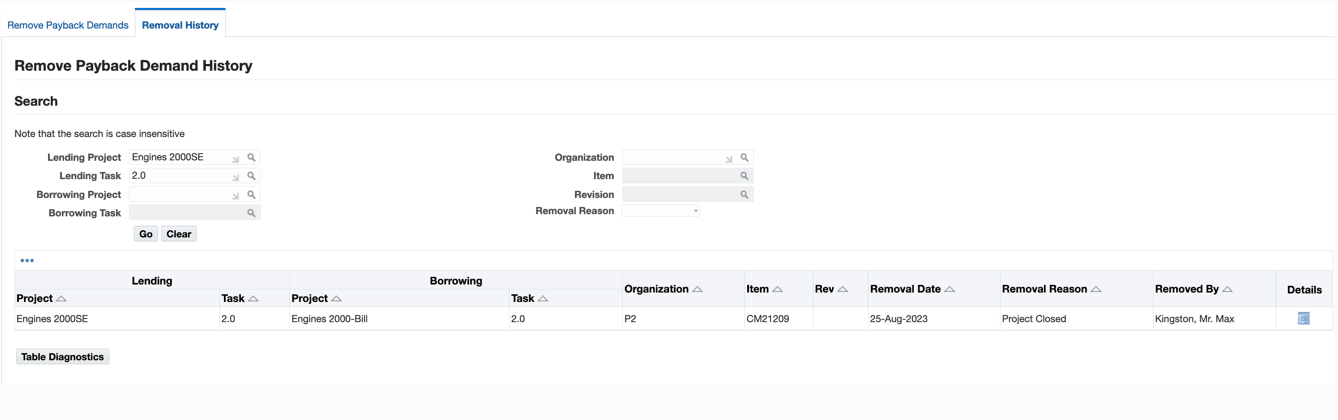

To view remove payback demands history:
  1. Navigate to the Remove Payback Demands page and click the Removal History tab to view remove payback demand history.
    Remove Payback demands
  2. On the Remove Payback Demand History page, click the Details icon to view details in the Remove Payback Demands Details page. You can also open the Remove Payback Demands Details page from the Project Borrow/Payback Details window.
