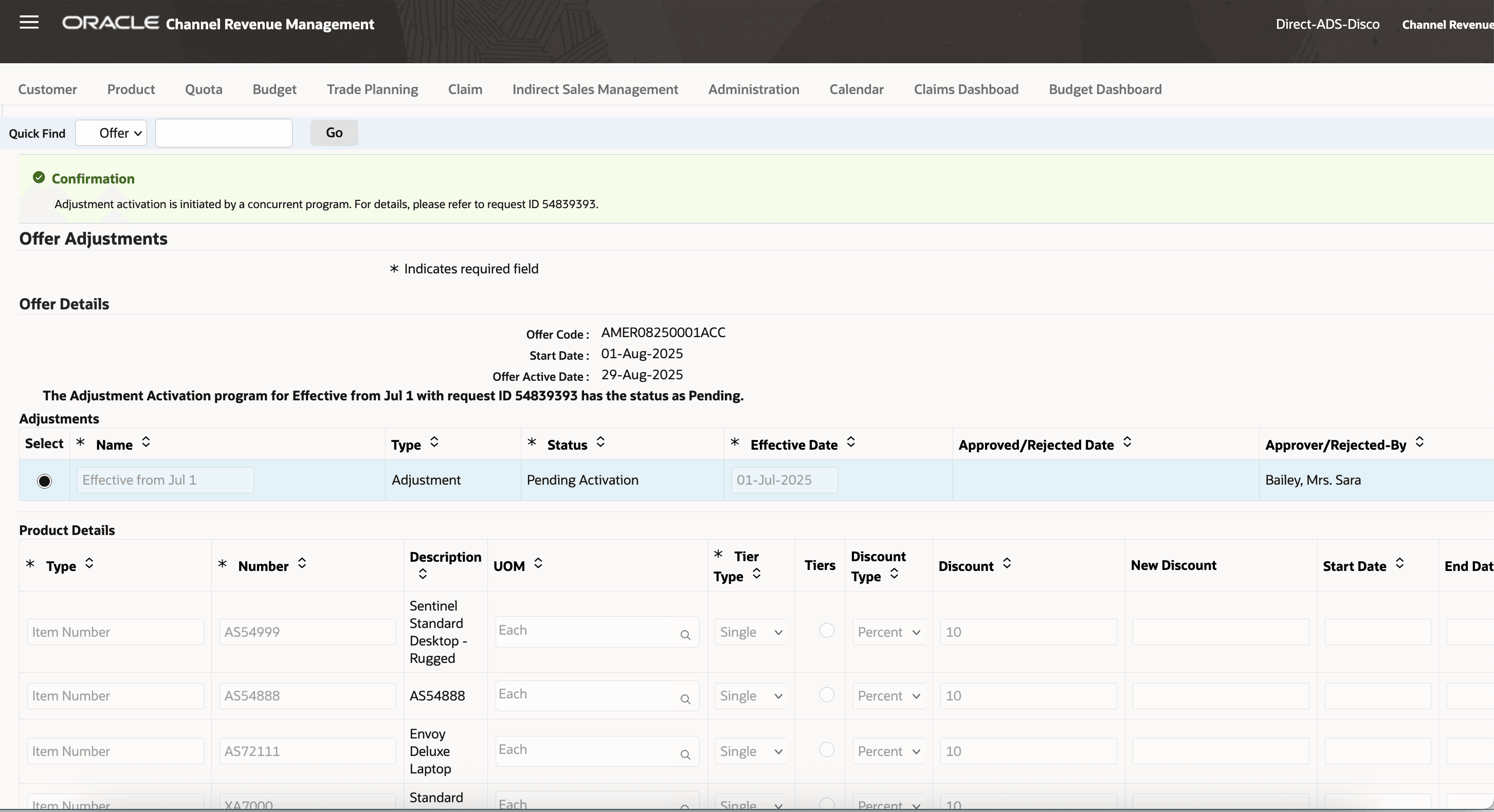

Asynchronous Adjustment Activation
Steps to enable and configure
To enable this feature, set the profile option OZF: Number of Lines for Asynchronous Adjustment Activation to a numeric value. This number represents the product lines in the offer adjustment and is used to determine whether the adjustment activation runs synchronously or asynchronously. You can set the profile at the Site or Operating Unit level.
Threshold for Asynchronous Adjustment Activation
