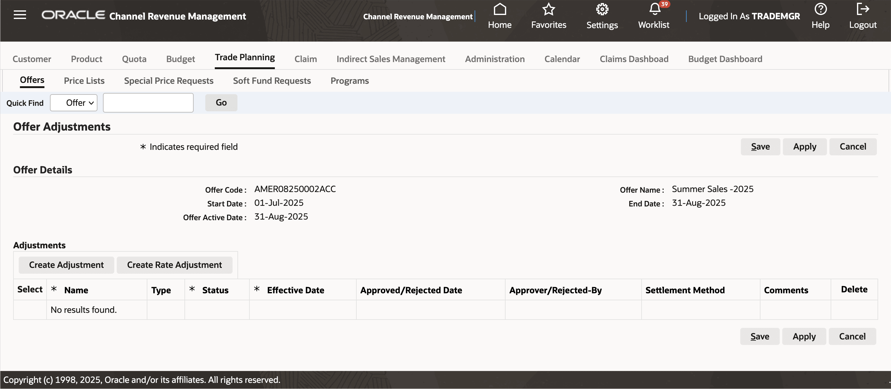

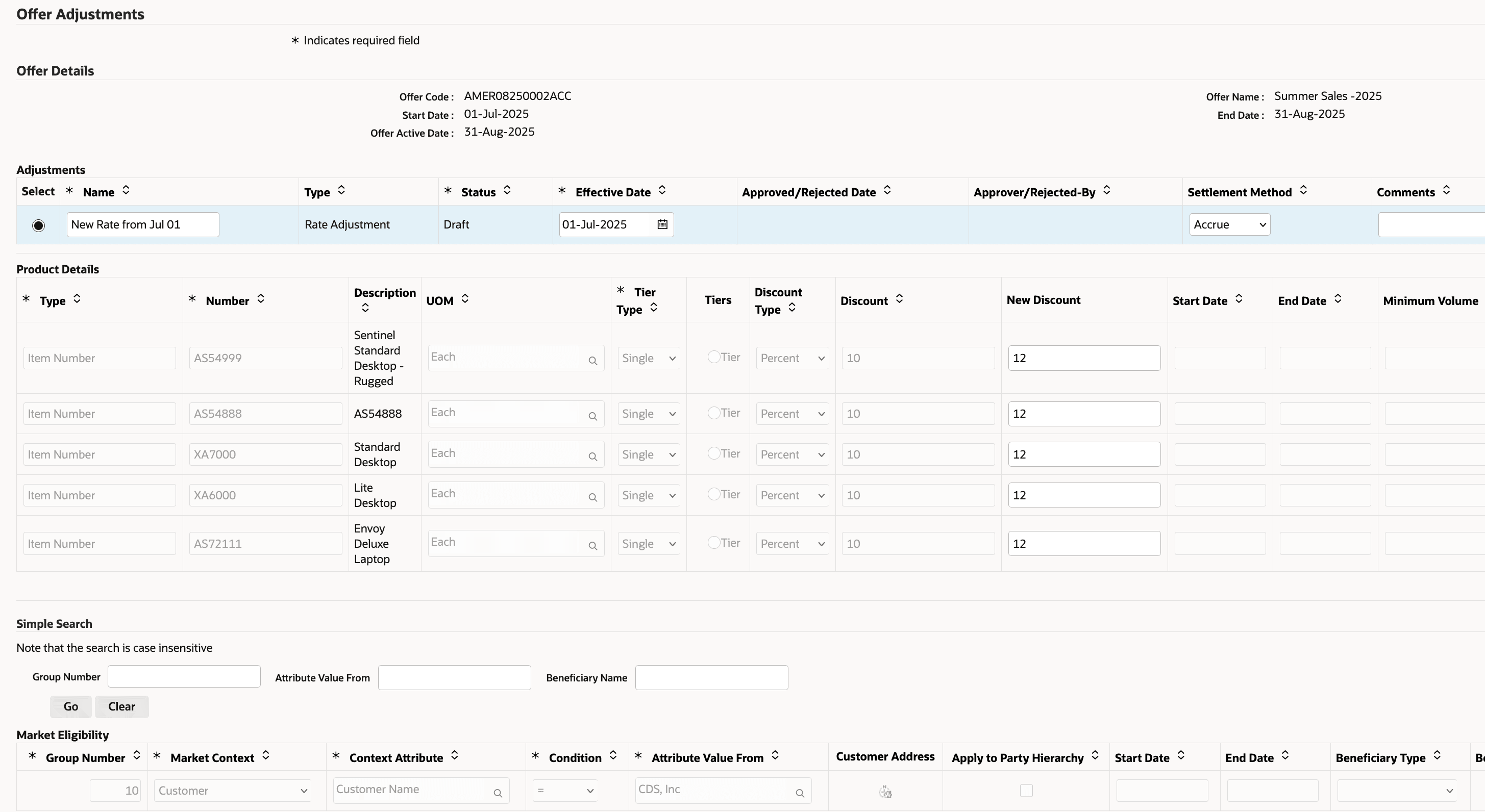

If you only want to adjust the rate of an offer, then click Create Rate Adjustment in the Adjustments region on the Offer Adjustments page.
Offer Adjustments

Offer Rate Adjustment

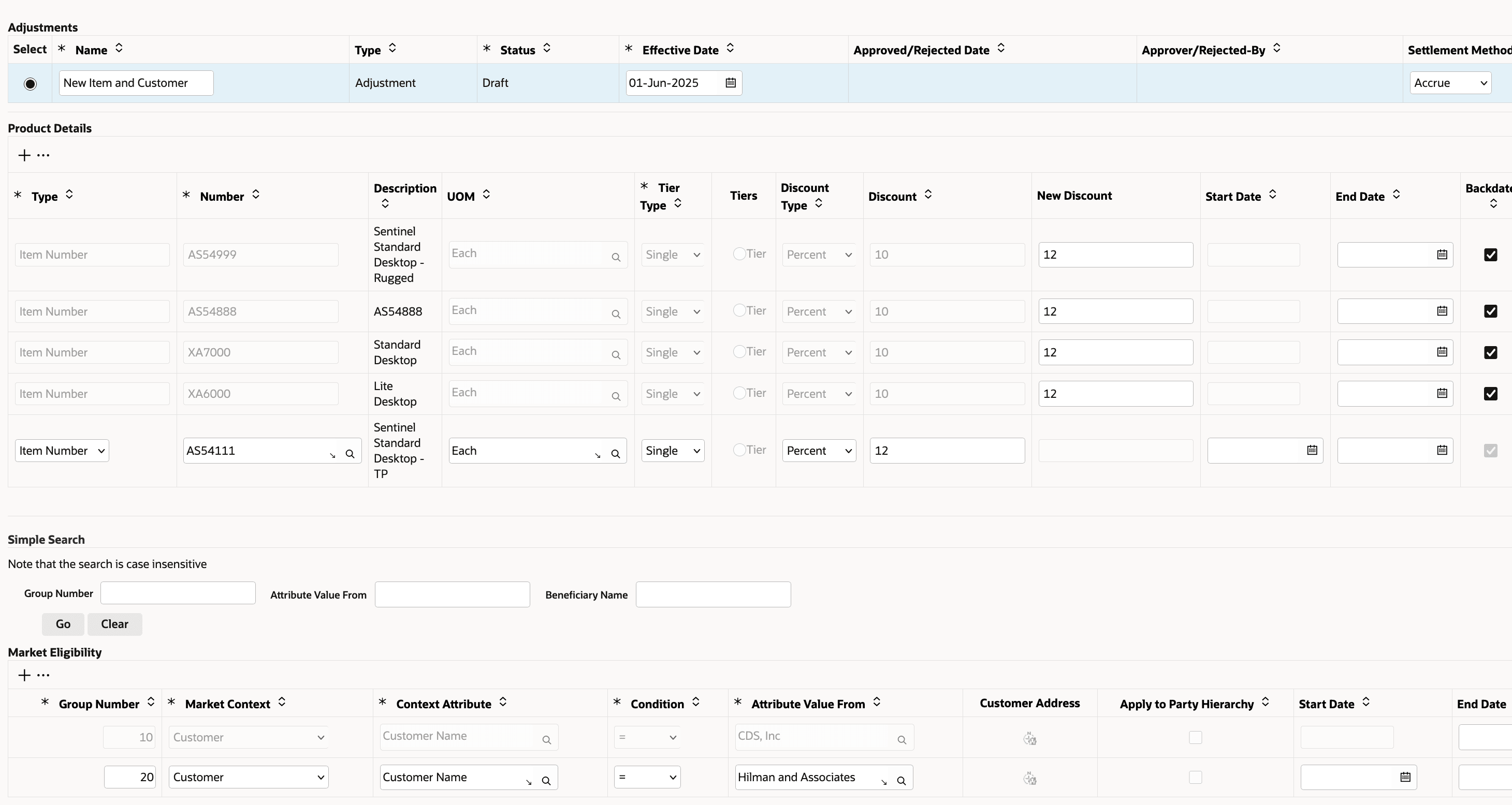

To add or end-date products or qualifiers, or to make a backdated adjustment to an offer, click Create Adjustment in the Adjustments region on the Offer Adjustments page.
Backdated Adjustment
