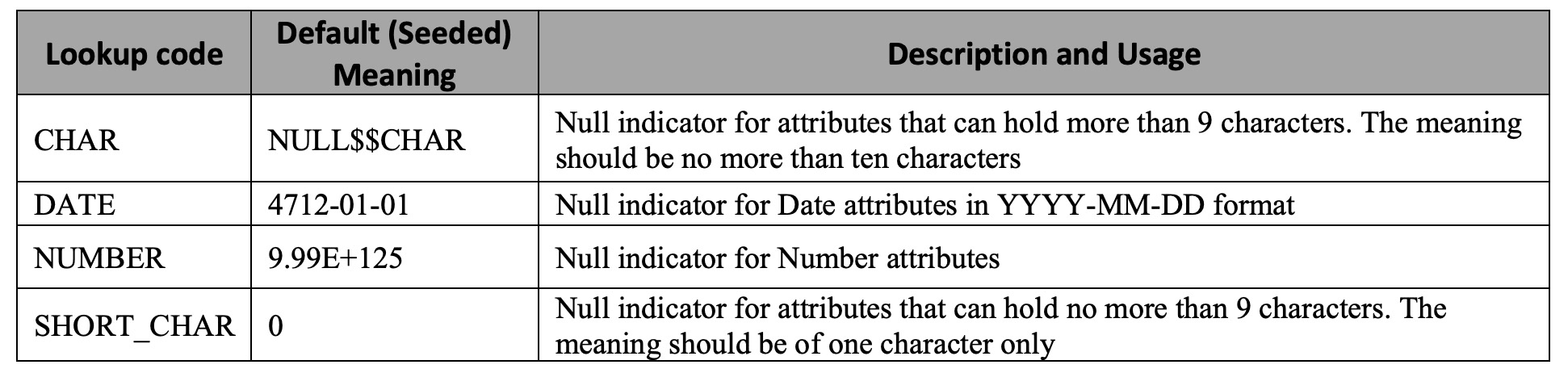

  1. Populate alternate values in the interface tables that will be treated as Null while creating or updating an order via Order Import. These alternate values to be passed by the user in the interface tables, by data type, are configured in a new system lookup Null Indicators for Attributes in Order Import. The meaning defined in this lookup for each data type lookup code is called Null Indicator for that data type. One lookup code is predefined for each data type as indicated in the following table:
Lookup Details of Null Indicator
  1. To create or update a sales order or its entities (like Order Lines, Price Adjustments, Payments, Billing Plans, Sales Credits, and RMA Lot Serials) through Order Import with Null values, you populate:
  • IMPORT_NULL_VALUES as ‘Y’ for the corresponding record in table OE_HEADERS_IFACE_ALL.
  • The Null indicator values mentioned as Meanings of lookup codes - CHAR, SHORT_CHAR, DATE, and NUMBER in the interface tables based on the data type and allowed data length of the attribute.
You can change the default Null indicators for each data type defined as Meanings of lookup codes in the system lookup based on your requirement.
