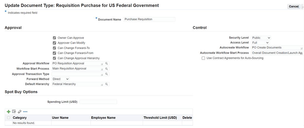

In the Purchase Requisition document type page, click the Approver Can Modify option to support editing of IGT requisitions by approvers as shown in the following diagram:
Check 'Approver Can Modify' Check box in Purchase Requisition Document Type

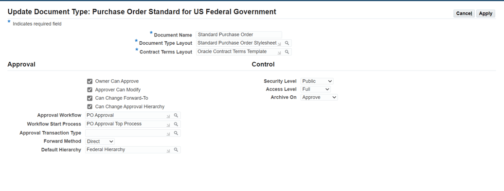

In the Standard Purchase Order document type page, click the Approver Can Modify option to support approvers to modify IGT orders or IGT order modifications as shown in the following diagram:
Check 'Approver Can Modify' checkbox in Purchase Order Document Type
