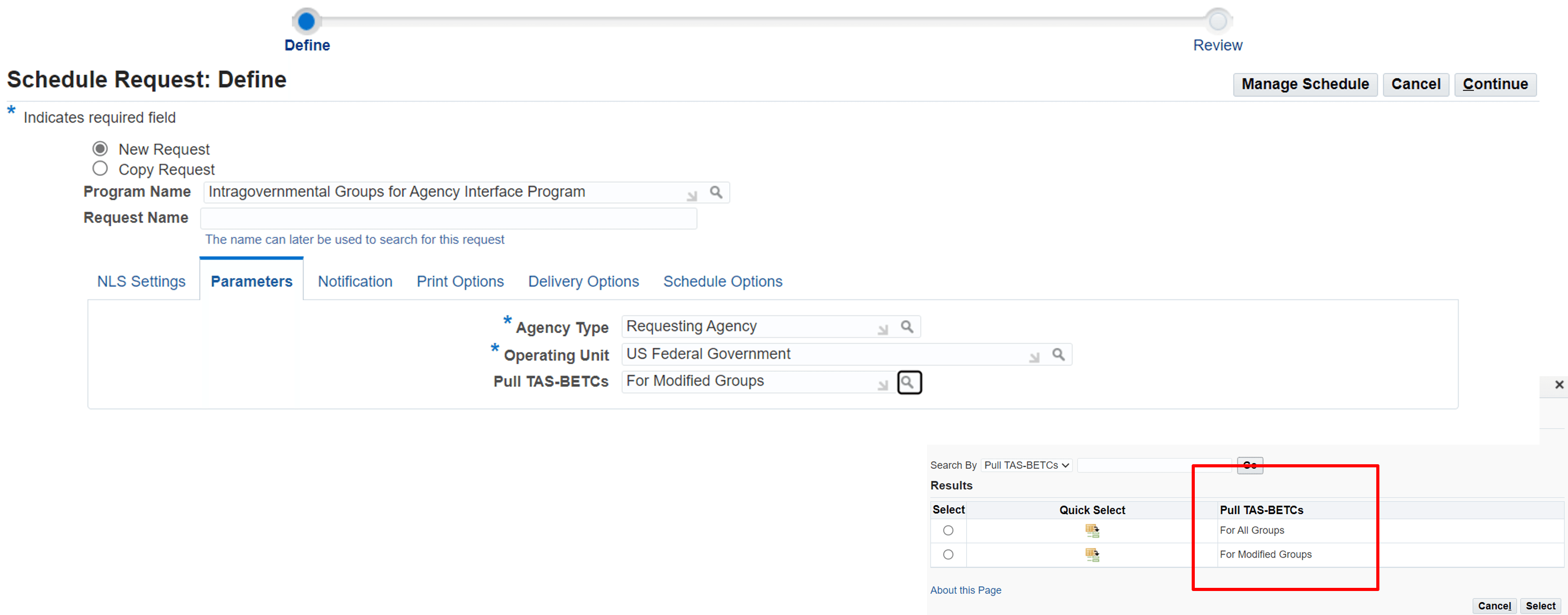

A new parameter Pull TAS-BETCs is added to the Intragovernmental Groups for Agency Interface concurrent program that allows an agency to pull TAS and BETC for either all groups or only updated groups. If the agency selects to pull TAS and BETCs for a Modified Groups, then the TAS and BETC data are synchronized from the last run date of the Intragovernmental Groups for Agency Interface concurrent program.
The following diagram shows the new option to pull TAS and BTECs for the modified group:
Intragovernmental Groups for Agency Interface Program
