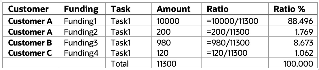

The participation ratio is calculated based on the funding amount. The following example illustrates the calculation.
Fig.1 - Participation ratio calculation

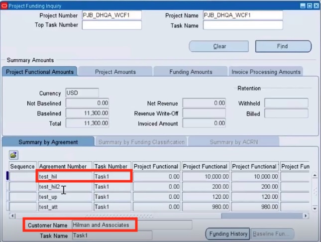

  1. Fund the project at top task with customers who are availing the the service. The top task in this case represents a shared service.
    Fig.1 - Funding at top task
    Fig. 2 - Funding at top task

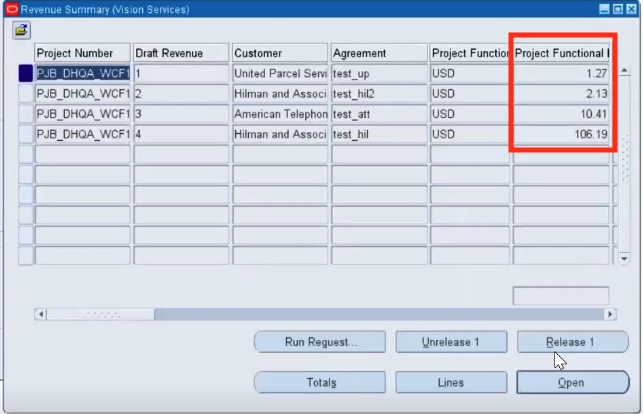

  3. Generate revenue for the project. The seeded client extension is invoked to calculate the participation ratio for each funding agreement. The ratio is then applied to the total revenue amount to derive revenue for each agreement.
    Fig.3 - Revenue generation
    Fig. 3 - Revenue Summary

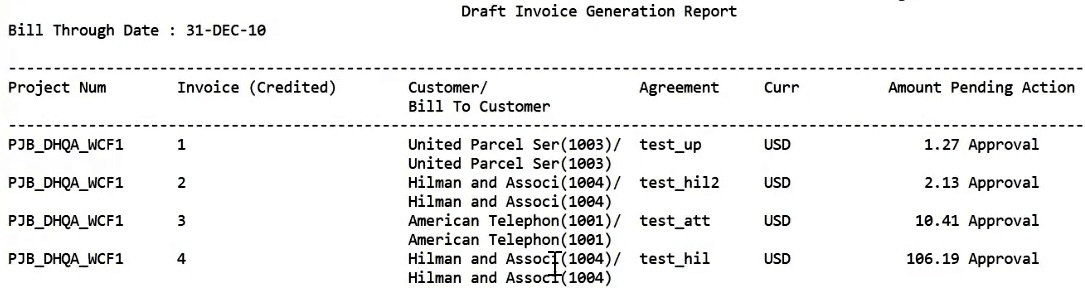

  4. Generate draft invoice for the project. The seeded client extension is invoked to calculate the participation ratio for each funding agreement. The ratio is then applied to the total invoice amount to derive the invoice amount for each agreement.
    Fig.4 - Invoice
    Fig. 4 - Invoice generation report

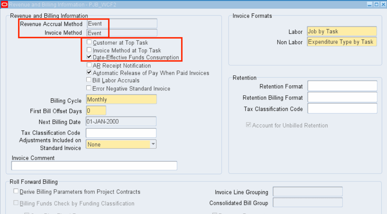

  2. Ensure that the following options are set in the Billing Setups window:
    a. Revenue Accrual Method is Event
    b. Invoice Method is Event
    c. Customer at Top Task is disabled
    d. Invoice Method at Top Task is disabled
    Fig. 1 - Billing Setups window
    Fig. 1 - Project Billing Setups window (Forms UI)

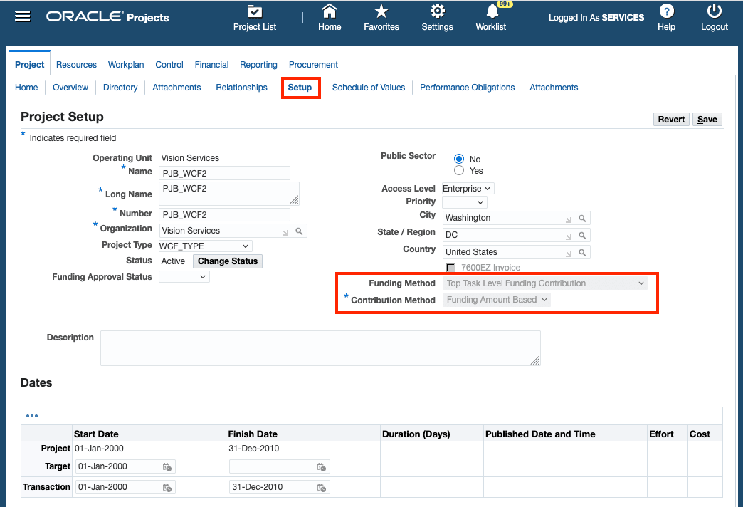

  3. Set the following options in the Project Setup window:
    a. Funding Method to Top Task Level Funding Contribution
    b. Contribution Method to Funding Amount Based
    Fig. 2 - setup
    Fig. 2 - Project Setup window (HTML UI)

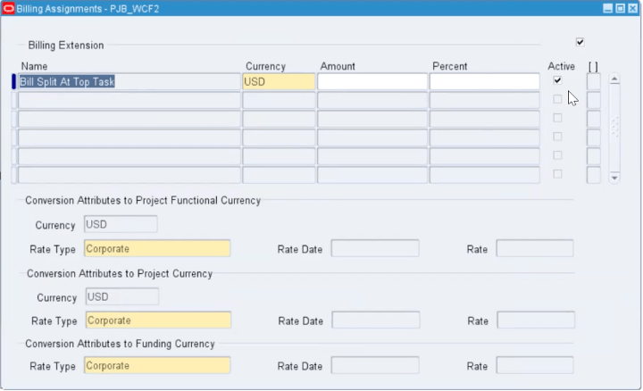

  5. The seeded extension Bill Split at Top Task is assigned automatically once the project is eligible for shared services. This completes the required setups.
    Fig. 3 - Seeded extension
