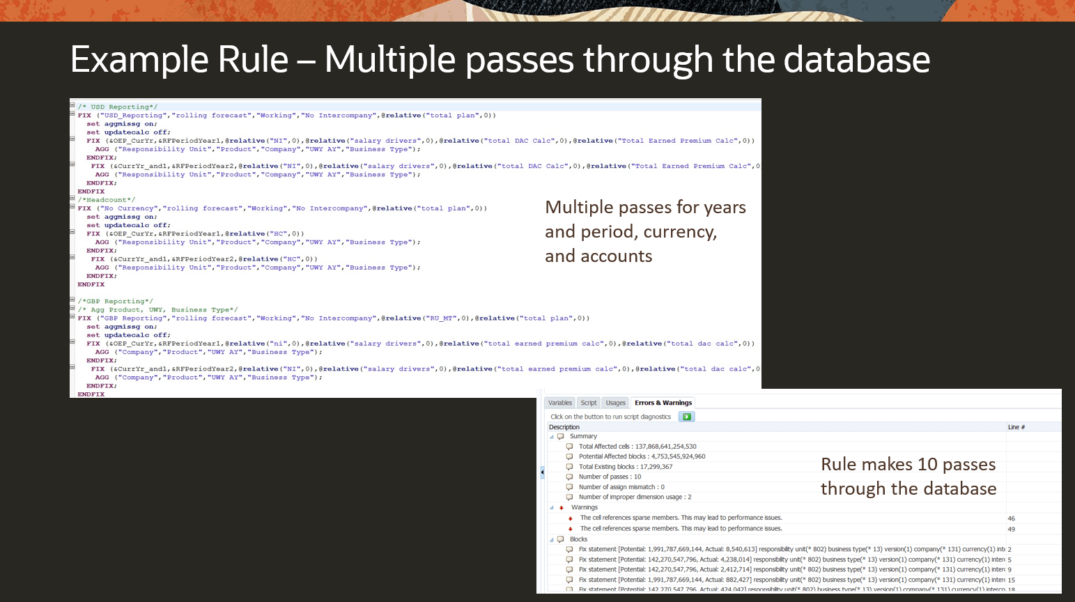

Example 1: Rule that Makes Multiple Passes Through the Database
The following rule makes 10 passes through the database for years and period, currency, and accounts.
Example Rule – Multiple passes through the database
Example 2: Rule that Makes Only One Pass through the Database
The following rule makes just one pass through the database. This is a major reduction in the total affected cells.
Revised rule – Single pass through the database
