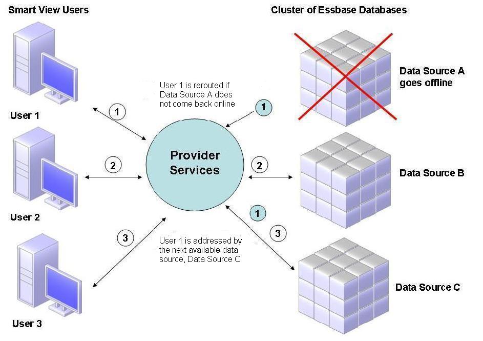

In Figure 2-1, Smart View users connect to Essbase through Provider Services.
Each user connection is assigned to a server during the Essbase session. Provider Services uses session-level load balancing. For example, in Figure 2-1, User 1’s connection is mapped to Data Source A. User 2’s connection is mapped to Data Source B. User 3’s connection is mapped to data source C. All requests from User 1 are handled by Data Source A for the duration of the connection.
If data source A fails:
  • User 1 times out at Data Source A.
  • User 1 is rerouted to the next available data source, which is Data Source C in Figure 2-2.
Figure 2-2 illustrates what happens when Data Source A goes offline.
Figure 2-2 Database Cluster with One Data Source Offline
The image shows an active-active Essbase database cluster with one database offline.
In Figure 2-2, the state of query 1 is maintained at the middle tier and rerouted. Provider Services also provides load balancing across servers.
