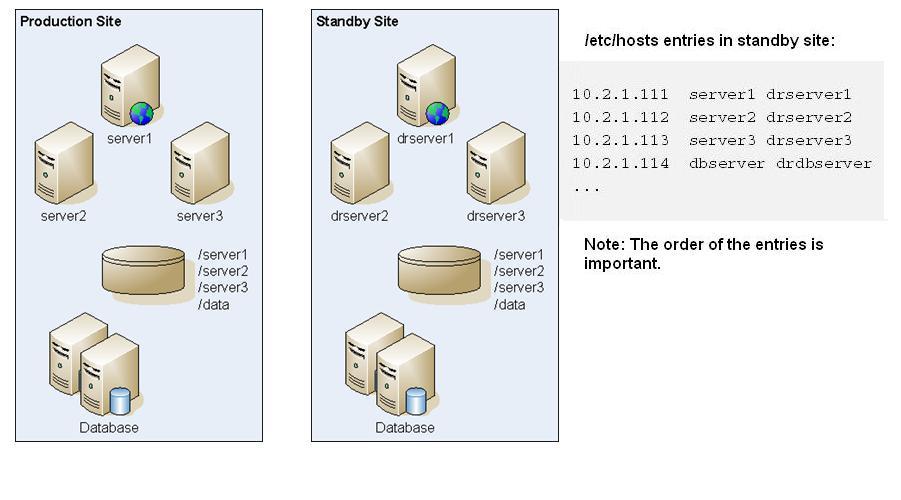

If the host names must differ between the production and standby sites and there is no separate DNS for the standby site, set up an alias for the production site servers in the standby site as shown below, so that the main server is the first entry in the alias.
Figure 9-2 Host Name Alias Setup
